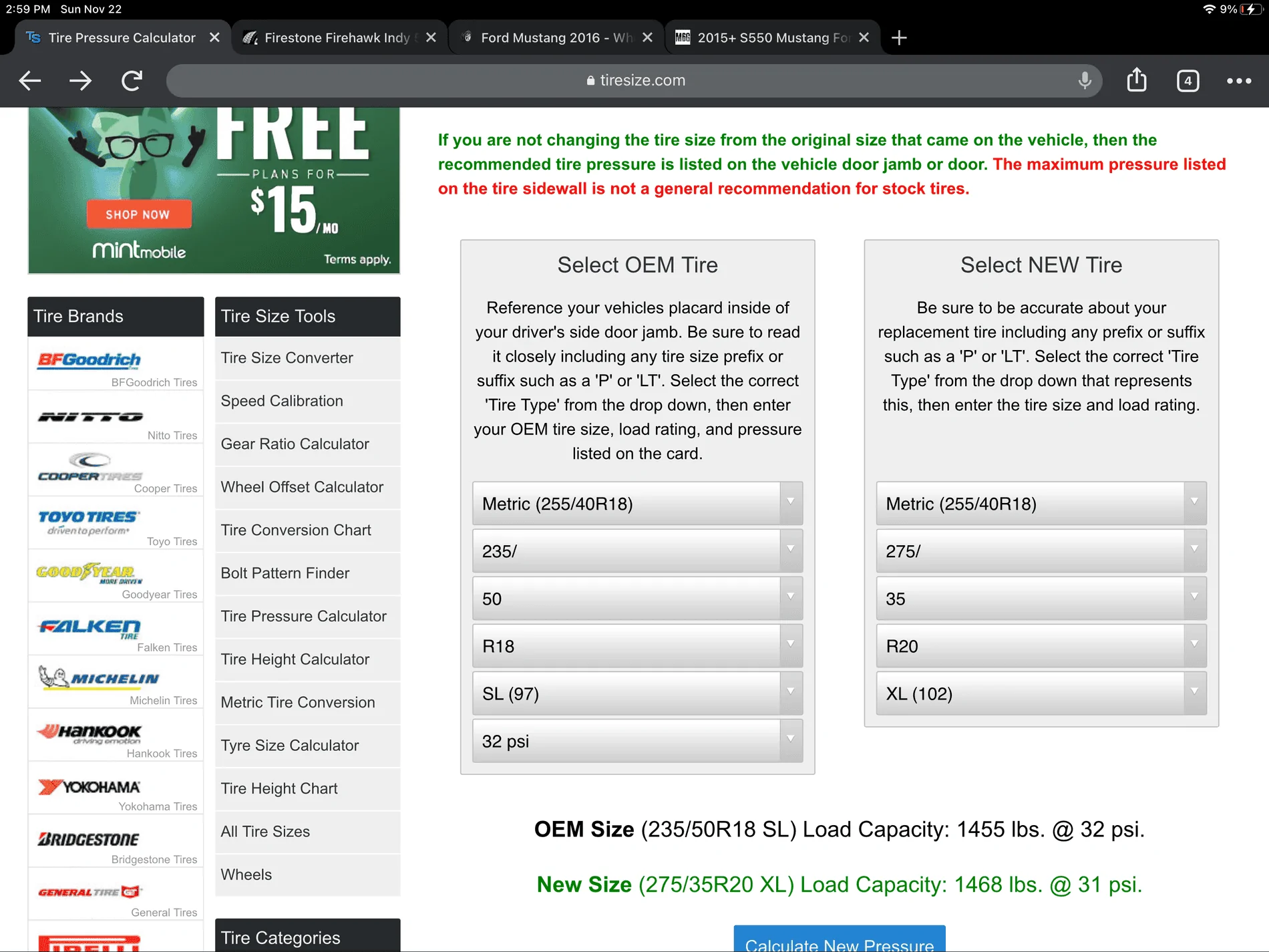

According to tiresize.com it seems you have to compare oem tire size, load rating, and psi from on the door jam, with the new tire size and load rating. The tool on their site spits out the calculated psi you should be running to come as close as possible to supporting the vehicle's weight load. I punched in the oem numbers for the 19s @ 32psi:
OEM Size (255/40R19 XL) Load Capacity: 1418 lbs. @ 32 psi.
New Size (275/35R20 XL) Load Capacity: 1431 lbs. @ 30 psi.

Punched in on tiresize.com here are the scientifically correct psi's to run:
Front OEM Size (255/40R19 XL) Load Capacity: 1418 lbs. @ 32 psi. New Size (275/35R20 XL) Load Capacity: 1431 lbs. @ 30 psi.
Rear OEM Size (275/40R19 SL) Load Capacity: 1647 lbs. @ 32 psi. New Size (305/35R20 SL) Load Capacity: 1660 lbs. @ 29 psi.
My setup is Nitto 555 G2's sizes:
F 275/30/20
R 285/30/20
I bought the car this way and only recently dawned on me that these tires may take a different psi than the oem sizes. I punched my numbers in and got
F psi - 36
R psi - 41
Those numbers seemed too high to me so I filled F32/R34, looks good, feels good, only more miles will tell me the tread's wear pattern, and if this tiresize calculator is real-world-helpful.
Meantime hope this tiresize.com tool is helpful, cheers

I saw the forum and became curious as well. I started looking around and found this tire pressure calculator online. The idea is the same but the results make more sense than the chart in the first page. My stock setup was 235/50R18 (97w). Now I’m running 275/35/20(102w) squared as you can see the recommended air pressure is 31 psi. As it states in the calculator you’d need to accurately pick the specs of your tires.
