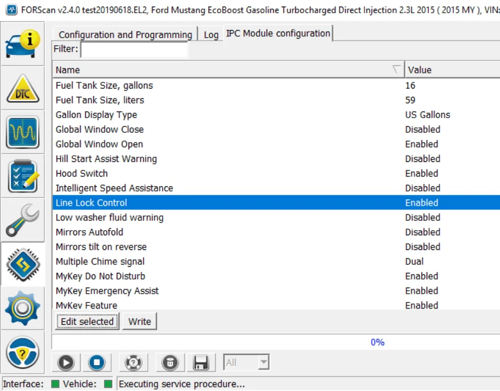

I hooked up FORScan 2.4 during the last weekend and checked all the drop-down options. While version 2.4 has more drop-down options than the previous versions, I checked all the modules and didn't see anything for the launch control. Options are listed in alphabetical order so it should've shown up above the "Line Lock Control" in the IPC config. This doesn't rule out enablement via modifying the AS BUILT value but a quick search of the forum turned up some discussions but no values.

I think I figured out the asbuilt data to enable it, I won't post until I can confirm. I'm worried that because the firmware posted here was for an AT car, it may not accept the asbuilt data for LC, and if it does it may not work.

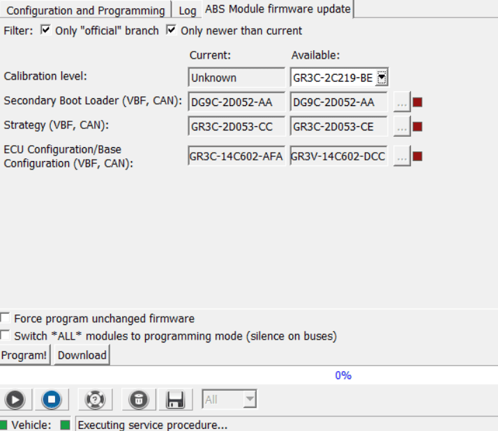

Can you check your original firmware to see if it's same as mine?

1) The SBL file DG9C-2D052-AA is always the same (OK).
2) The Software strategy should ideally not be changed (else you may unknowingly be changing the functionality of your ABS software)
- Bull Run you have changed from GR3C-2D053-CC to FR3C-2D053-CE. Probably OK, but I wouldn't want to be in your car in an accident where you rely on the ABS :fingerscrossed: I would suggest you use GR3C-2D053-CE (the updated version of your stock software).
3) I was referring to the config/cal file. Every config/cal version will prevent you from using certain combinations of AsBuilt values. Obviously the goal is to use the same AsBuilt as stock, except for the I4/V8 switch, if you achieve that, it's all good, but there are certainly limitations for RHD cars:
- Flashing FR3C-14C602-CEC (as per Thestangb, Partizan, Chipa777, Bull Run, will not allow you to select RHD AsBuilt (as I found out with Thestangb using his original method)
- Any RHD cal that is not man/auto or coupe/convertible will also not allow you to select the correct variants.
*Edit: Bull Run, you have also not put your original AsBuilt back in - your ABS config now thinks you are manual (not auto) and that you have different foundation brakes from what's actually fitted... I suggest you fix this.
Maybe it's easier for all the LHD cars, and perhaps you can get around this using the 'wrong' software strategy in 2) above, but I wouldn't advise it.

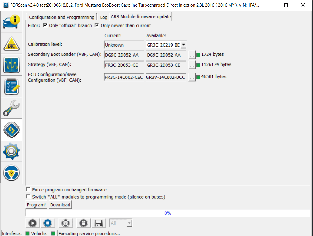

I have a 2016 EcoBoost Premium, Coupe, 6spd manual w/ Performance Pack, USDM, Left Hand Drive.
I have also purchased the ELS27 usb adapter mentioned a few pages back in this thread.
This is where the firmware update page first landed:
I then attempted to load this:
Strategy GR3C-2D053-CE
Configuration FR3C-14C602-CEC
After flashing completed, the log noted it could not read the firmware version of the Strategy or of the Configuration, so it chose to display default values for my ABS module assembly. It also noted there was no DTC service for the ABS module. I then tried to open up the As-Built config for the ABS module, but it kept aborting after I acknowledged the warning.
Thinking it was a fluke, I attempted to write the same firmware files again, after re-downloading them. Another hour later, and no different result.
For the third attempt, I followed the instructions as laid out by Partizan and Bull Run, this time loading the FR3C-2D053-CE Strategy.
No more errors about being unable to read the firmware versions, and I can once again access the AS-BUILT configuration! I used the 760-02 values appropriate for my car (no adaptive cruise, no collision avoidance). Line 760-01 still matched my VIN and was not re-written. Line 760-03 was already set to "55C0" and was not re-written. After writing Line 760-02, and finishing the IPC adjustment, everything appears to be functional. I can enter the line lock menu item, and it shows the "Hold OK to initialize" message. Haven't gone through with using the feature just yet, waiting until I'm back on my daily tires. 305/30/19 RE-71R's aren't exactly cheap...
I took it out for a drive, made sure the ABS function still worked, and it doesn't seem to have screwed up the brake bias at all, if that would happen to be possible.
I have an autocross event the day after tomorrow, so I'll definitely know then if anything is out of the ordinary.
