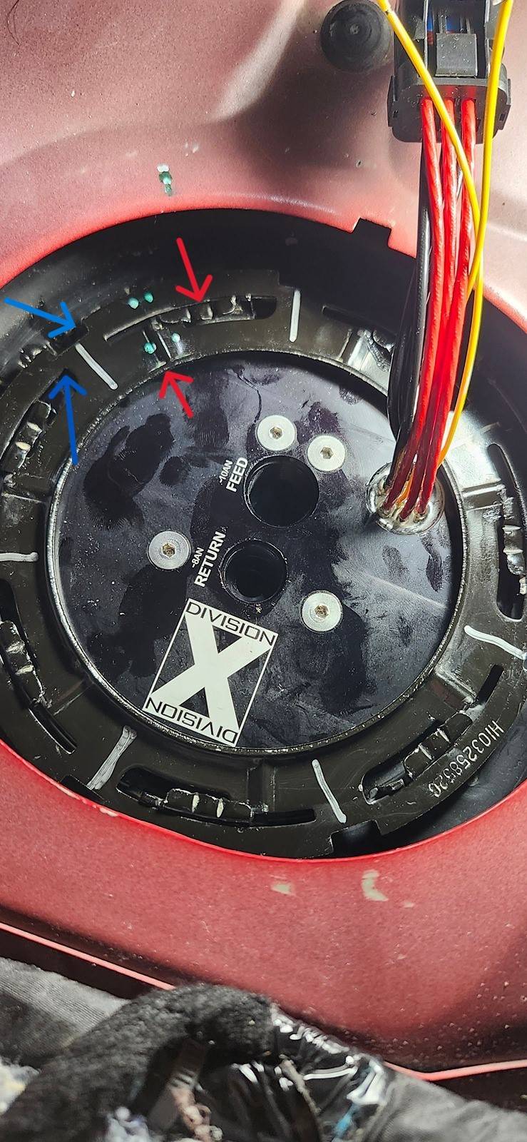

Stupid question here fellas...but uh...how much force should it take to put this lock ring on? Or am I an idiot and overlooking something? (No sleep lately so entirely possible 👍)
I am riding the struggle bus. I feel like I'm going to break something if I put any more force on the tool.
I tried a new o ring, old o ring, and petroleum jelly. I can start the lock ring by hand and everything lines up. But using the special lock ring tool and gently pushing down while using a breaker bar, it simply won't budge any further.
Indexing tab on the hat is pointed at 11 o'clock toward the "location" imprint that Ford designated. The assembly sits flush with no gaps or movement as far as I can tell. O ring isn't twisted.
Ignore the marks I put on the lock ring. The only thing that stands out to me is the scratch on the hat shown in Pic 2 at o'clock

To put the amount of force I'm using I to perspective, it feels about like tightening a lug nut.
Seems like I'm tempting fate here to put any more force on it.

Seems silly I know, but the new fuel hat should be seated pretty much flush against the tank (prior to ring install). Are you sure nothing is obstructing the hat from seating on the tank? I can absolutely not remember apply lug nut force to my locking ring lol.

ORing is laying flat on tank and pump assy is laying flat as shown in pics.
Either I need to risk it and give it more oomph or I need to pull the assembly and measure it to see if it's in spec, I think. (10:1 odds the issue isn't the assembly)

You called it.
I removed the new pump assy and installed the old one just to verify the ring would fit and that I wasn't a complete idiot. Sure enough, it clocked right into place without much persuasion.
So, I re-installed the new pump assy again and I notched a 'V' into the end of a flathead to prevent it slipping off the ring and hammered the ring onto the new pump. And then hammered harder... and harder.
And then finally, a 5lb hammer and some Very uncomfortable and very hard raps popped the ring into place.
I have never seen a ring fit that tight before in my life. Should have just used a damn air hammer. Lol
