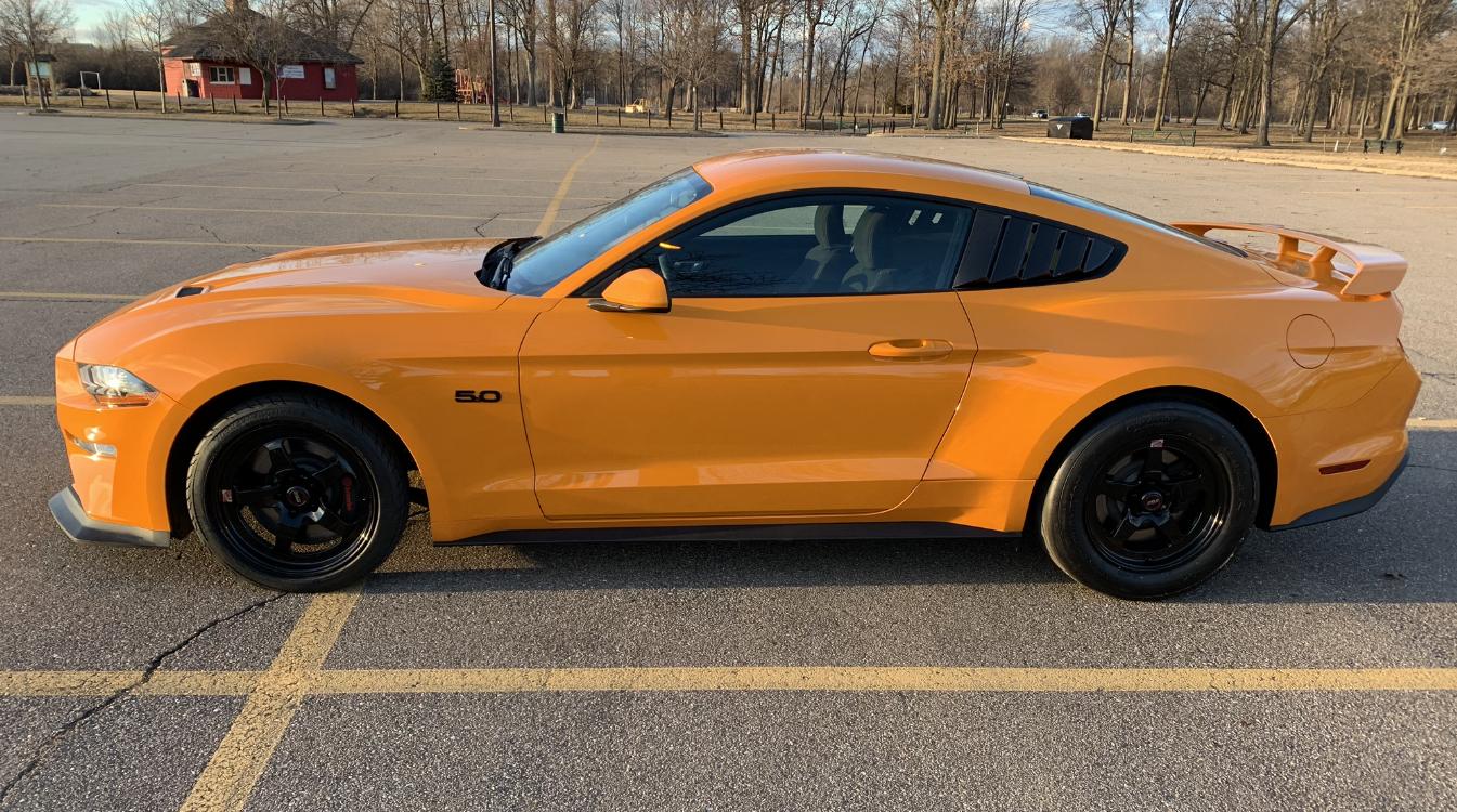

Weld Wheels! Yes, they are pricey but worth every penny. They are very light. I had mine powder coated all black. Weld sent me new hologram decals after the powder coating.
