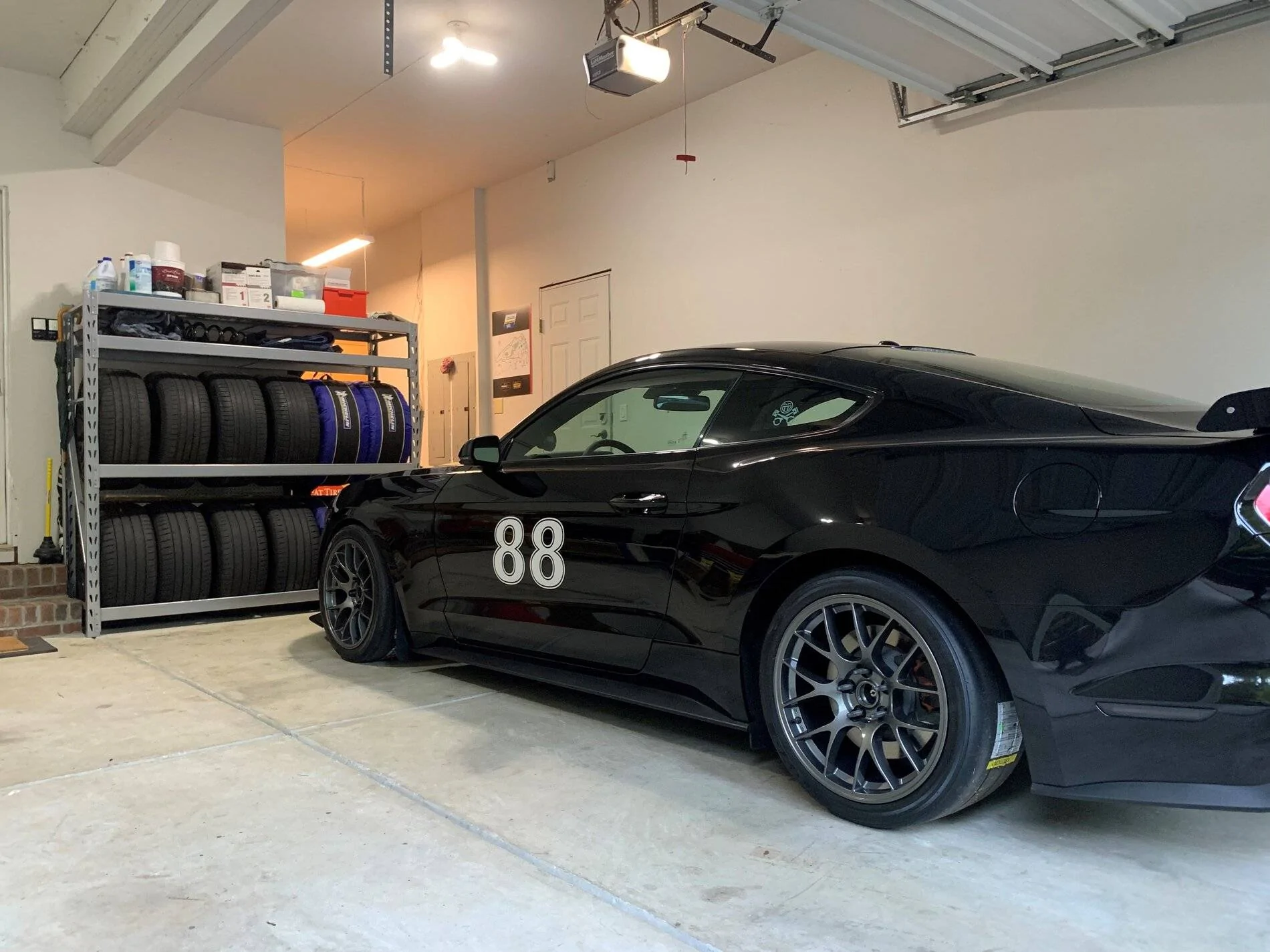

Apex EC-7 Wheels finally arrived, I managed to get some Toyo RR's, fitted and ready to check all alignment and set-up.
Running 18x11 with 295 squared tires.
Can you ever have too many tires..?
As @NoVaGT can attest 2 sets on a rack is nothing!! I have 20 tires up on racks and another 30 sitting on the floor in addition to an easy 50 motorcycle tires 120/160. I need to open a damn store! (PS4s, Cup2, PSS, Corsa, pirelli and Mich slicks)
Hopefully the answer is no, because I've got 4 sets in the spare bedroom, 3 sets in the garage. The bedroom tires are nice because it keeps guests from getting too comfortable and wanting to stay longer, as chances are I'll get another set and ask them to move their belongings so I can drop another set in there.
