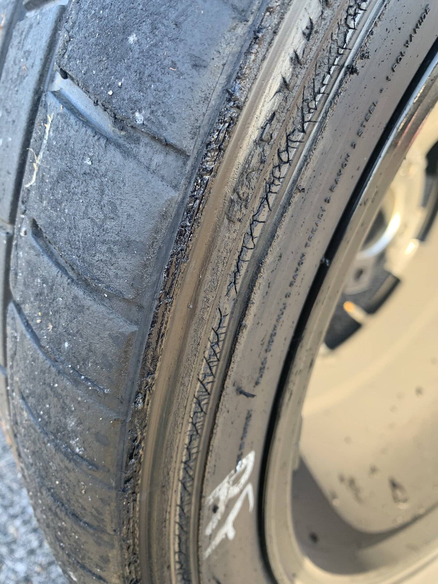

Making a full tire front, to rear swap this morning, I see that the inner of the right front has been rubbing the coilover spring. Creating a deep grove in my Pirelli Trofeo R Comps.
The tire is now toast and I was lucky to catch it - currently running SVE R350 19x10 with 285 tires.

What is your PSI and offset? 40? How much room between tire and spring at rest? Do Trofeo's bulge significantly when under braking/cornering forces? Looks like you need at least 5mm spacer.

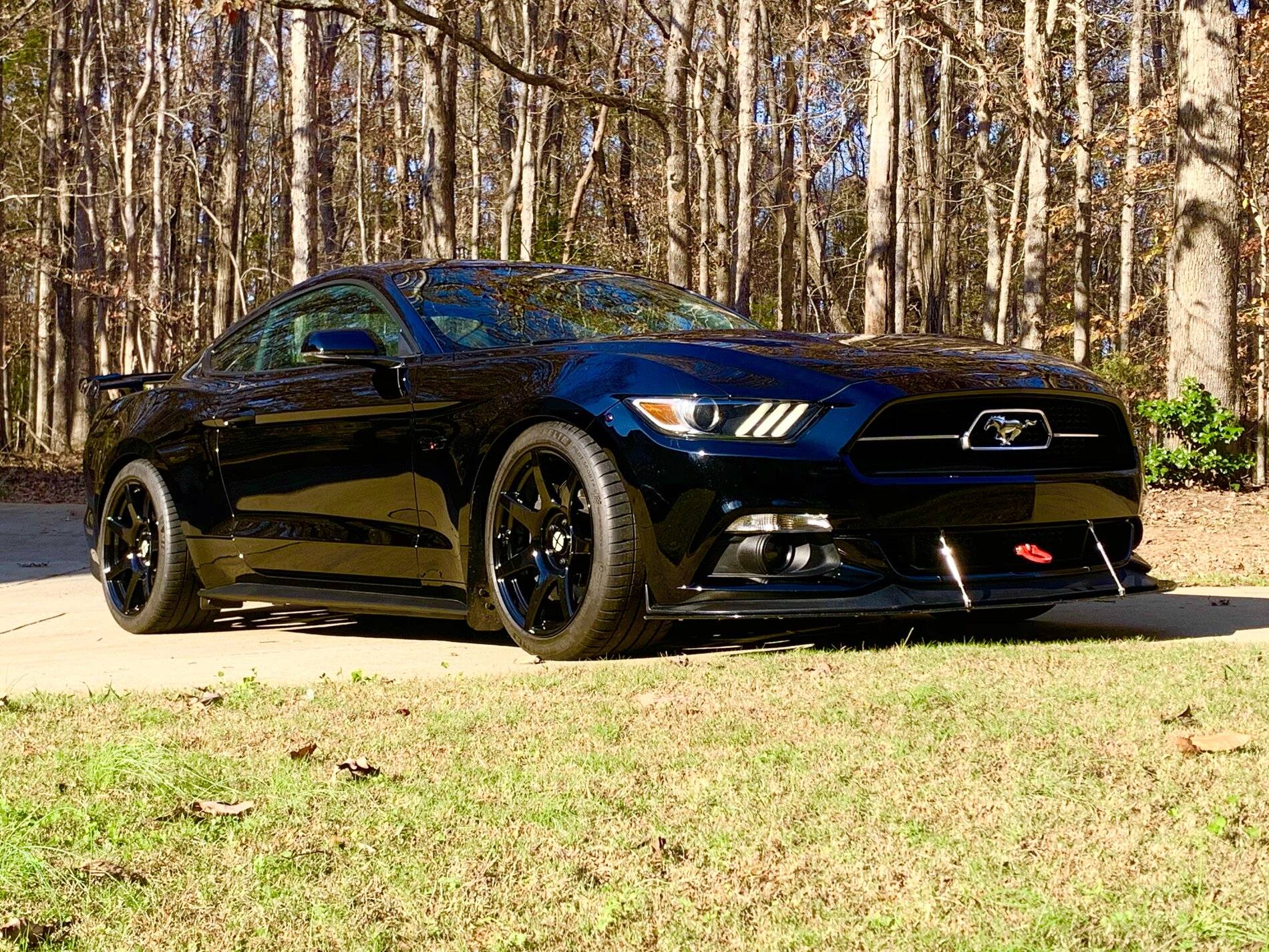

So now I have a dilemma...
1. Do I stay with my current wheels 19x10’s and run 295’s toyo RR’s. Max tire for wheel width.. anything to be concerned about..?
2. Fit ARP extended studs, so I can use spacers up to 20mm, clearing the inner suspension.
3. Lift the ride height an inch on the coilovers to ensure the wider tires clear the wheel arch.
OR
Buy another full set of squared wheel and Tire combo with 18’s and correct offset to negate the need for spacers...
Nothing showing up in the classifieds for Apex wheels ☹
Any advice or direction would be appreciated..

My 285 Pirelli trofeo R comps had a wideish sidewall, which on the unloaded tire on a clockwise track deflected or distorted, rubbing on the coilover spring.
