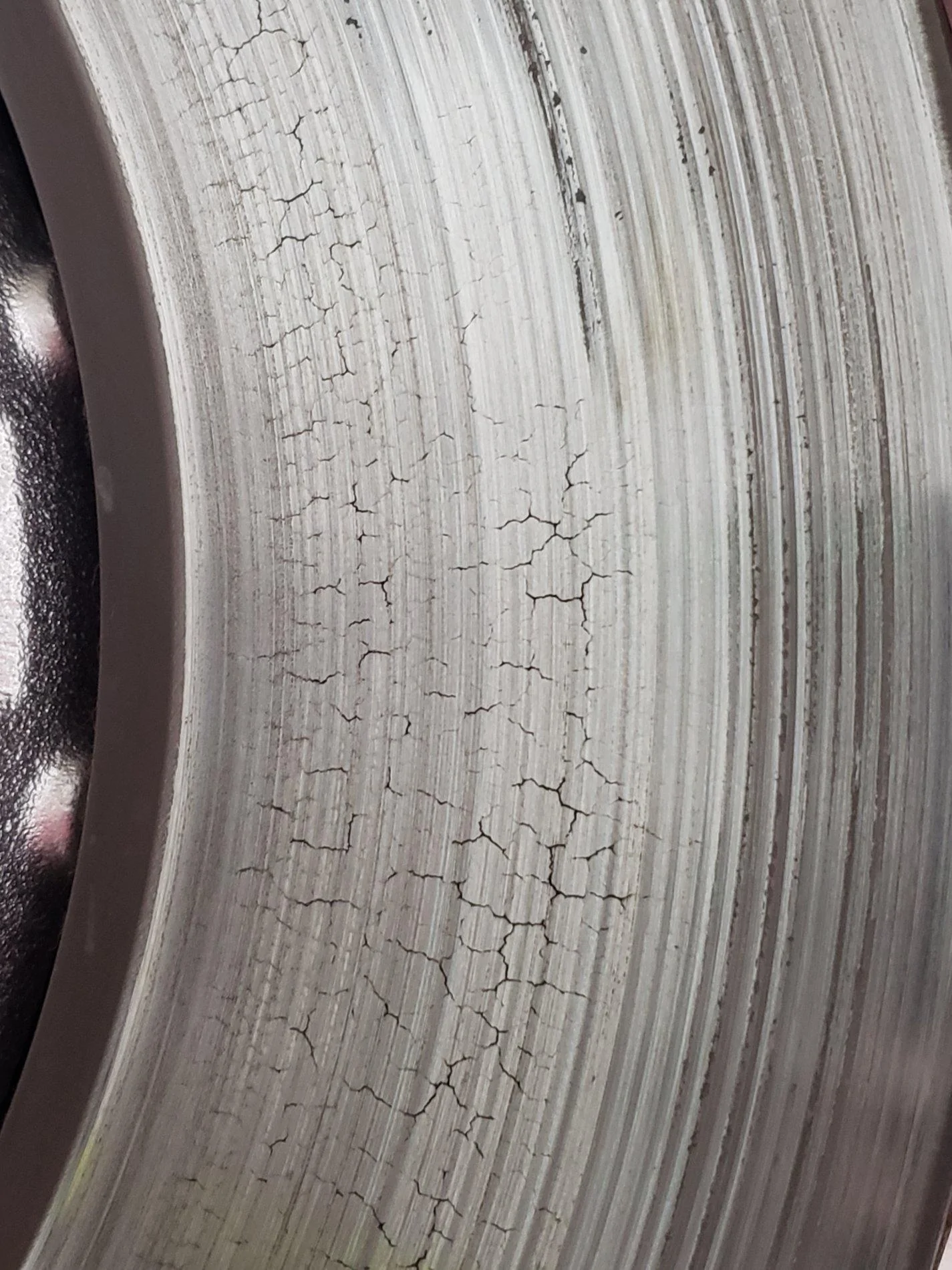

Rotor wear with the Raybestos (like all pads) will come down to heat. I've gotten anywhere from 6-20 days out of a set of rotors. These days, I am getting closer to that 6 day time with the added aero, bigger brake zones at tracks like COTA, and aggressive braking. My 2019 rotors look like this after 3 days (boooo).

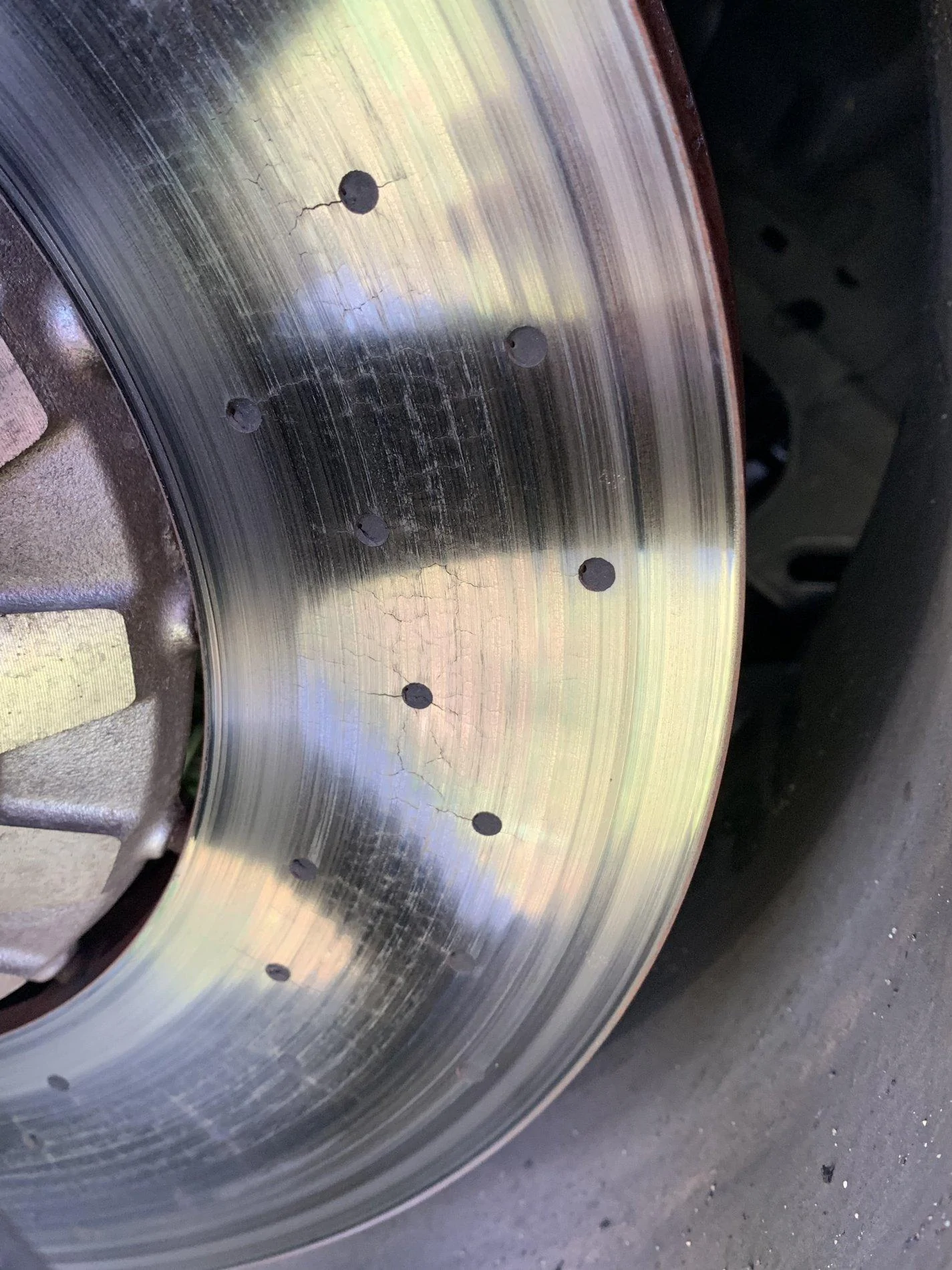

My rotors started to crack so I had to change before the cracks met between the holes.

Is it possible the 2019 rotors wont hold up as well?
Not sure. COTA in July is definitely about as much abuse as I can imagine rotors getting, so it might be unfair to base an opinion on it. However, I was really let down to those cracks already. If anything, I don't think they're going to last any longer than OEM and they cost more. It sucks.
Will be switching to GiroDisc I think.

Are those actual cracks in the rotor surface, or just the deposited pad material cracking?

I think the holes help dissipate heat at the cost of strength.
