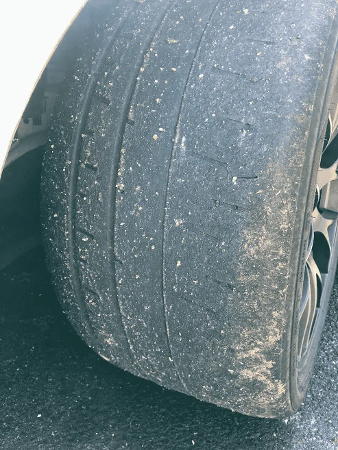

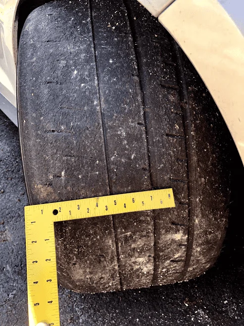

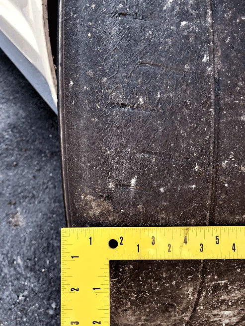

I agree, most that post about the 3R say 2 or 3 days, but for some reason mine are worn very nicely after 2 days... they could very well fall off in grip soon though.
I'm on my second set of 3Rs, these have 8 days (3@daytona, 2@Summit Main, 2@NJMP, 1@Summit Shenandoah) and 35 heat cycles as of this past weekend (square and rotating often).
-3.0*/-2.5* F/R camber and they're only showing wear on the outer ~2" of the tire. Looks like they'll heat cycle out before the tread wears out which is surprising. It's still pretty cold here so I can't tell if it's ambient temp or if they're just taking longer to warm up. They were always kind of hockey pucks when cold. 30*-40* ambient and they're at full grip in 3 laps. They still have plenty of grip when at temp.

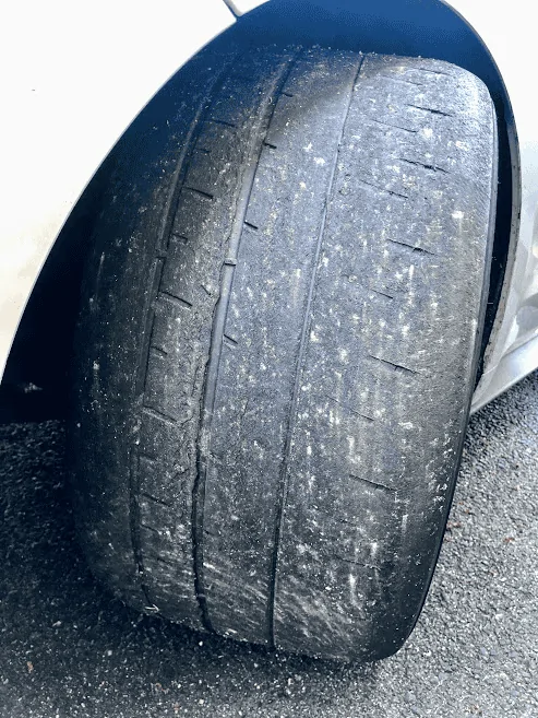

Killed my SC3's on day 7. outside edge died on 3 of the 4, so -3.2 isn't enough for them but not sure i'm going to give the next set any more than that. Def will buy them again!
