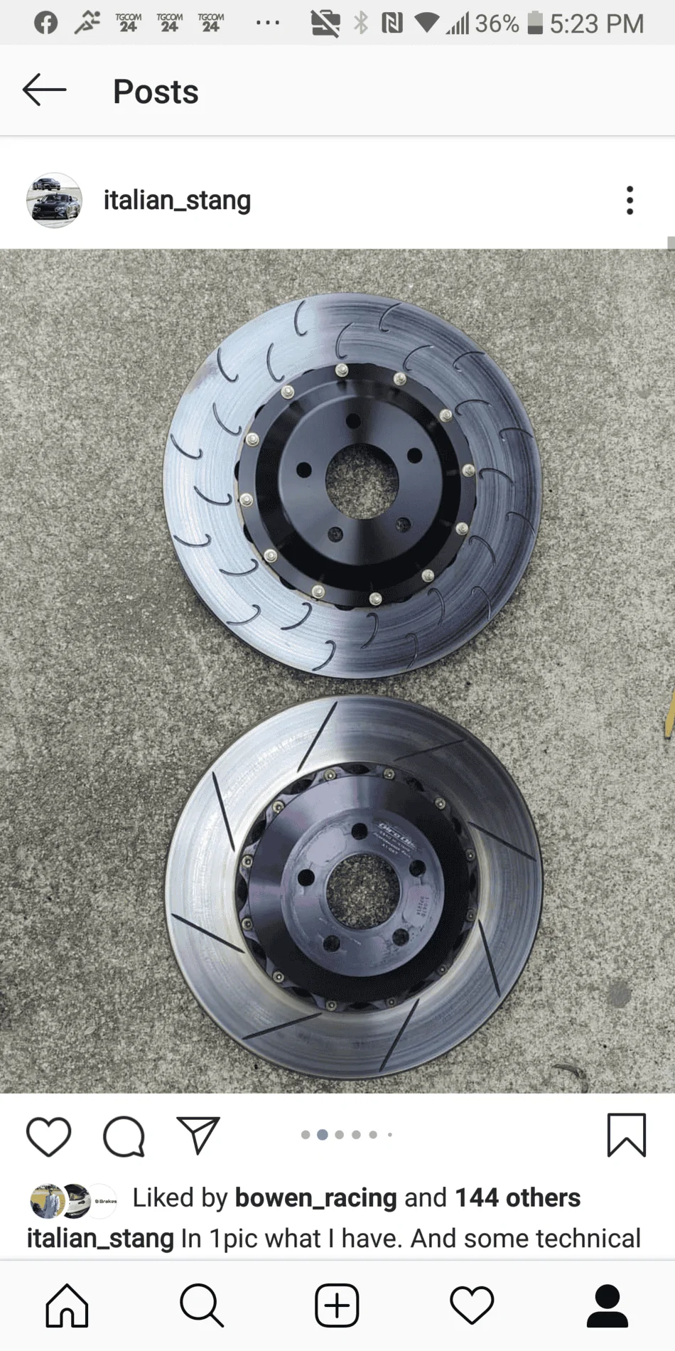

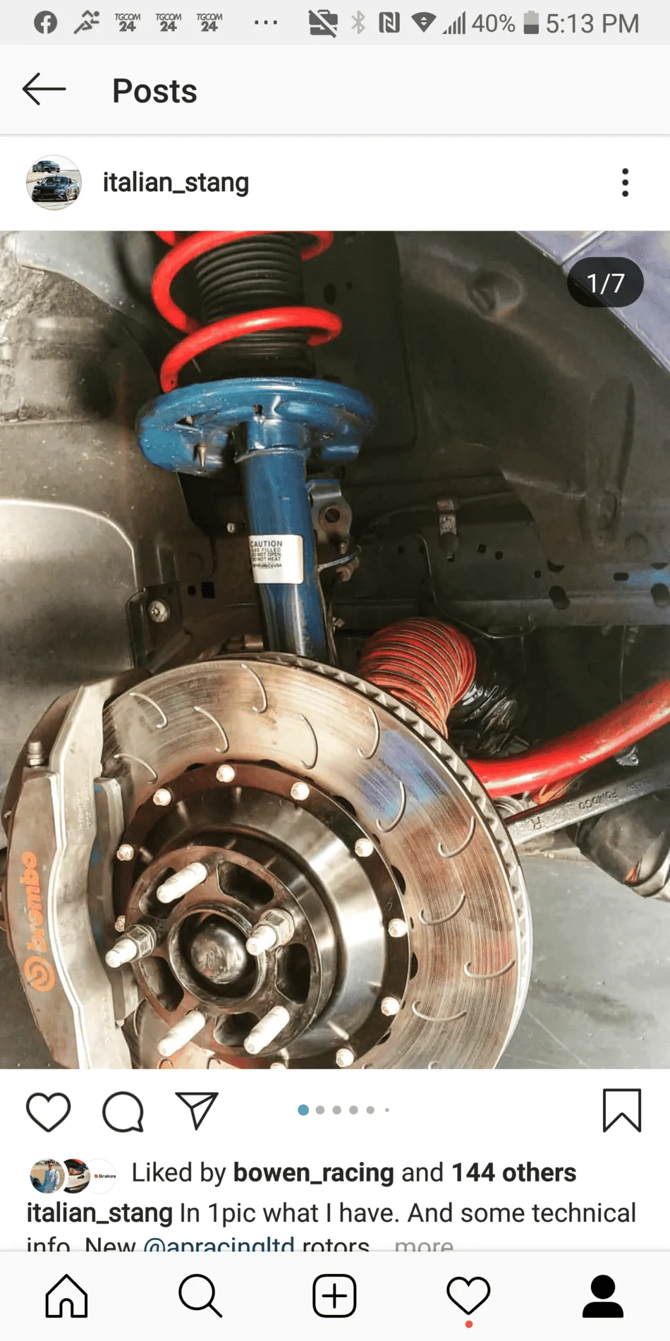

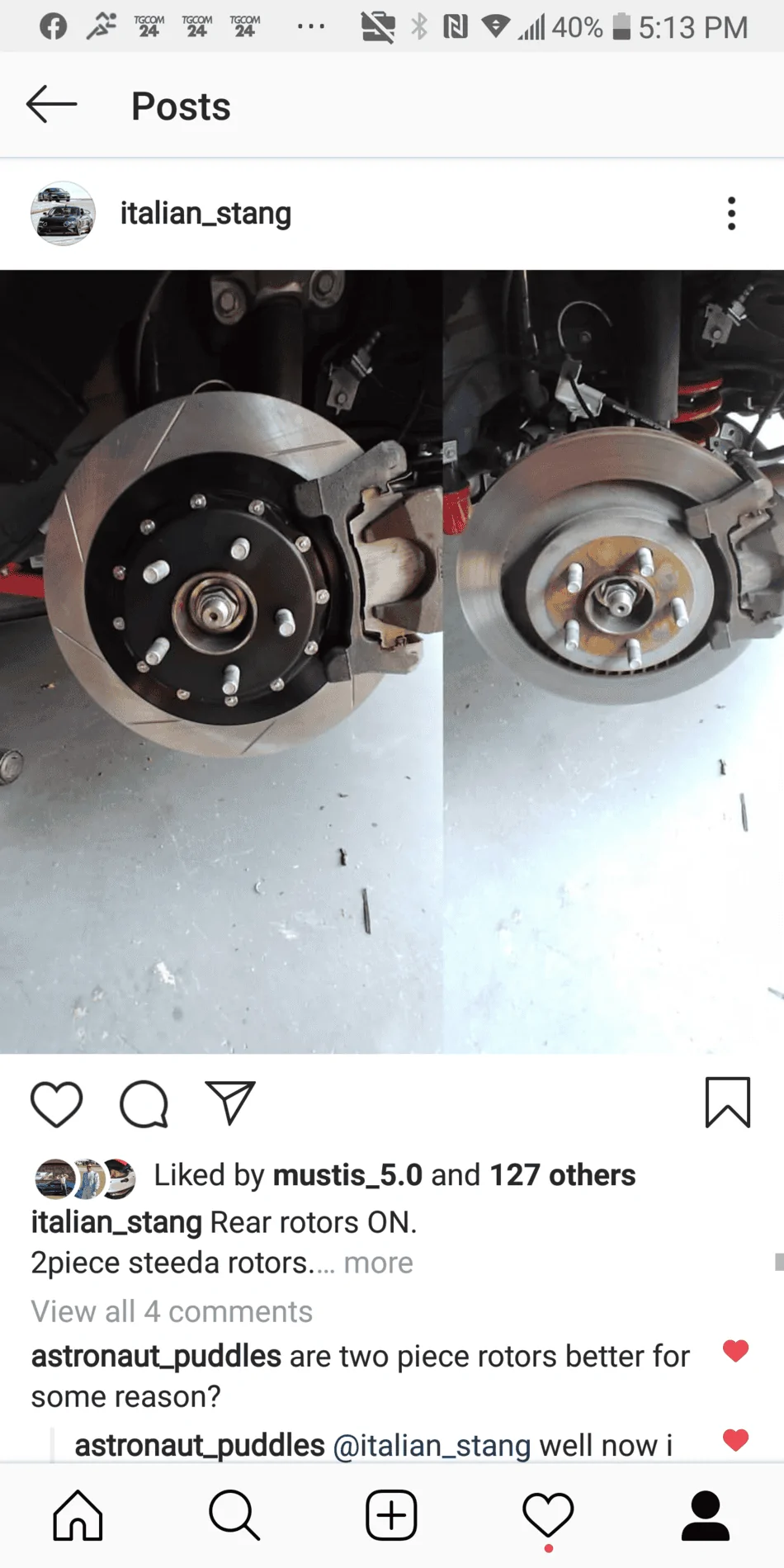

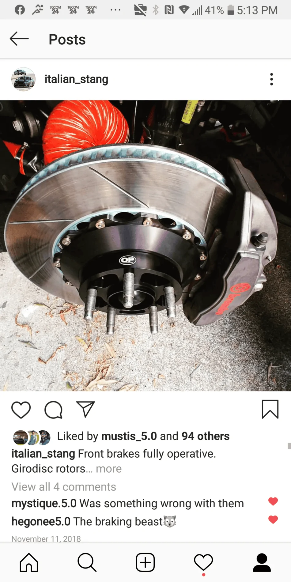

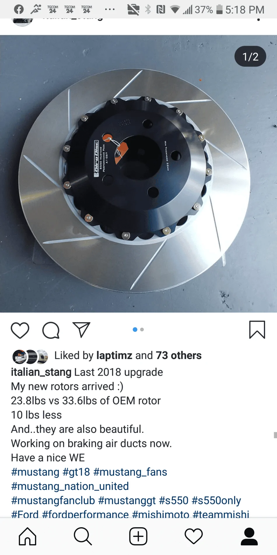

The contribution of brake power from the rear is almost none.
You could run OEM pads.
I put R10 gLoc on the rear pair with 2piece rotors steeda. Main issue in the rear is possible oveeheating due to the OEM reverse rotors. So i would suggest 2 piece on the rear too.
For the front rotors. I had GIRODISC for 8 track days. Sold them with 4 left at least.
I now have AP RACING rotors. Theynare half pound heavier than girodisc ( but still 10lbs lighter than OEM)
Ap racing has more vents and thinner fins for better ventilation. Both are great options.
Last but not the least.
Highly suggest are back plate for brake air duct solution. I now use the SPECFAB RACING plates. (Sal molinare. ) great stuff. My car is a GT18.
HOPE THIS HELP
Alex

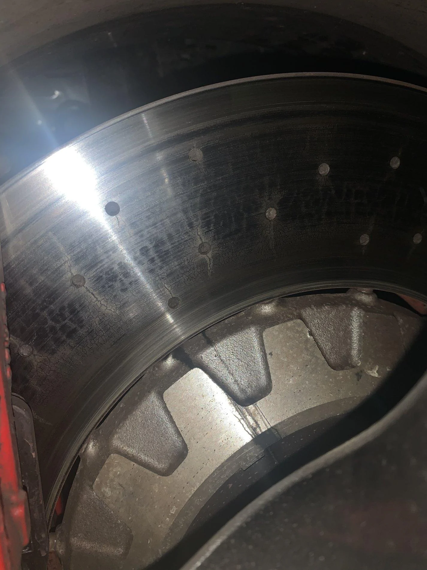

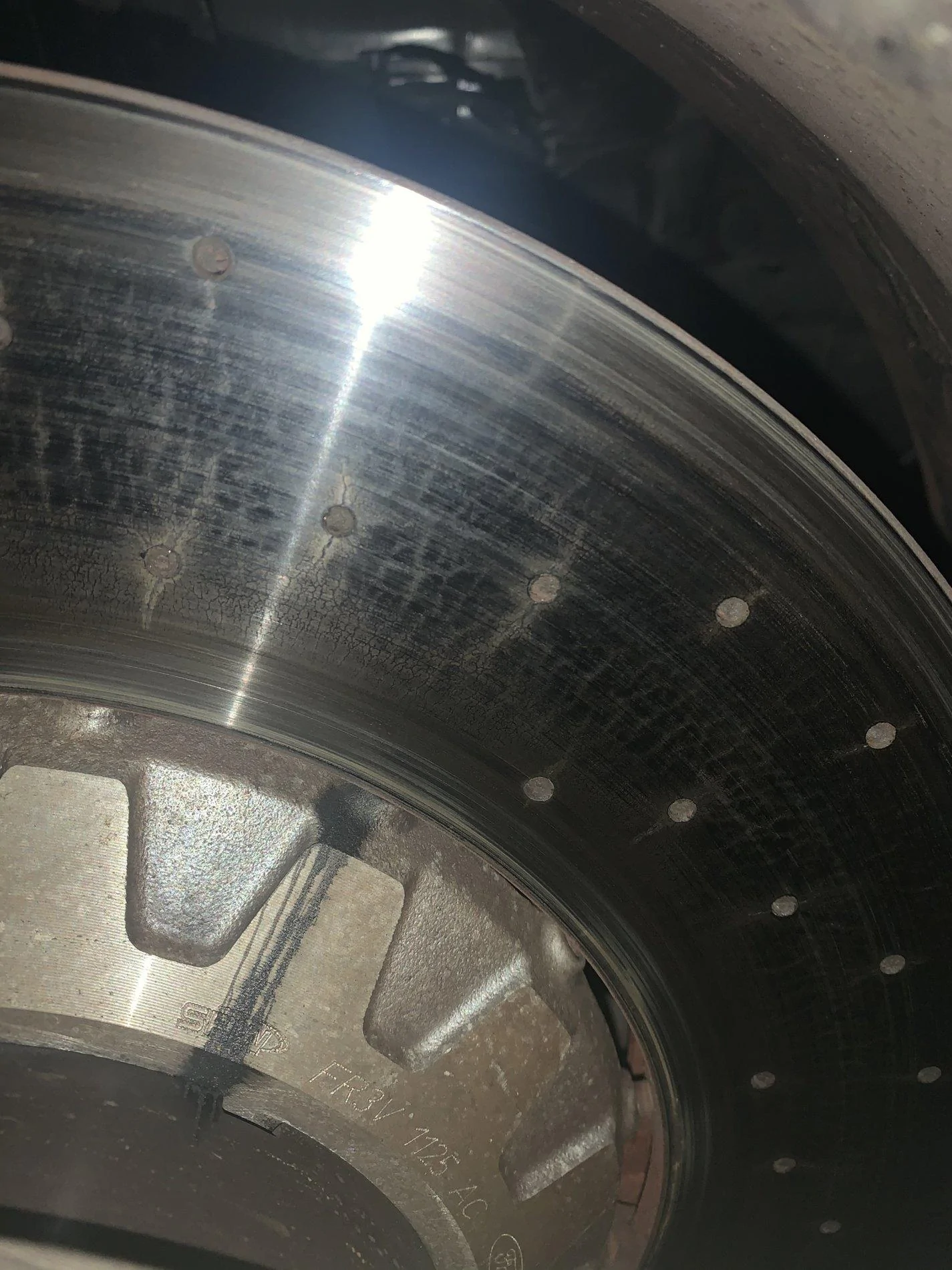

My pics in post #28 show after (2) days Watkins Glen with Raybestos ST45. New data point below shows an additional (1) day at NJMP Lightning with the same pads; biggest crack is about 1/4” long:
Have to keep an eye on it but the st45 is pretty high up there in aggressive pad and those are some high speed tracks. I don’t think that wear looks abnormal and you may only be 25% wear before the cracks get too big, which would be 12 days on such and aggressive pad and high speed track, makes sense.

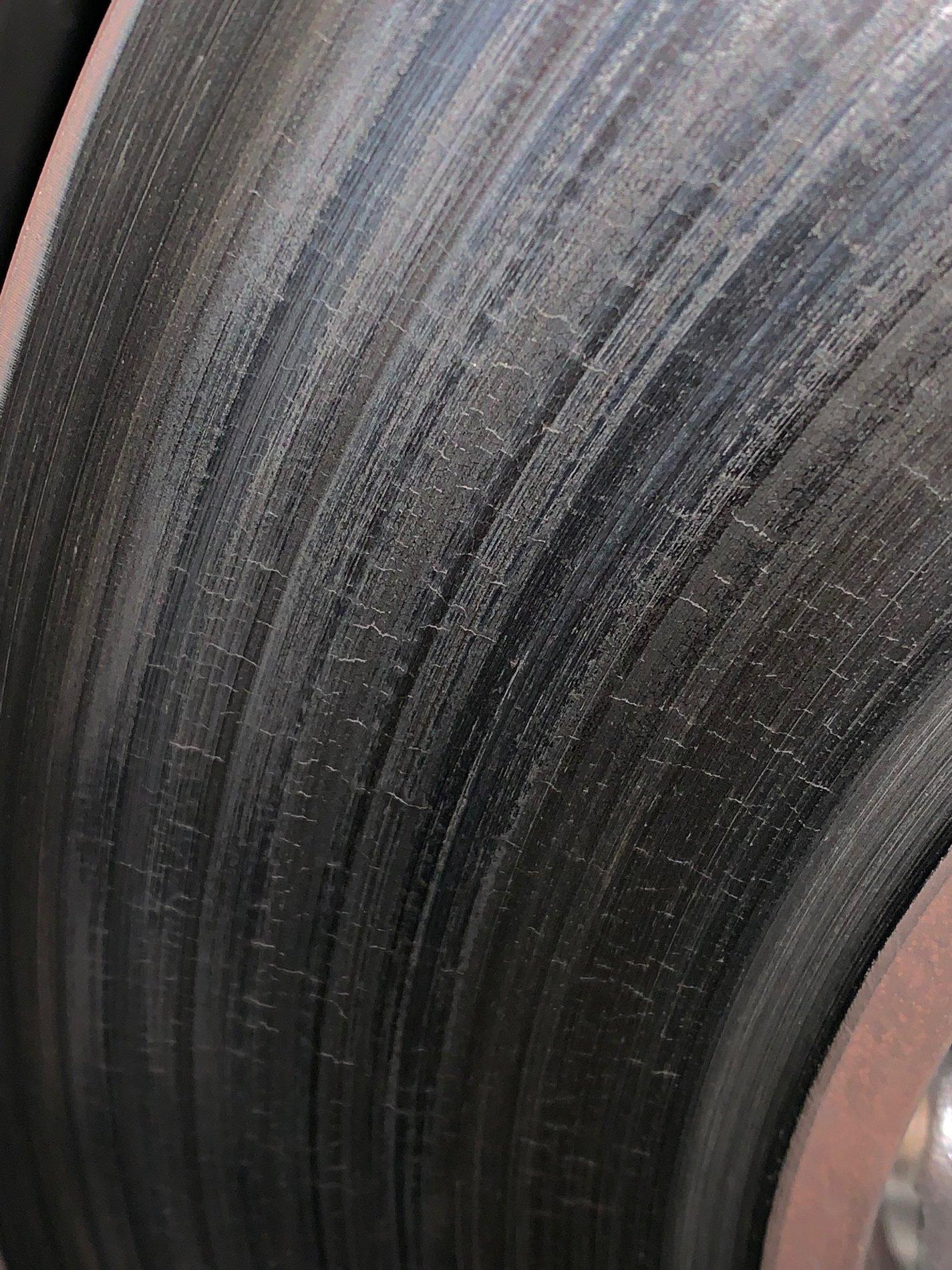

I have low 20 track days with only oem pads and my rotors look like this. I’d say probably another 5 days left even, maybe more.
I just ordered a full set of st43 to use next year with my new flat rotors. Don’t see how the drilled could last longer than flat, for example notice where my big cracks originate from...

^^^ what tracks did u run for the 20 days? Would you characterize them as easy on brakes?
