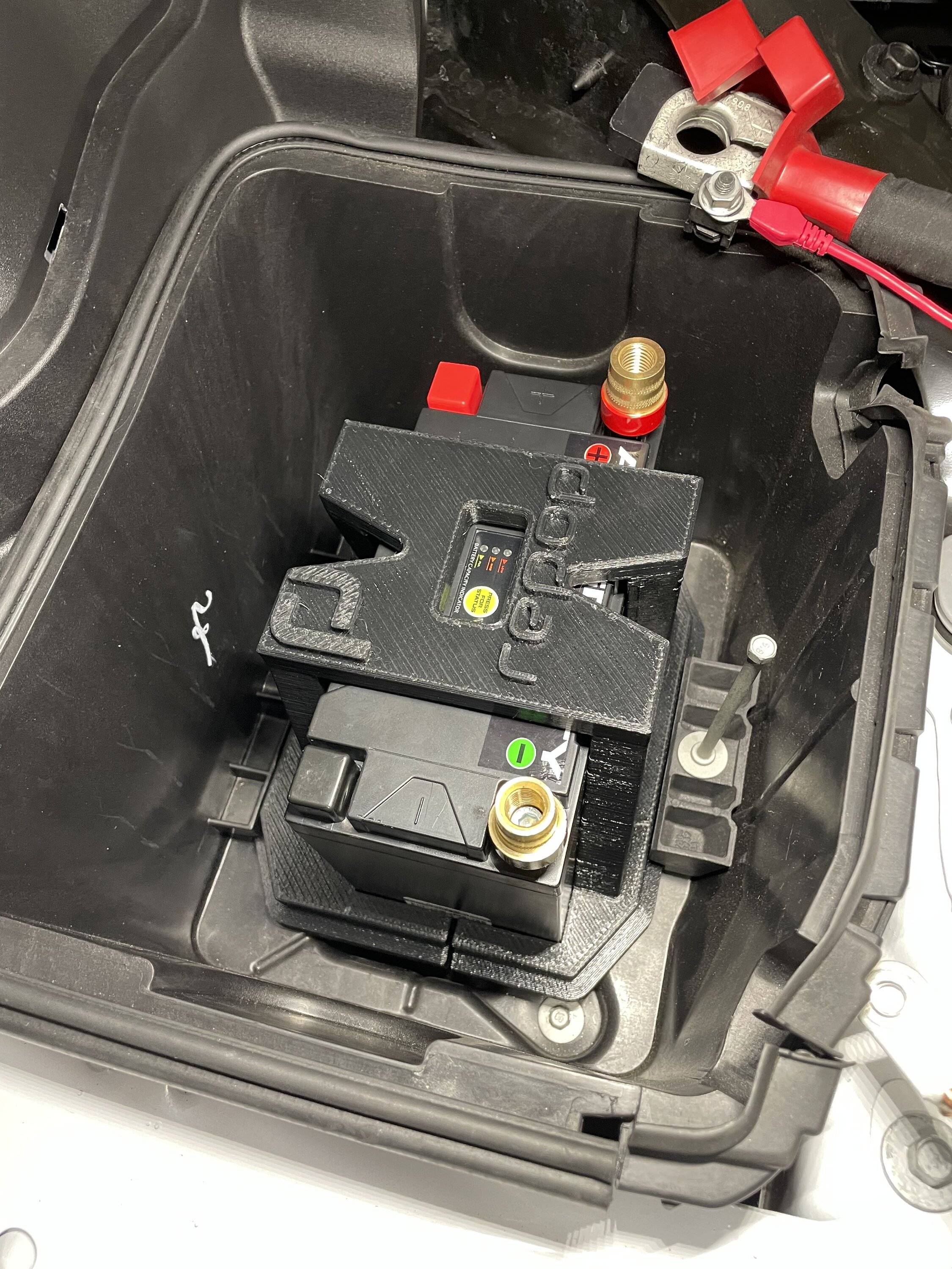

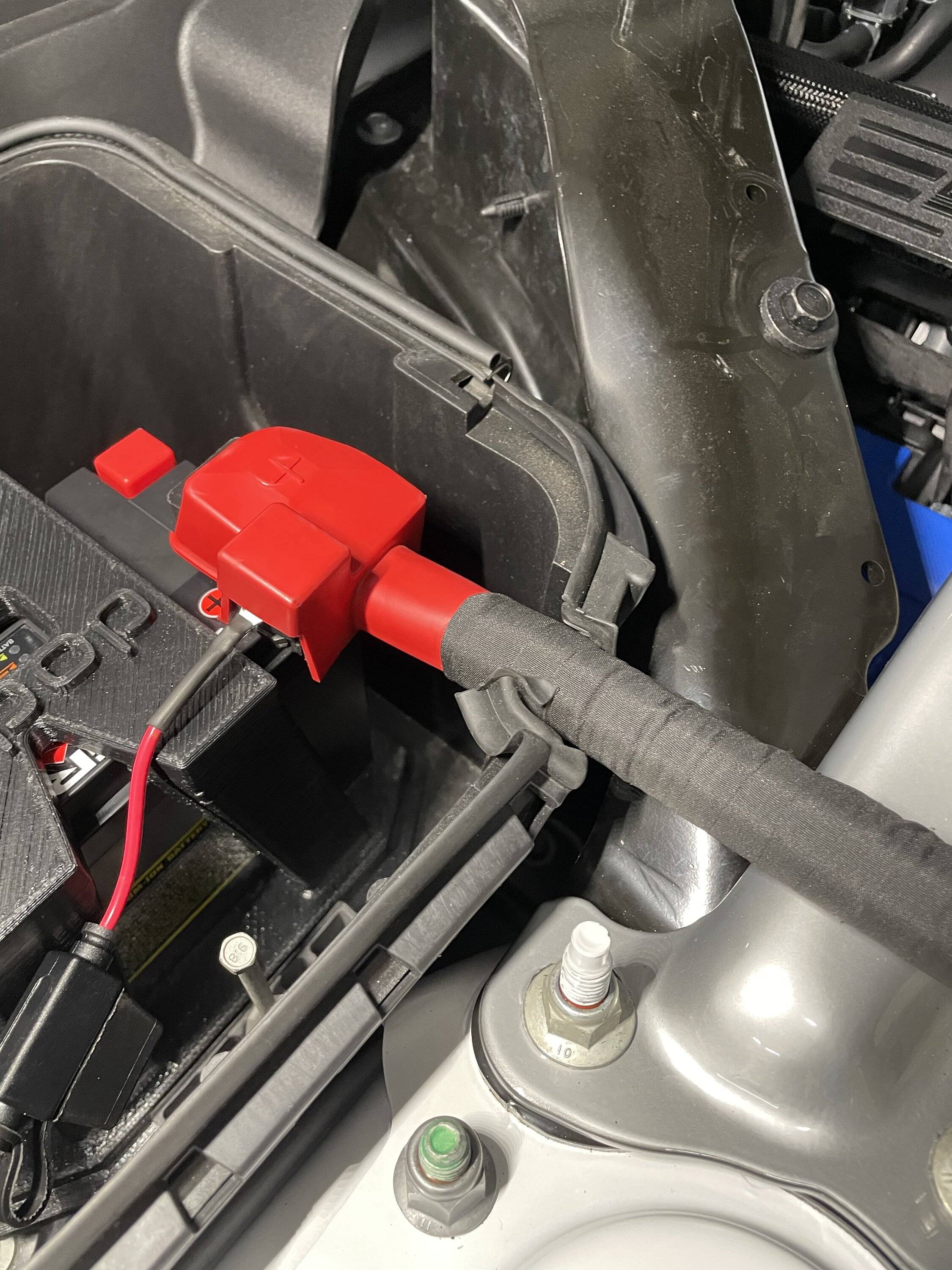

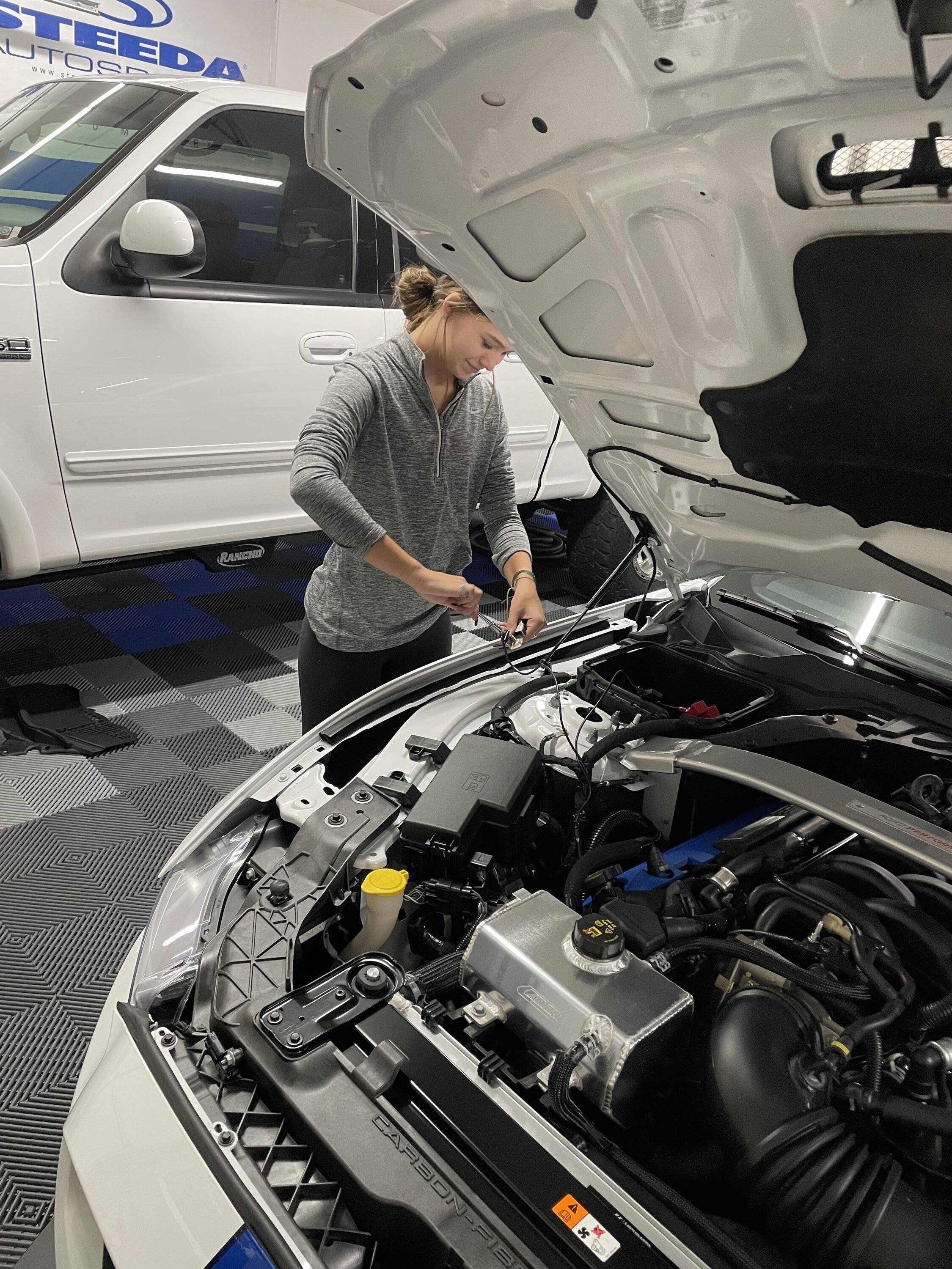

Fairly anti-climatic install. But sometimes that’s not such a bad thing. This mount fits like a glove. Don’t really know what to add to the story. Highly recommend this route if like me, you want to keep the stock box. If I was forced to critique something, it could be a tad bit taller so the positive cable fit down in the box cutout a bit better, but…meh
Yes…that’s my daughter. She’s becoming quite the little gear head.
Can you use a spacer underneath to raise the height.
