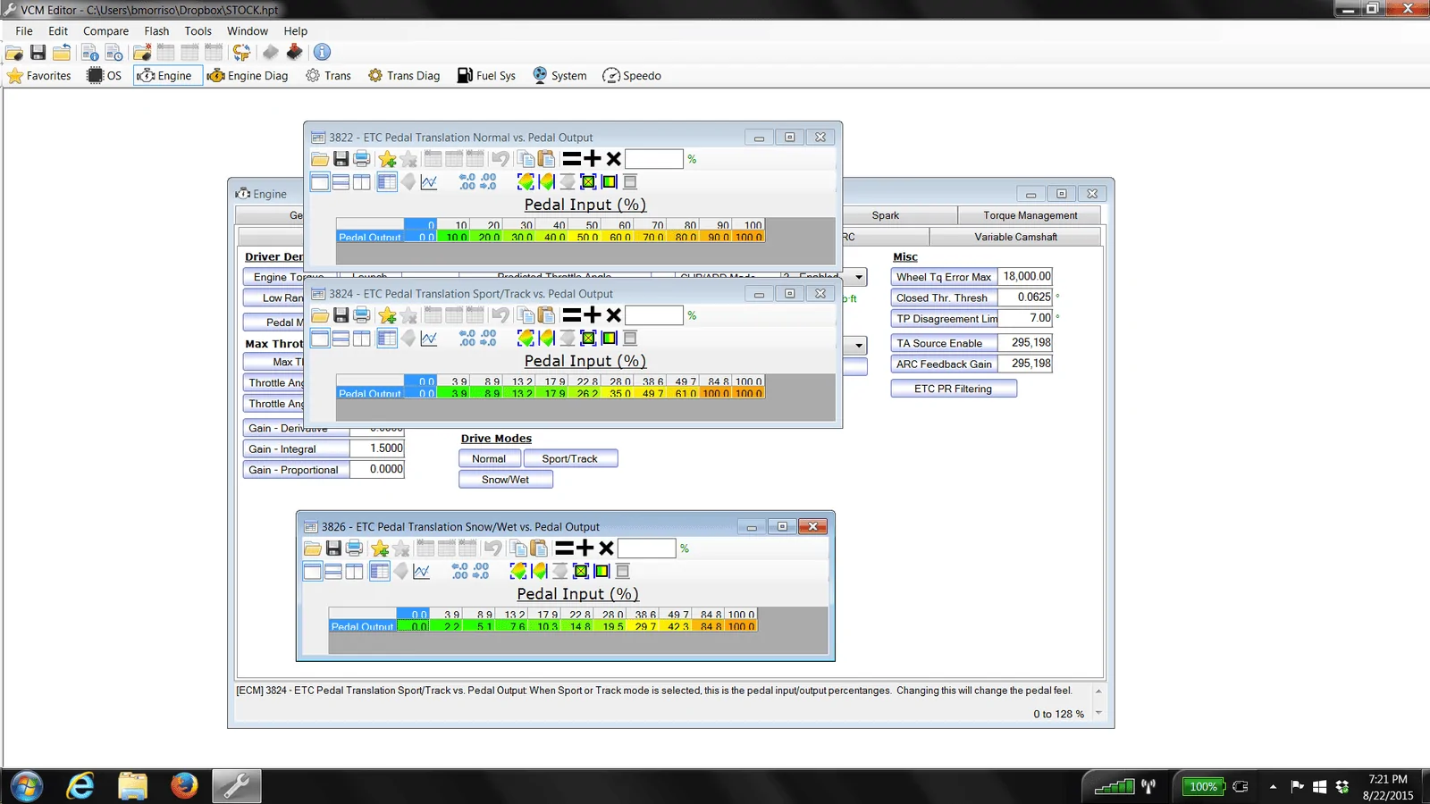

I only ask what it is doing in the different modes, because this is what the PCM says the pedal is doing in the different modes:
So my question is -- does this device take those values and multiply them? If it does, then it will have an impact on the modes. If it doesn't, who knows what it is doing.

Holy crap, you guys can't be this thick headed on how this device works lmao. This must be a running joke at this point, or else faith in humanity is lost just a little more haha
