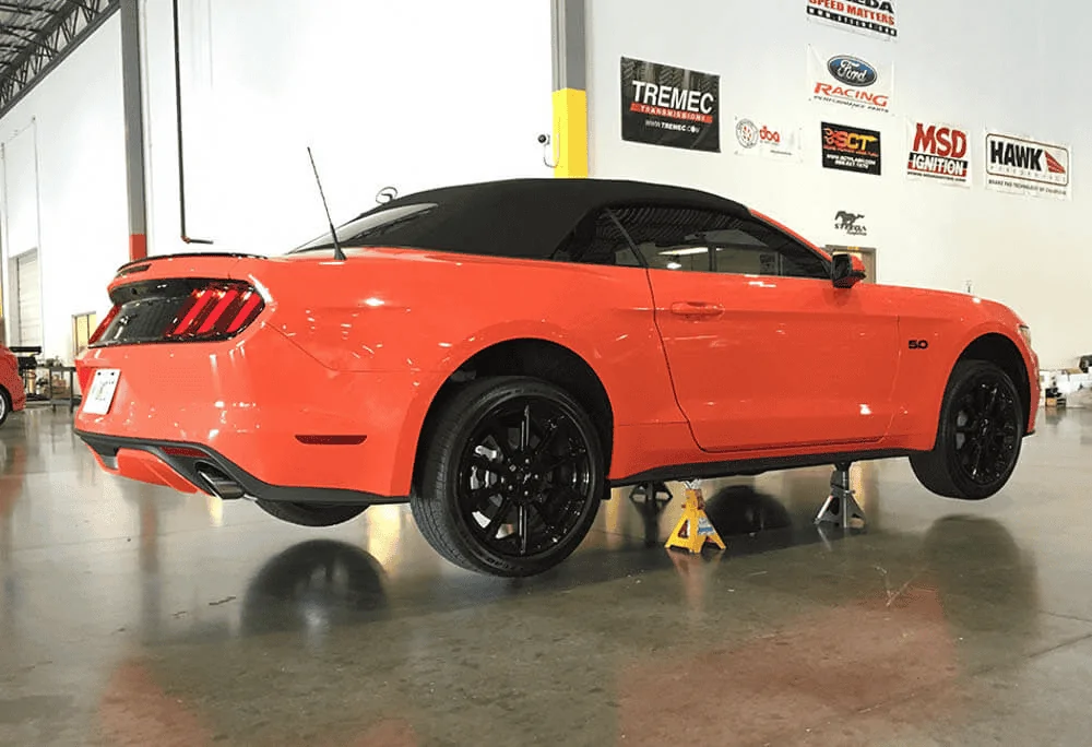

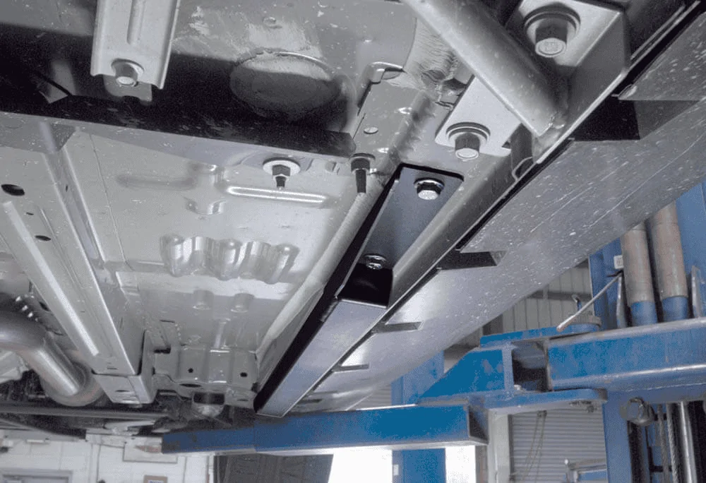

Hello Chris,
Our R&D, Engineers did a fantastic job designing the Steeda jacking rails - we have sold 1000s of the jacking rails across multiple platforms, & as mentioned above, many customers are very happy with the results - from fit to finish - these have been nothing short of awesome for our Steeda Customers.
We designed them for multiple reasons but the biggest reason is to work with the IRS Subframe Braces. That is why they don't extend further past where they mount.
As you can see, there are plenty of spots along the jacking rails to set the jack stands & to distribute the weight accordingly -
This video offers a little more feedback around the :35 mark:

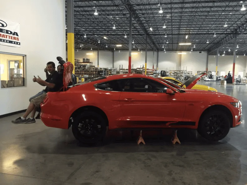

Customers indicated they wanted a longer jacking rail to put their jacks further apart ... so we had the shorter one & then developed a longer one. As you can see by the photo - they don't need to be too far apart to be effective.
Both are engineered & designed to work with our IRS braces.
You can beef them up with sealant or rust-proof them - in harsher climates, that is always a valuable next step. Here is some feedback from another thread:
"There are two (2) version & here is the benefit of both:
The “jackable” length has increased by approximately almost 15” (14-7/8”) which is over 40% longer than the original version.
They are both great options ... the 555-5205 have stronger mounting flanges and are more robust for heavier and repeated use. "
