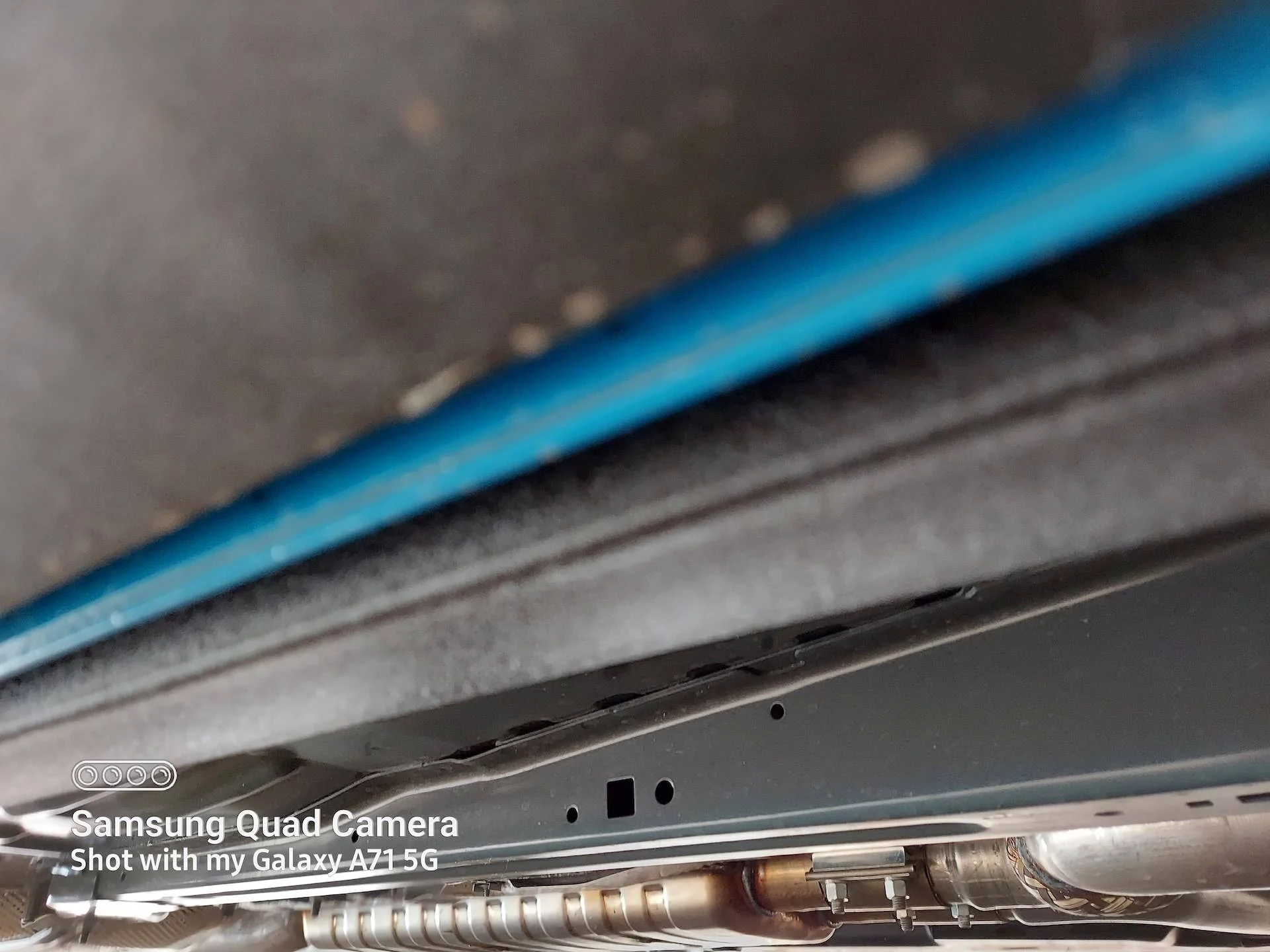

BTW, for any jacking rail, the bolts removed from the underside of the car were left by Ford. Ford uses them to hold cradles and rotate the car as it moves down the line. They don't reuse the bolts, for safety.

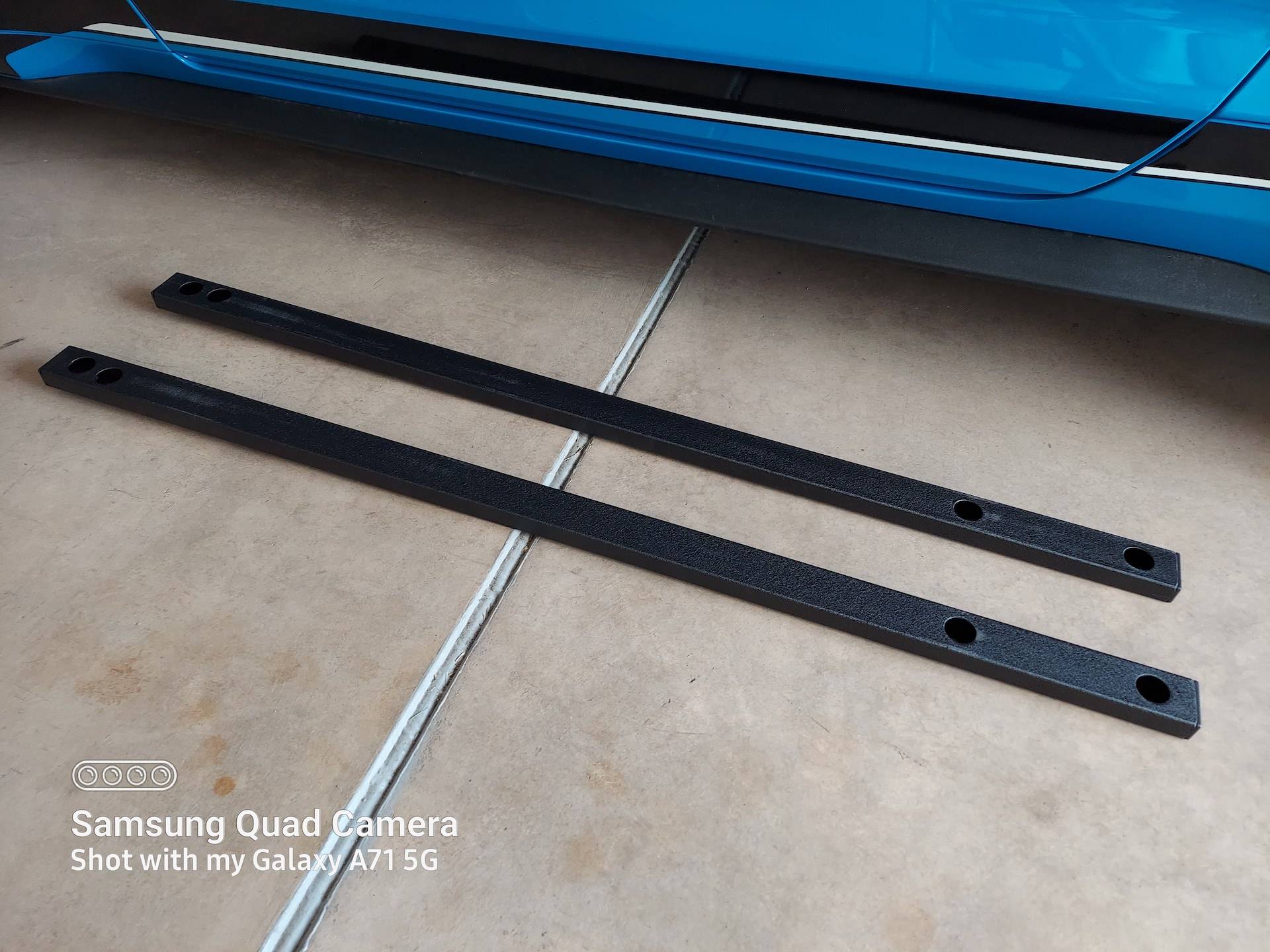

Yesterday evening, I installed a set of jacking rails, from Steeda.
This is my first S550. It helped to review jack points before taking delivery.
The first photo highlights the two rails. The shorter rail goes on the passenger side. The factory bolts are somewhat long and take a bit to remove, but it's easy. When installing the Steeda rail, put everything in loose, so you can move the rail around to get everything situated. Then torque down to 45 lb-ft.
The second photo highlights my appreciation for buying them. From left-to-right, we have the factory rocker panel moldings, the pinch weld/body seam area and finally the jacking rail. Virtually everyone recommended them. Now that I have them on, I can see why. It affords me a nice jack point almost the length of the car and keeps me away from the rocker panel spoiler.
You'll be given a set of rubber cups, to cover the bolt holes once installed. Initially, they were falling out and I was like WTF. Then I pressed on them, like sealing a Tupperware container. Suck. They sucked right into position, like a vacuum. Sweet.

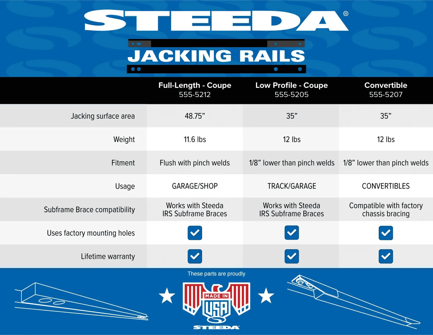

We have some great videos ... but here is the infographic we created to help guide you (& they are currently on sale):

Ok, Question.
The 35" is 12 lb's. but the 49" are 11.6lp's.
Why is one type 14" shorter? And does this matter?
I have no clue about these things, but I would assume the longer ones add more strength but again no clue and might not be understanding something.
The 1/8" lower tan pinch, seems like a better Idea for lifting the car on the rails and not the pinch at all. but maybe that does not matter?
How tight to the floor/unit body/frame rails do these sit, Should seal sealer be used to seal the rail to the sheet metal to keep moisture from between them that might cause a rust issue or is this a non issue.
I daily this car from spring to fall, so it sees wet roads, but no snow/ice road salt.
Thank you for your time.
tj@steeda
Mar 21, 2014
588
6,962
4,462
Timothy
Customers indicated they wanted a longer jacking rail to put their jacks further apart ... so we had the shorter one & then developed a longer one. As you can see by the photo - they don't need to be too far apart to be effective.
Both are engineered & designed to work with our IRS braces.
You can beef them up with sealant or rust-proof them - in harsher climates, that is always a valuable next step. Here is some feedback from another thread:
"There are two (2) version & here is the benefit of both:
The “jackable” length has increased by approximately almost 15” (14-7/8”) which is over 40% longer than the original version.
They are both great options ... the 555-5205 have stronger mounting flanges and are more robust for heavier and repeated use. "
