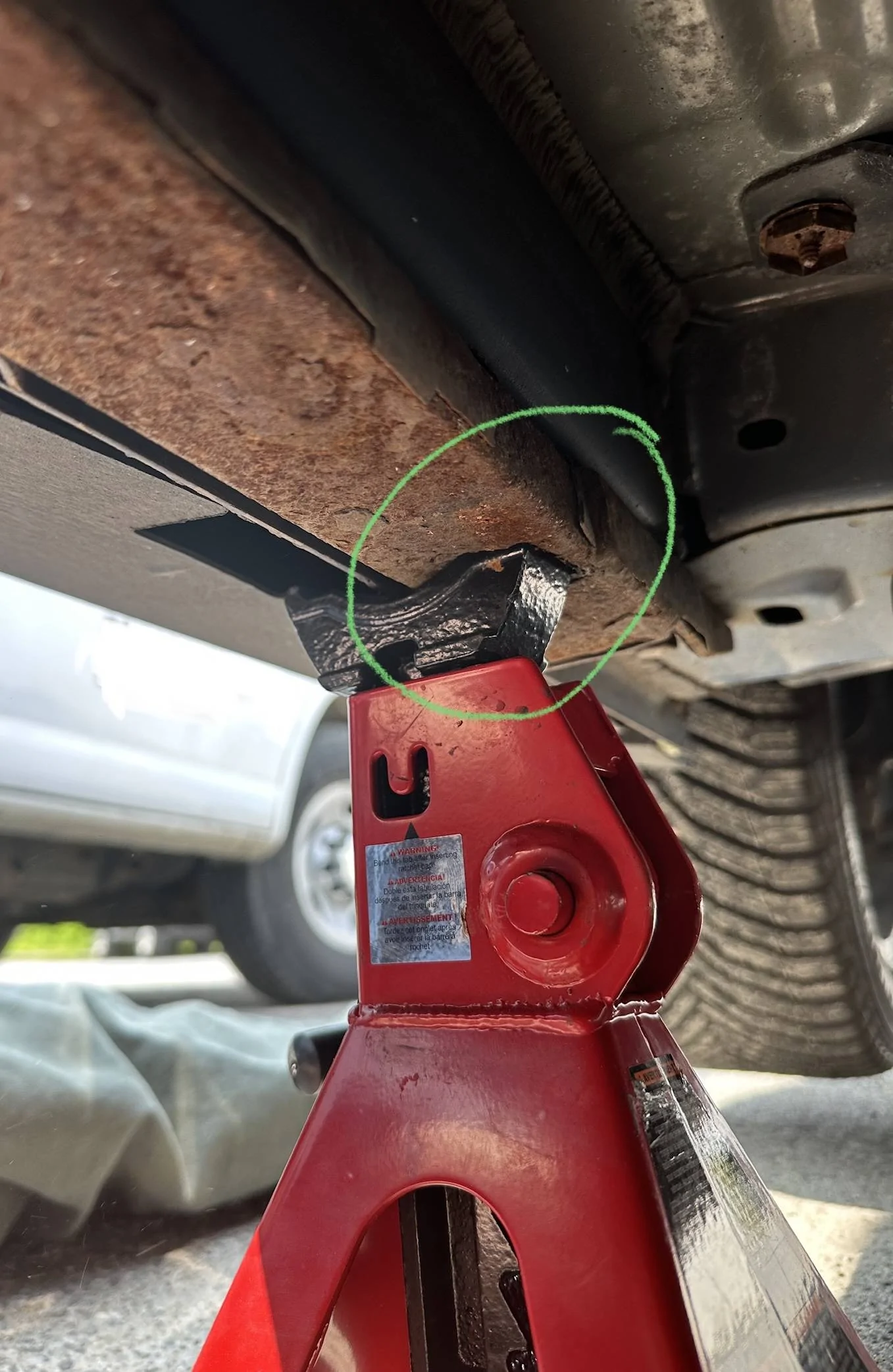

I'm irritated at the Steeda response to my email. I had Steeda jacking rails on my car 5 years. I was looking to replace them, but I felt I had my money's worth. I sent some photos to "Tim" directly (not in a post) to find out if their powder coat was really better these days because mine rotted badly and I wasn't sure about buying another set. Seriously, I was just going to buy a pair somewhere. Instead of admitting the quality was sub-par in the past he denied a warranty claim I did not even make. Why? Because of quote "atmospheric conditions" and "caustic chemicals." I'm not making this up! Yes, my car has seen road salt and car washes. I admit it.
So I'm irritated. I had not posted any photos but now I will. Maybe someone in here can tell me if I'm off wrong to expect better here.

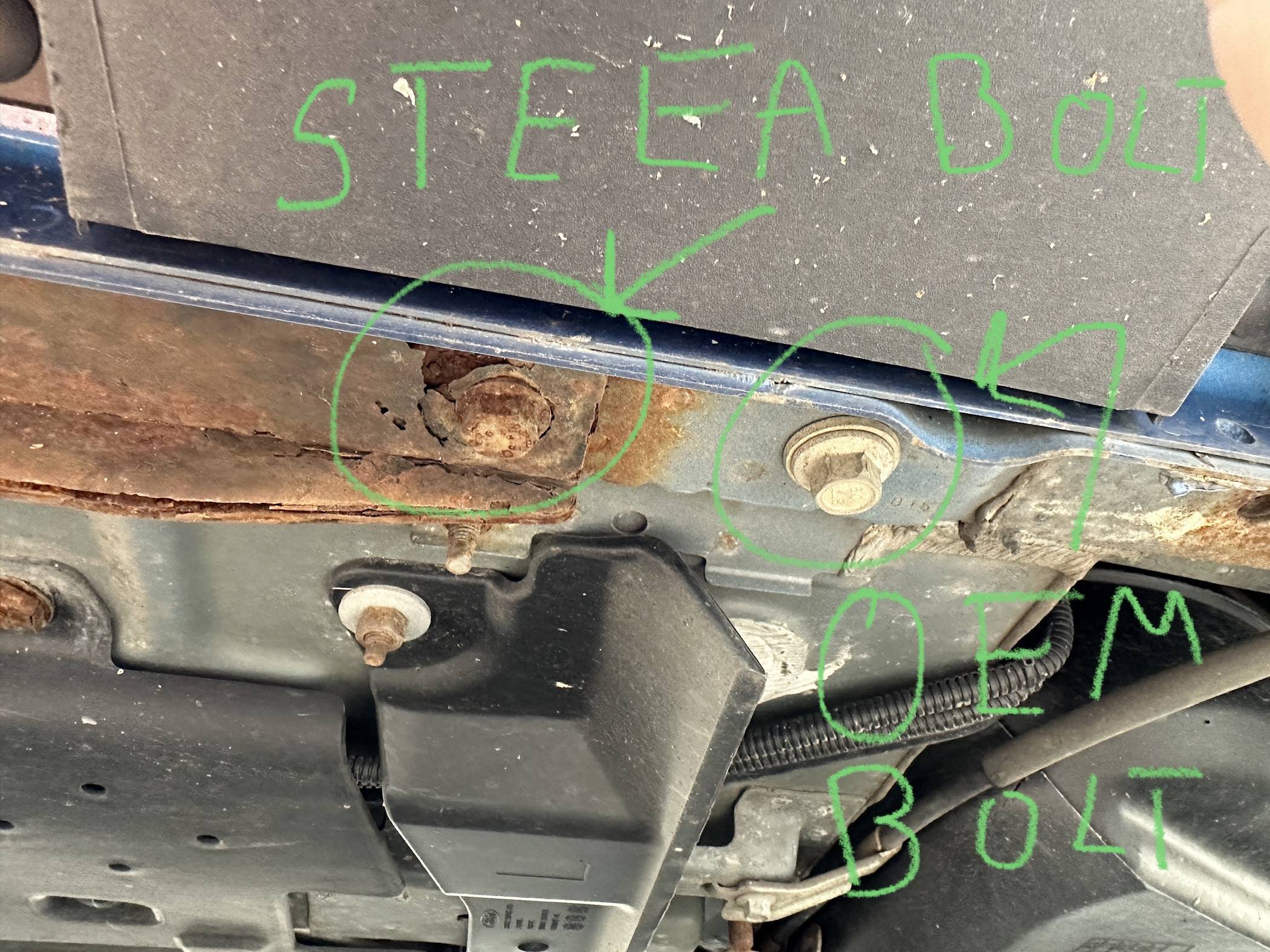

First of all Steeda's bolts are all completely rusted, the OEM have no rust at all. In fact I'm it looks as though the rust is spreading from the jacking rail onto my undercarriage!

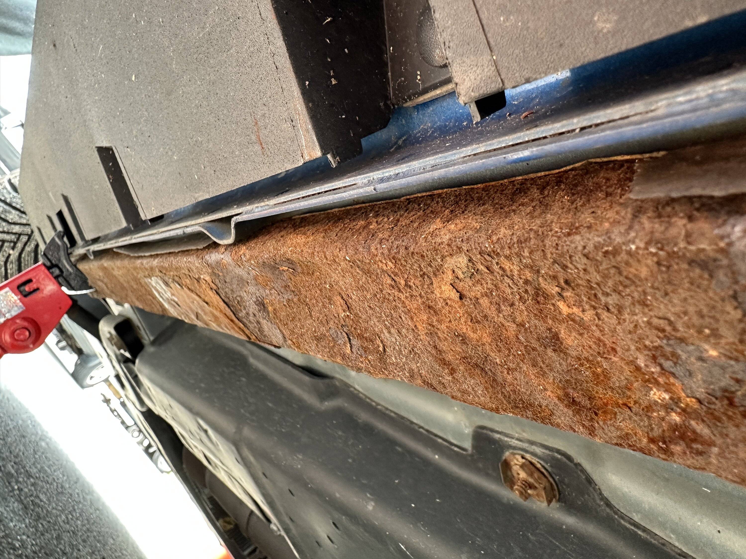

Lowering the car onto a jackstand yesterday even punched a hole in the jacking rail. The pinch weld is taking the load now.

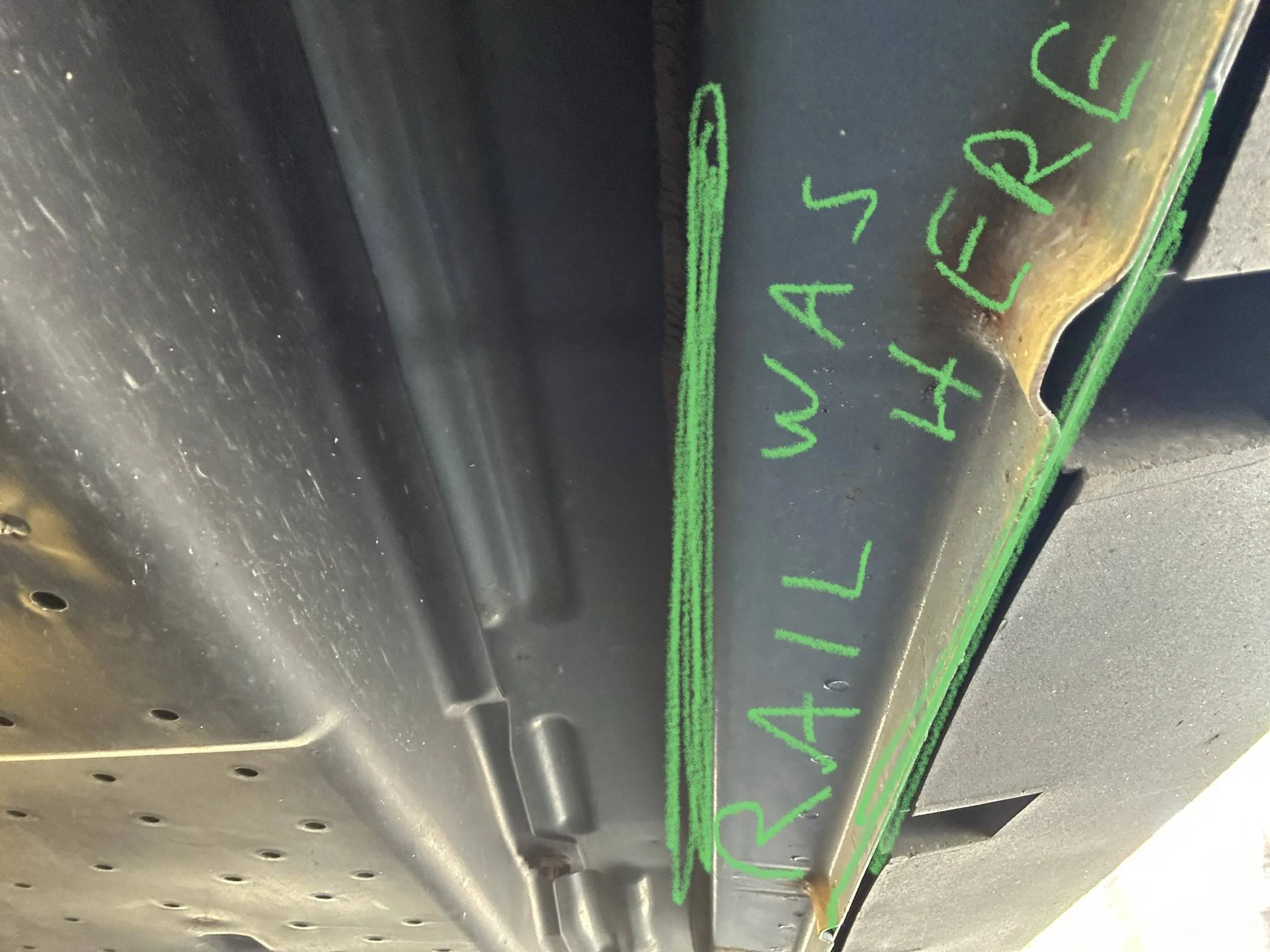

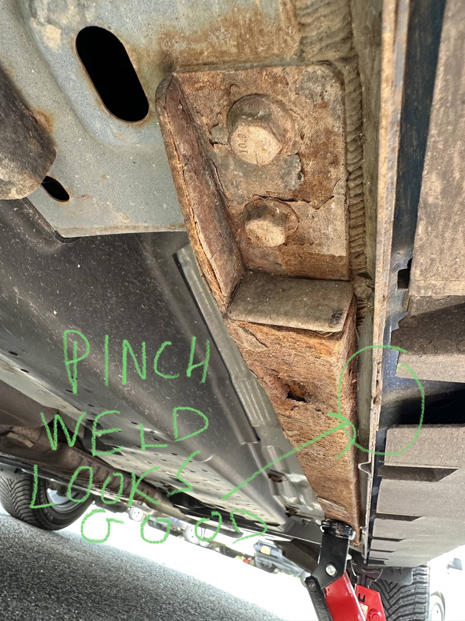

After removing one jacking rail the car looks great underneath where it was installed. This picture was taken today, and I didn't even wipe the undercarriage after removal. Notice almost no rust on the car itself.
You can see that the pinch weld is straight, paint is in place, the weld is strong. The rail is destroyed.
I have many, many more photos, and I even offered in my post to send the jacking rails back to Steeda.
I don't want a free replacement. I've been helped by this forum a dozen times for information. Now I'm giving back a little with information of my own.
Steeda: why even warranty an underbody part and then refuse to honor it because a customer lives in a snowy place? Lifetime? Then your piece should easily last as long as the car it's connected to.
Come on! Look at that rusty stripe running down the length of the rocker area. The powder coat has all flaked off for crying out loud. If my Mustang was that rusty I couldn't pass inspection.

Looks like the main issue is the steel quality itself. Definitely not galvanized, so if the powdercoat fails, then it's game over in short order. The OEM tub is much higher quality in comparison, which is why it's not showing any problems. Reminds me of American cars from 25 years ago, haha. Fenders and rockers would just self delete like that. On newer cars it's mostly the stamped steel suspension parts that rust out.
I'm not entirely sure that I'd be mad at Steeda for this, but they shouldn't pussyfoot around the crux of the issue, which is that these things are not meant for a harsh environment like NYS. Maybe they can make a version with better quality steel (or thick aluminum) at a higher price for those driving their cars year round, but the return on the investment probably isn't there (most people will just buy the cheaper version anyway). Would it have lasted longer if you used some sort of oil coating on a yearly basis? Obviously, but that's an unrealistic expectation to have of the customer. Unless they're going to add a disclaimer on the website page for this product that recommends that process for winter driven cars.
