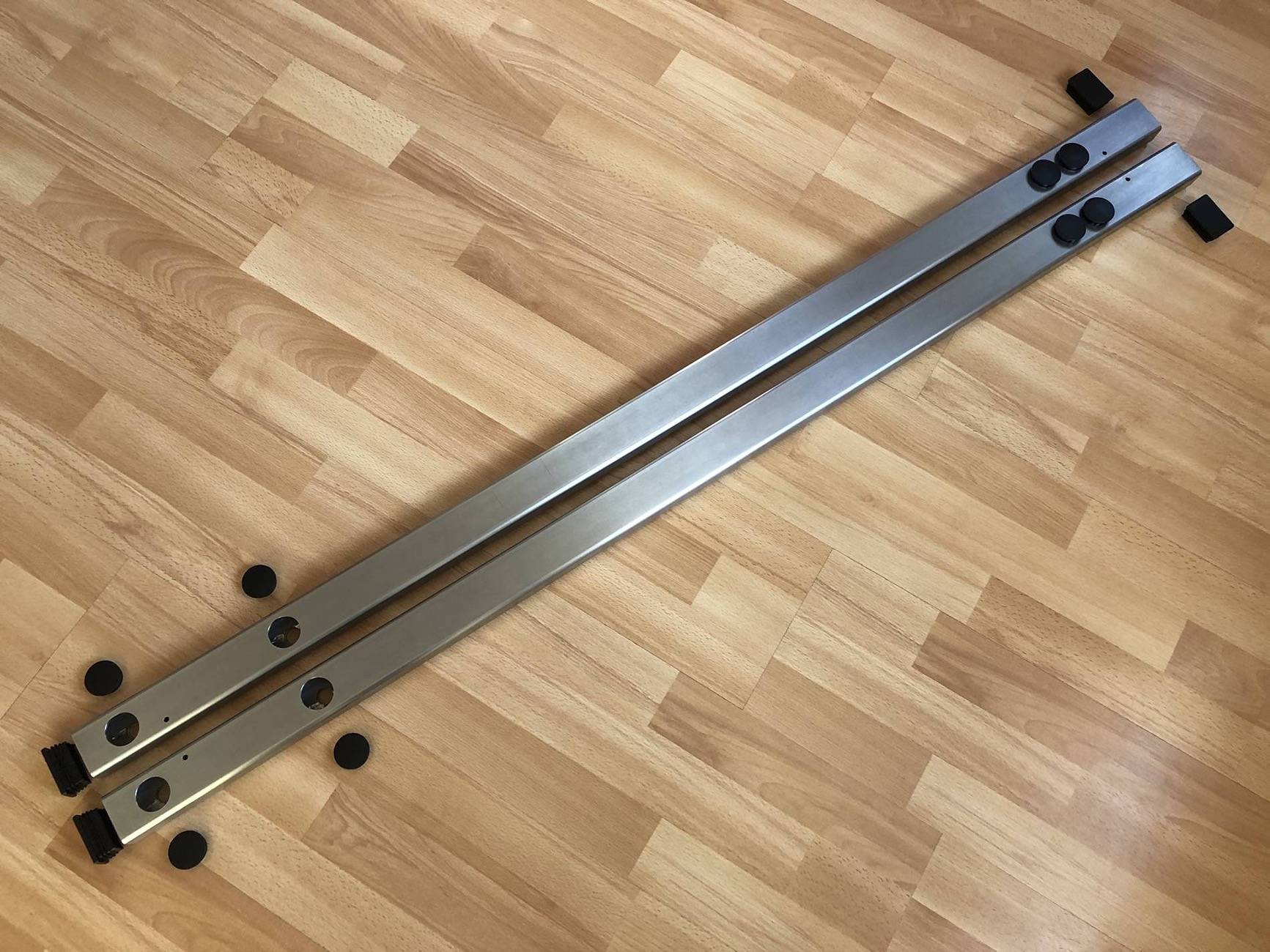

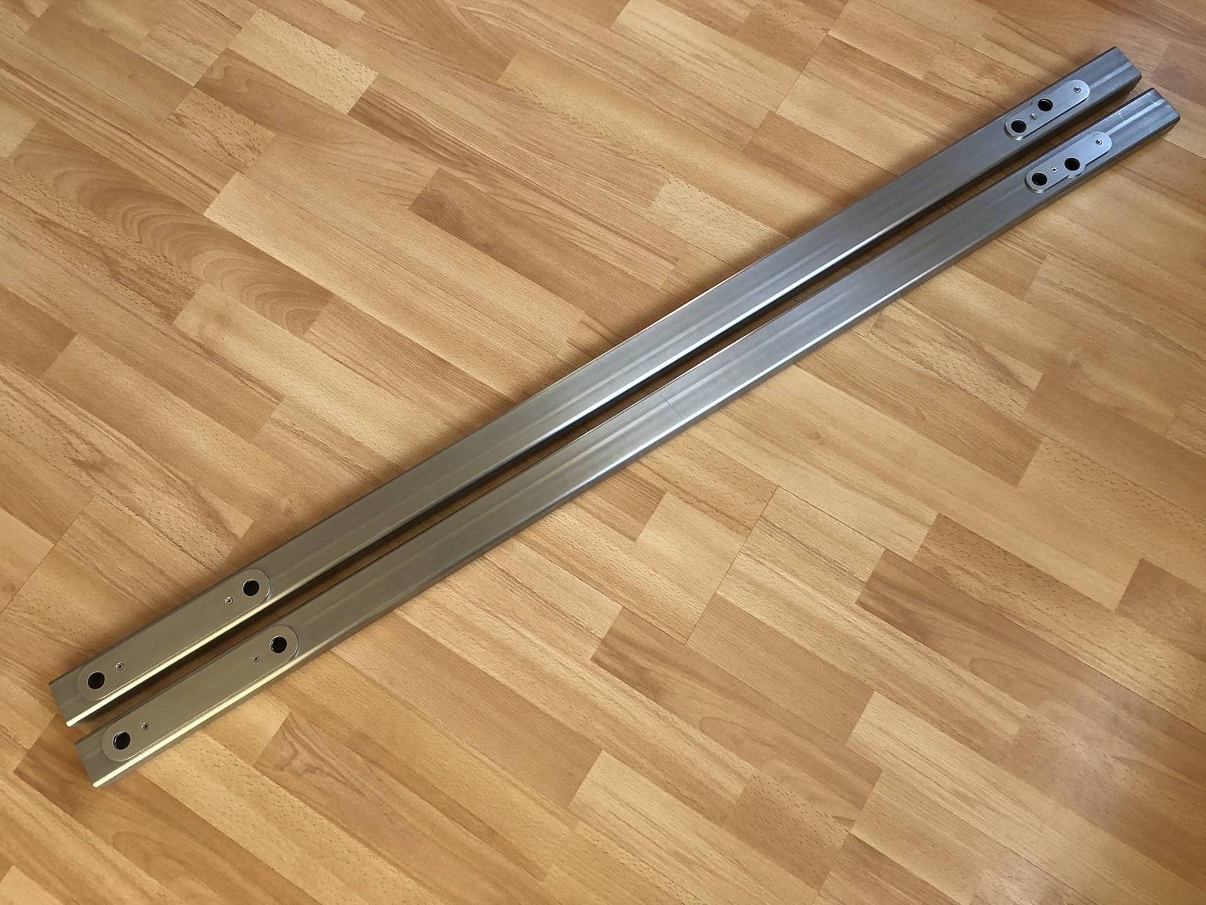

I took a similar route and for the same reasons, but I used stainless :

They look great and I got a price on stainless but it was 4 times the price and the only advantage is cosmetic so i passed on that idea given no-one ever will see it bar a tech and myself

Yes the cost was more, but I made those for £116 'all in', including the caps & plugs (including spares), laser cutting etc, and the cost of the hole cutter.
That was still 'much' cheaper than buying one of the big name suppliers products over here :like:
There is someone on here who has also made an aluminium set :like:

I actually got a price on Aluminium bar as well and it was about the same price as the stainless . Also aluminum a bit trickier on the fab as well with counter sunk holes etc . Also aluminium a lot gripper so not as good sliding over speed humps and the like . Sounds like you did yours a while ago , price of metals skyrocketed last 3 years .
