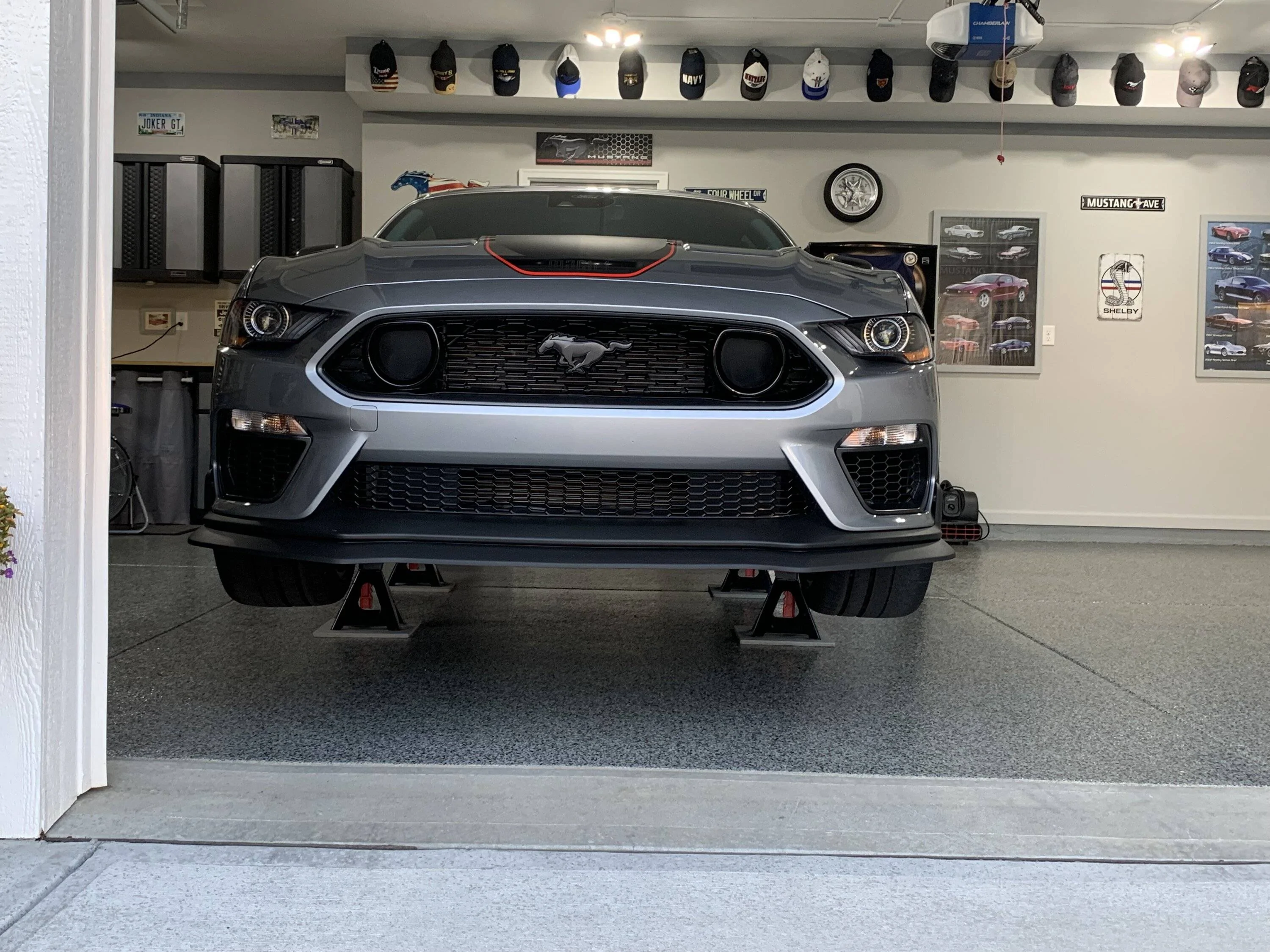

Steeda’s picture :
WD :like:
Yikes LOL, sure it may work, but I noticed when its towards the center its not as stable. Think of a seesaw.

Steeda’s picture :
WD :like:
Yes, that is what I thought as well. What is however not obvious from the picture, the weight distribution. It could as well be just 150 kg more in front (relative to the rear jack stands) to hold the guy, but the it would also mean that almost all weight of the car rests on the rear (almost middle ) stands, while the front one are just supporting remaining 150 kg.

Why didn't Ford then put the jack points/Pinch weld locations 2 feet apart from each other? hmm...

We could do a Free body diagram and study the forces. The Center of Gravity force vector from the car (55/45?) would be basically between the 2 jack stands. Yes it will hold fine but when you shake the car the weight is more eager to seesaw since the Jack stands are closer to the fulcrum center. Not saying its wrong it just feels more stable when set apart.

Probably fine for an oil change, but Im sure not pulling the transmission or dropping a subframe, or cranking on bolts with the jackstands sitting on the jacking rails

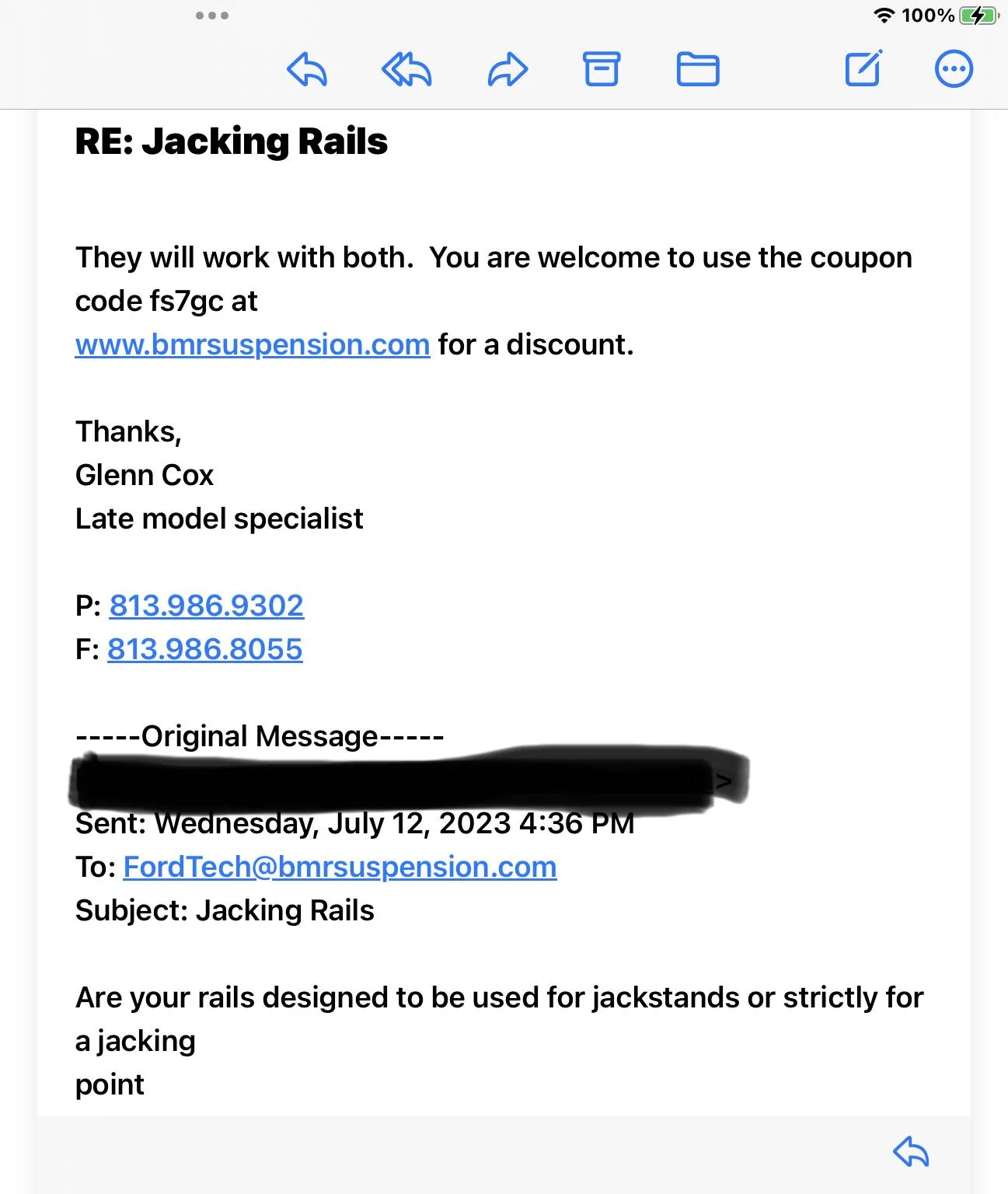

Not disagreeing with anyone but for what it’s worth
I believe the guy from BMR was not wrong either :). I do not believe the jacking rails are *strictly* for jacking the car up. But I would tend to agree that they are not optimal and in many cases using the regular jacking points should work at least as good, or better.
I guess my initial misunderstanding was that the jacking rails were supposed to ease the choice where to put the jack stands (or eventually to protect the pinch welds), but as it turned out, they made the choices pretty limited too.
