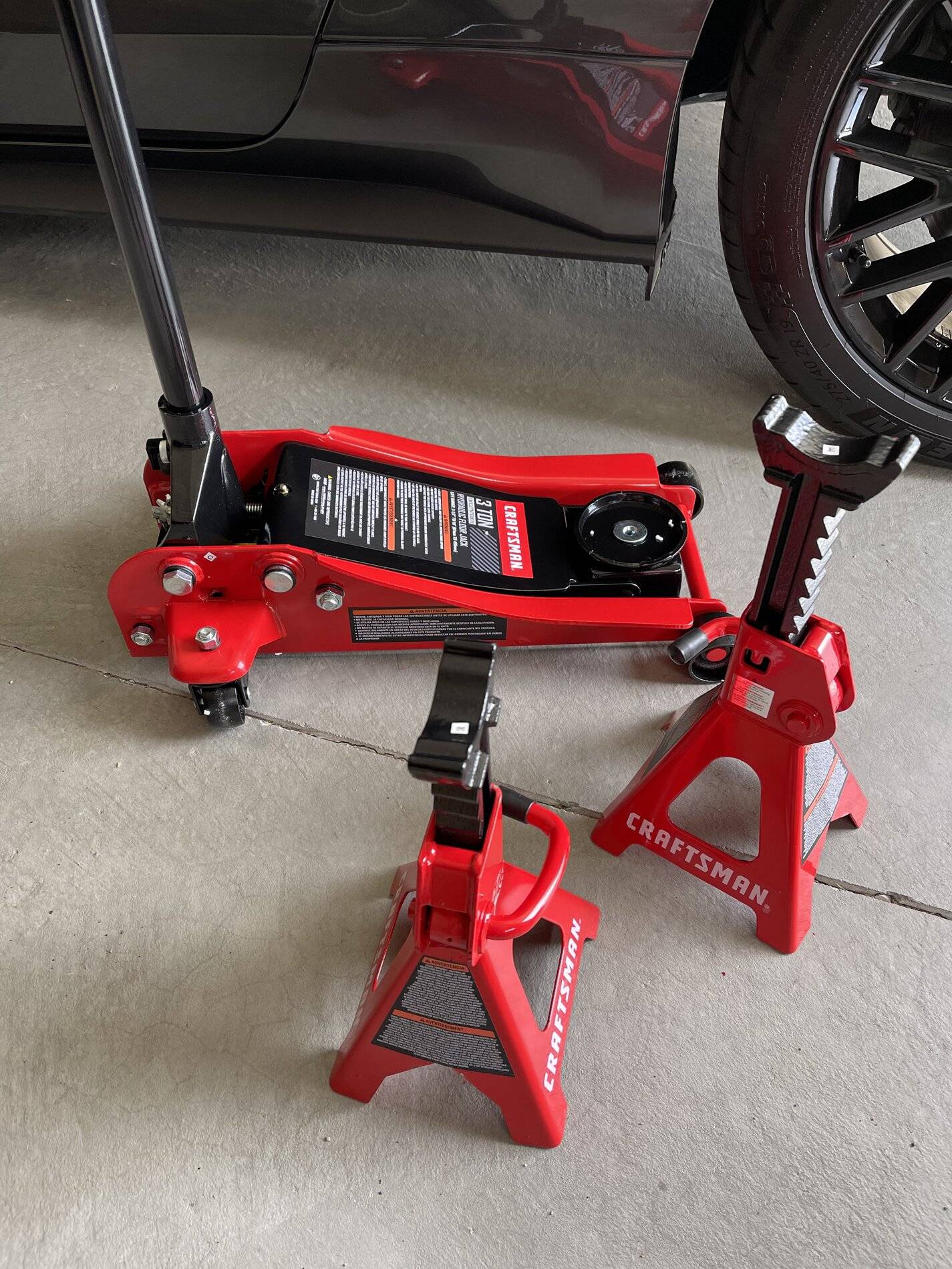

So I ended up with this great low-profile, 3 ton Crafstman kit: https://www.lowes.com/pd/CRAFTSMAN-Craftsman-3T-Floor-Jack-and-3T-Jack-Studs/5001651821
It’s pretty dang nice and can go from 3 inches to 18 - which is beyond all the other budgetish jacks I looked at.
The kit comes with two 3 ton stands too - all for $185.
I used it today to take the rear wheels off to install some rock guards. Here’s a pic of (odd angle makes it look small - it’s actually the largest and heaviest jack I’ve personally used):
Thanks everyone for all of the good info!
