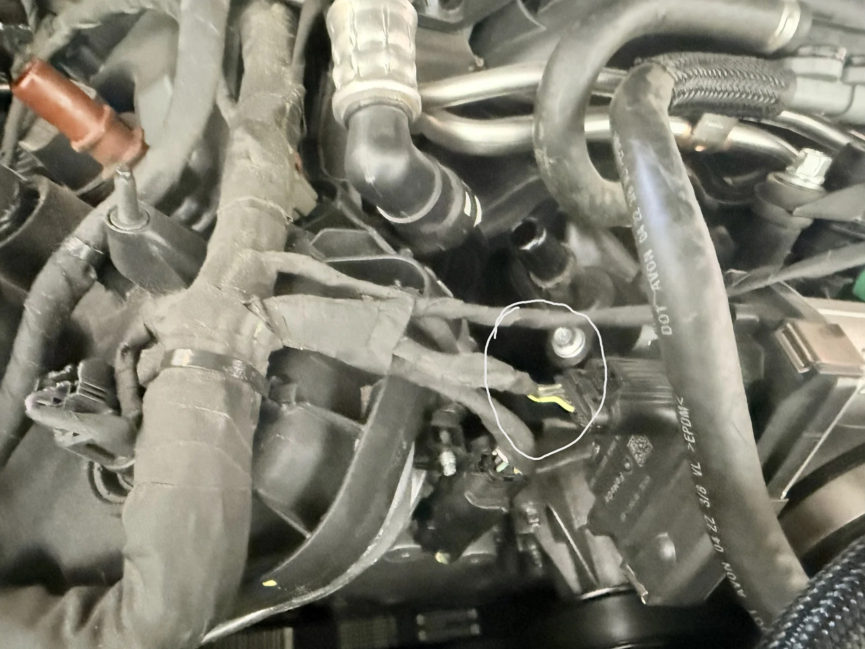

For those with a Mach 1 how did you install the J&L oil separator without letting it sit down on those wires and has anyone found one that connects without touching the wires?

You don't. It's a poor design. Personally I would go with any other product on the market (I had the J&Ls). Poor design, small capacity, and they hang off the plastic PCV. It just feels like a recipe for a stress failure.

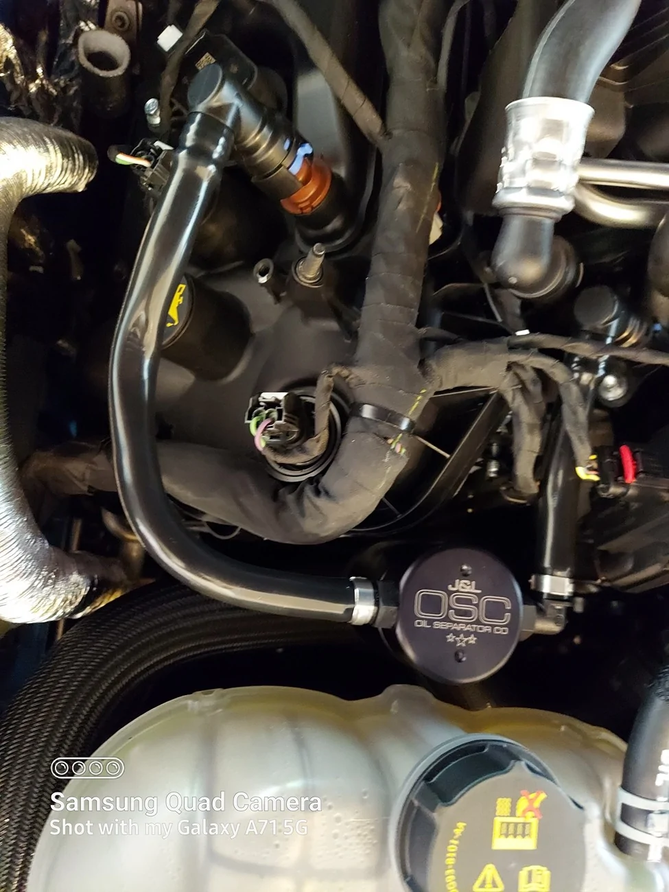

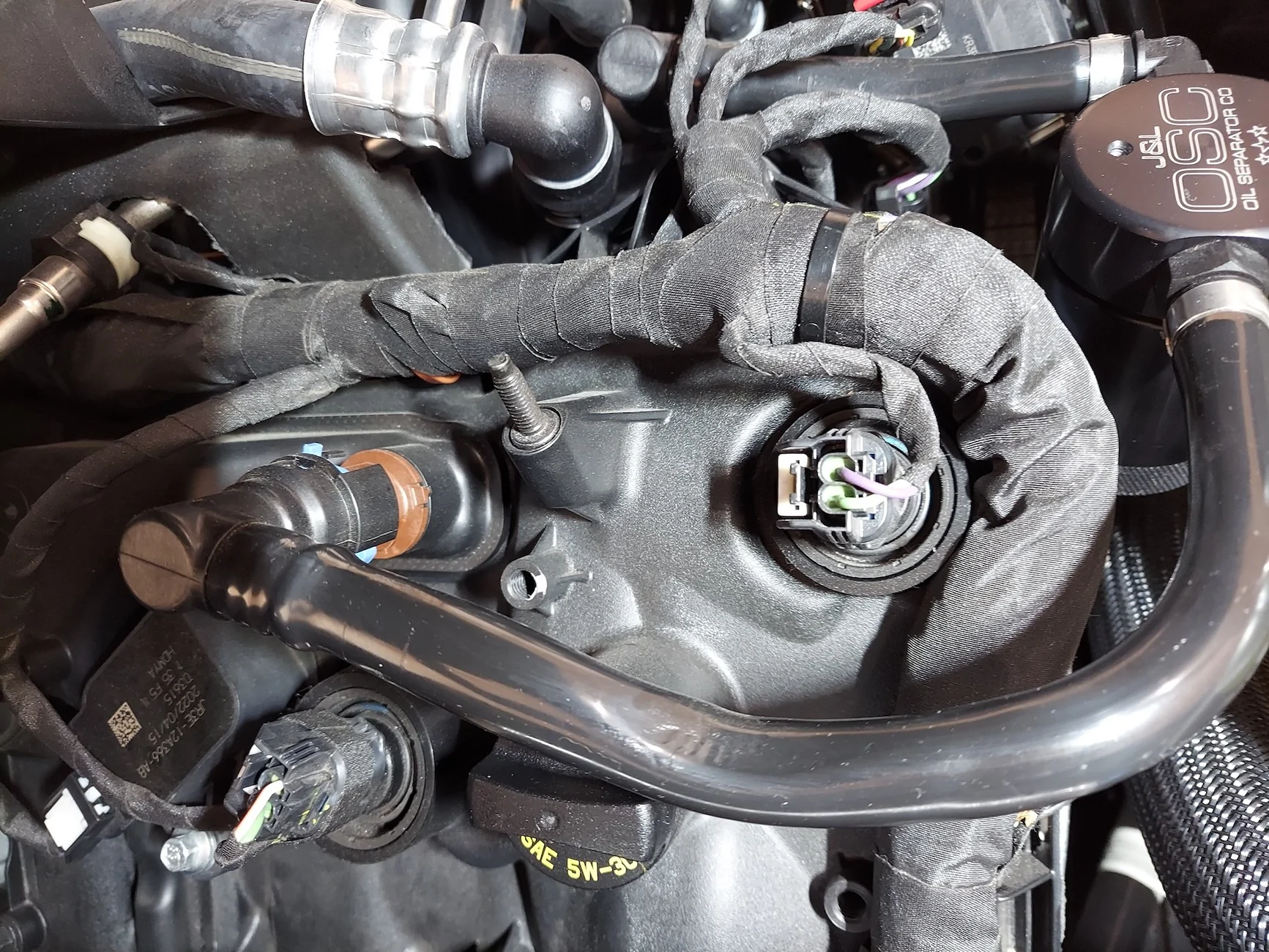

This is how I installed my J&L. I removed the one connection your interested in, installed the can, then put the plug back in-place. The plug and wiring rest above the tubing.
The tubing and can are pretty light. Nothing seems to be stressed. I remove the can twice a year to empty.
Some do prefer the Ford Performance can.
Same here.
