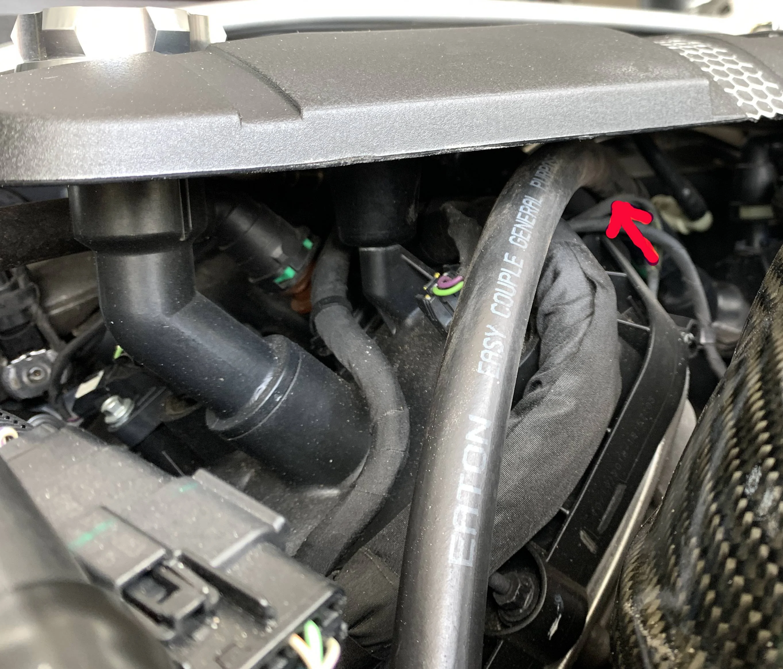

Love the easy access of the JLT bracket mounted reservoir, as it is relatively easy to empty at oil changes with no mess. But I appreciate the OP bringing the chafing issue up, as I didn't realize the chafing issue I had under the engine cover with nearby electrical wires.

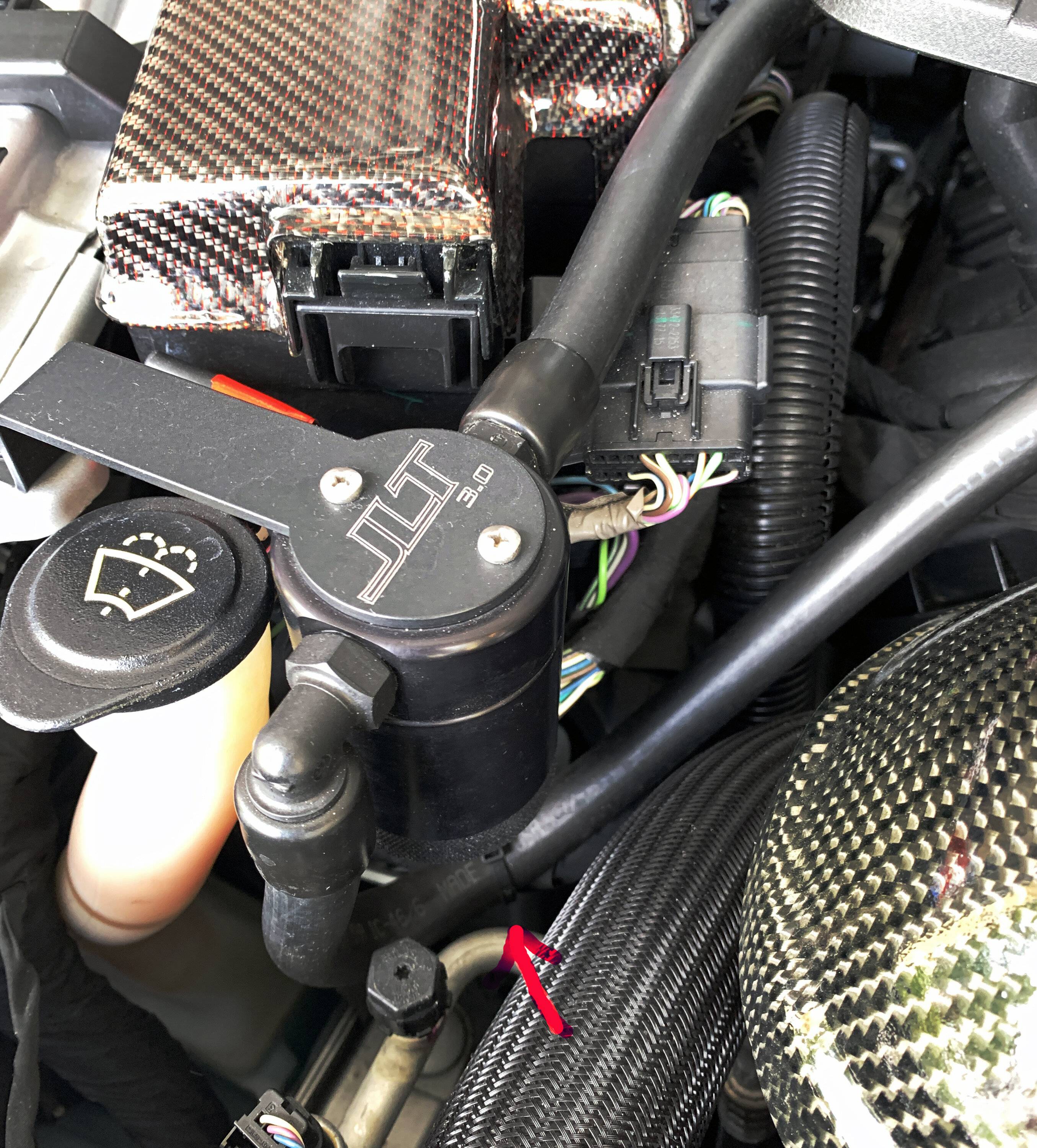

When initially installing the JLT I had significant chafing against the AC condenser line. I installed cable tie securing the hose to a nearby harness to prevent chafing with the AC line, and of course with the harness I secured it too.
I would have preferred a shorter hose to go straight from the reservoir to the intake, eliminating the looping. But then I hated to cut into JLT's hose.
