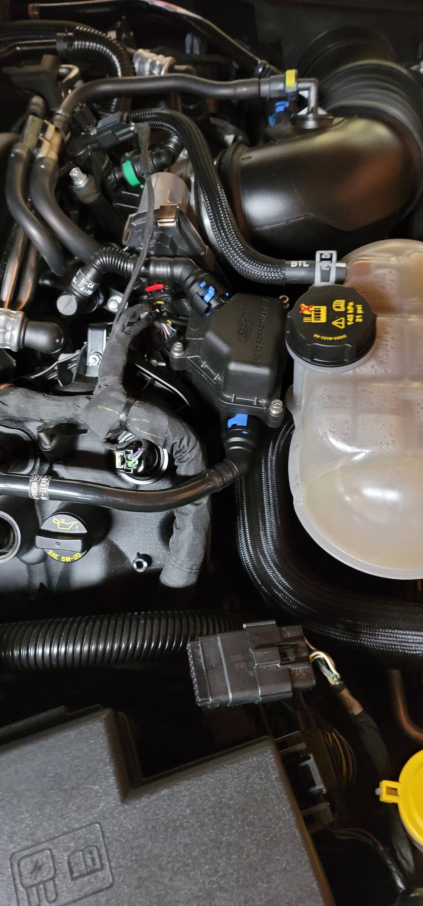

I did the Ford Performance one(s)primarily to retain the OEM appearance in the engine bay, and if you are wondering where the driver's side unit is, its still in the box as it is for a GT350 and one of the hoses needs to be reworked to fit on the 5.0 but its on the "to do list" along with the differential bushing kit also still in the box
Is this the part M-6766-A50A you bought?

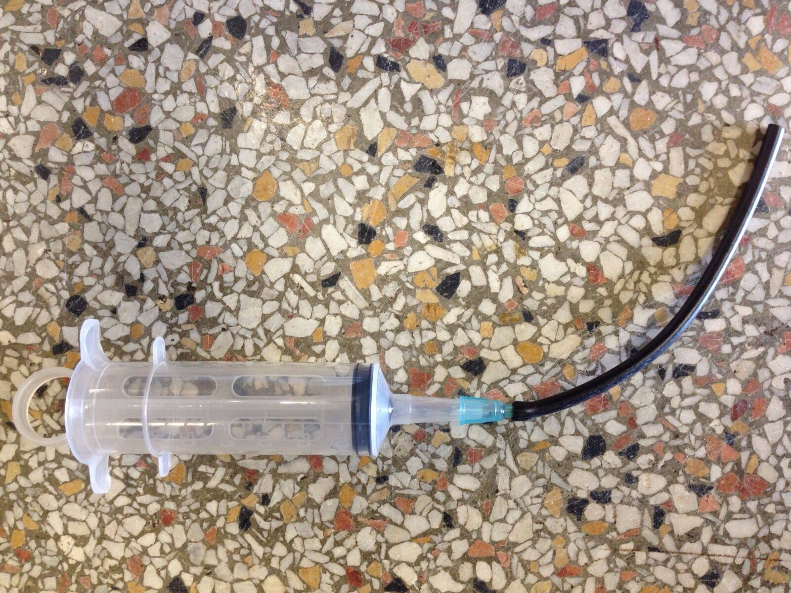

To drain mine, I purchased this small syphon https://www.ebay.com/itm/131238845062 and syphon through the input side. Very simple as there's maybe only 1-3 oz, depending on the way you drive.
Not answering for @Beaujangles what he bought, but you should get the part you quote. Be sure it has A at the end, as there is an older version without A with slightly different mount (which can be used though).
