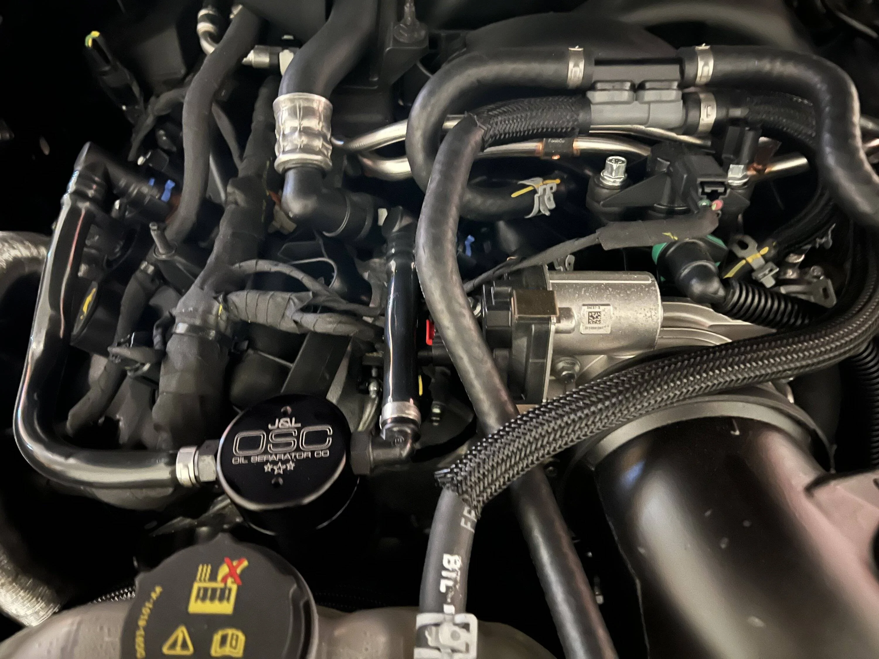

Does anyone else have this issue with the hose touching wires? I have the hose on top of the wires and it is touching them and then I ran the hose underneath and still touching wires. Is this ok for the wires?

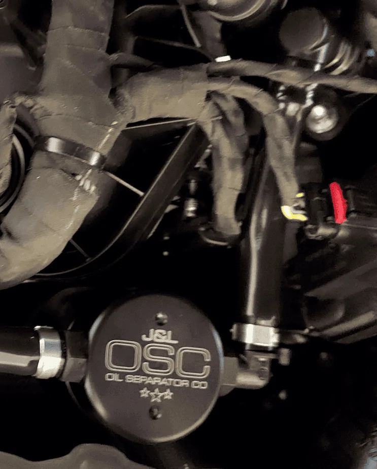

Attached is how I ran mine.
Gently disconnecting the plug with the red fastener, I put it as shown, with two bundles above and the larger one below; it gives me a bit of a gap amongst all the bits.
Nothing touching or rubbing. No issues in a bit over a year. Nothing moves. It just sits there.
The material is a bit easier to work with while the engine is warm. You can shape or adjust.

Just did it that way, wow it does not leave much movement room so hopefully it does not move.

FWIW, mine has been OK. No signs of shifting, moving or rubbing. The gaps between all the pieces have stayed. Once I got the items initially setup, I never had to go back and re-adjust. Ford (and other makers nowadays) don't leave a lot of room amongst the mechanicals. Excess costs a lot when producing millions of vehicles; it encourages everyone to keep things to a minimum.

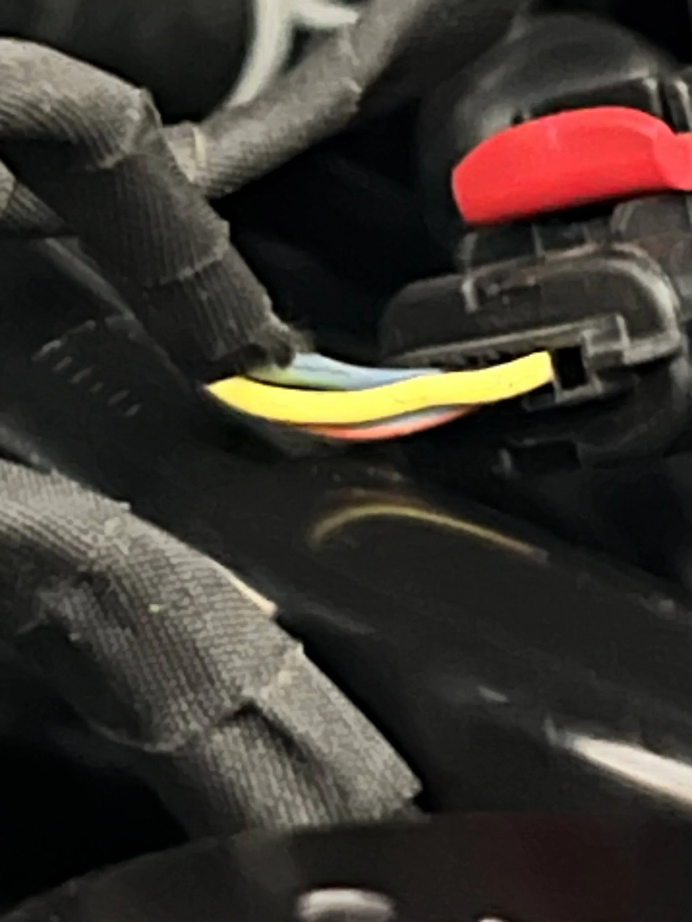

Do you have the part number of that red clip, yea, it fell into nothingness.

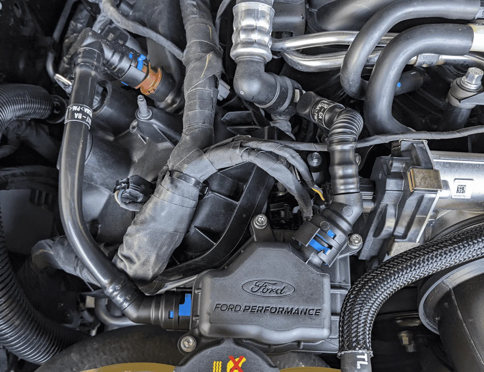

Good reason to use the ford racing parts. Designed by ford to fit correctly with bracket to support the separator instead of relying on the hoses

It seems like the red clip is an easy off/on and maybe secondary lock because the plug still locks into place.
Sorry to hear what happened. Glad to hear you got everything reconnected. The battery cover connectors have been my fastener of choice to lose in the engine bay.
I don't think you can purchase clips by themselves. Next time you are in the area of the dealer, stop in and explain yourself.
1) Someone whose previously done warranty work might scavenge such things and hold some.
2) Check with parts. Ford does sell pig tail kits for some sockets, for repair/replacements. You might be able to buy one plug assembly, taking the clip from it.

I am not super worried now as long as the plug can lock without it which it seems it can do though I will keep looking for that stupid red clip for sale.

that Ford Performance one looks like a PITA to install and drain though. Do you have to completely unhook it to drain it? Thought you had to disconnect lines to install it too. I don't think I need a catch can anyways with my relatively normal driving.
