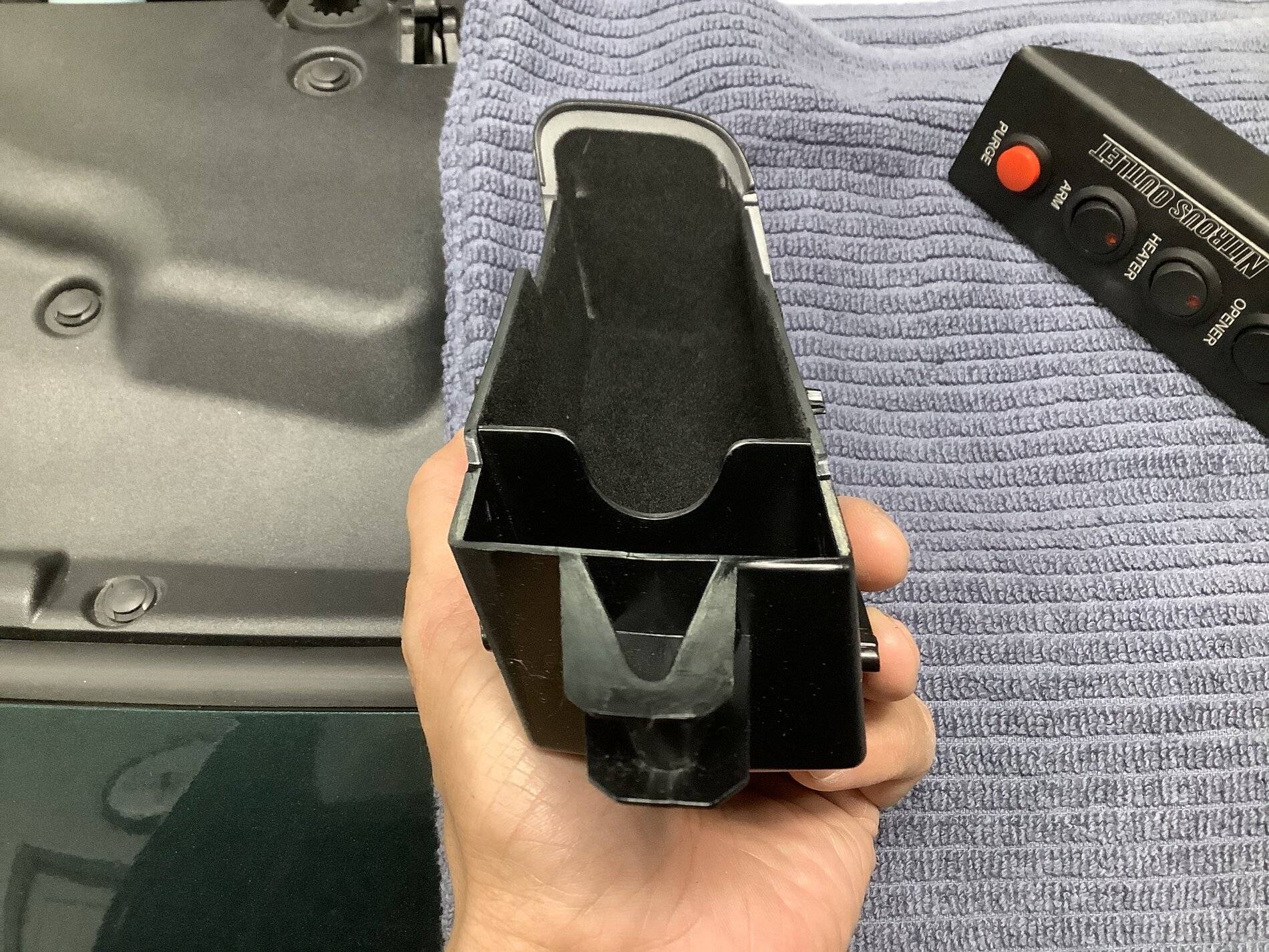

The other option is what VictorH did (notched the pinch weld). If I had gone this route, I would have used a Dremel with a round grinding stone to make a larger U-channel, (similar to what you see in this pic of my sunglasses holder tray) and spray paint the area with rust proof black paint.
