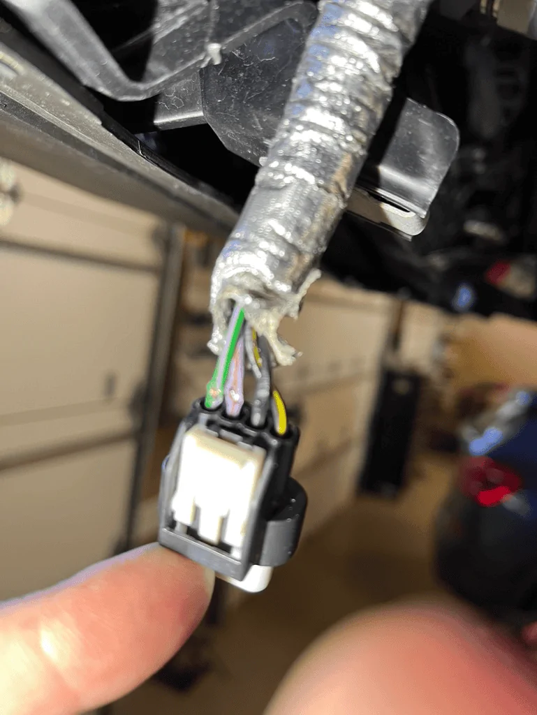

Voting same issue. Here's my car at 1,200 miles, popped the fuse.
what fuse did it pop? I don't see one listed for active exhaust. Also, are these the wires that hang right near the mufflers behind the diffuser? Neither of them look melted or pinched.

Fuse #34, "exhaust valves"

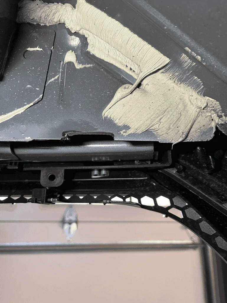

This is the connector that plugs into the exhaust valves behind the diffuser, very tight back there and really poorly positioned so they rub on a pinch weld in back. My solution.
What is this stuff?
I wonder if the person who smears that seam sealer like that is proud of his/her work. SMDH

2019 Bullitt
They all look that way, just slapped on. Employees taking absolutely no pride in how things are done.
