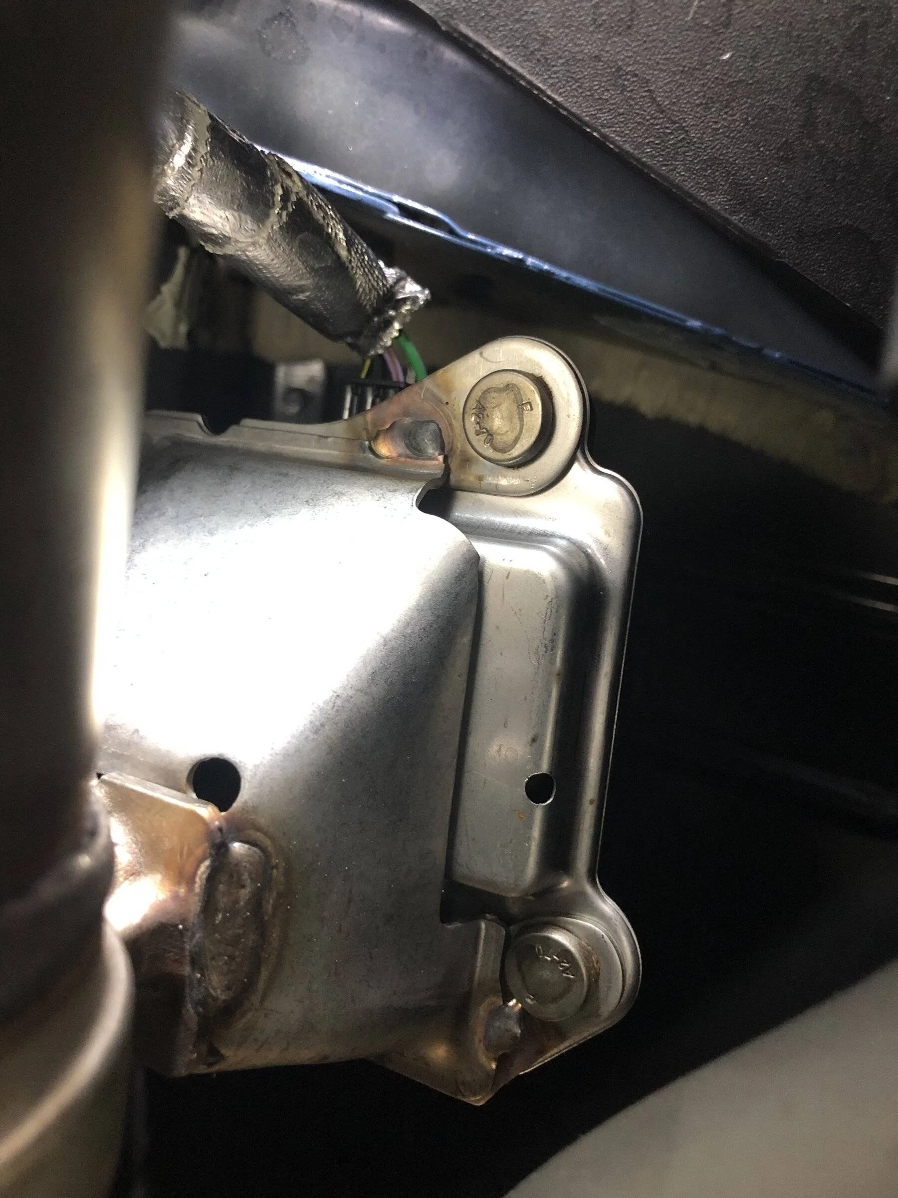

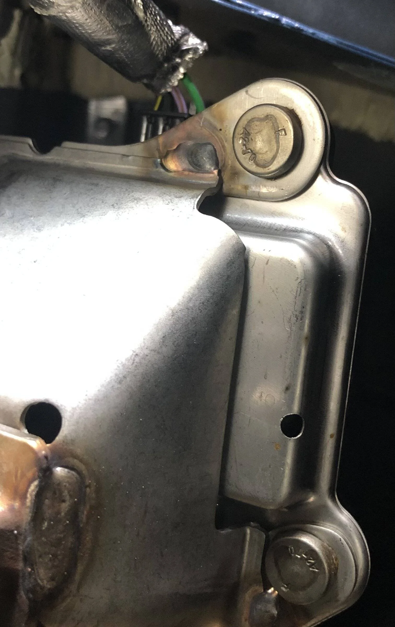

Since I was putting wheels/tires back on for the driving season today & car was on jack stands, I looked up into this area because I’ve seen this post and wanted to know if it existed on my car. So, from where the wires and plug come from actuator (right side muffler) and route around things, there is at least 1 “ of clearance around all over with no signs of interference anywhere. The plug itself is not perpendicular to the pinch weld but rather parallel to pinch weld rail. It’s a tight squeeze with the muffler attached but as much as i can see and or feel, this issue might have been addressed by the time my car was assembled.

That’s good to hear! It sounds like you’re in the clear then. Can you post a pic of it?

I’ll try but damn, its tight in there with the muffler attached. I’ll go out later and try to get the best possible image I can & post it up.

I stand corrected. The plug is perpendicular to the pinch weld rail but mine is at least 1” away.

It definitely looks like you’re good and shouldn’t have any problems out of yours. I’ve never seen an AE car with that much clearance before. You can rest easy my friend.

Yes, plenty of clearance. Maybe, just maybe someone seen this on the line & made a suggestion or a manufacturing engineer was alerted ?? My HP was a early August 2021 build so it’s possible Ford was on to correcting the issue by then. Thanks for the well wishes and back at ya.
