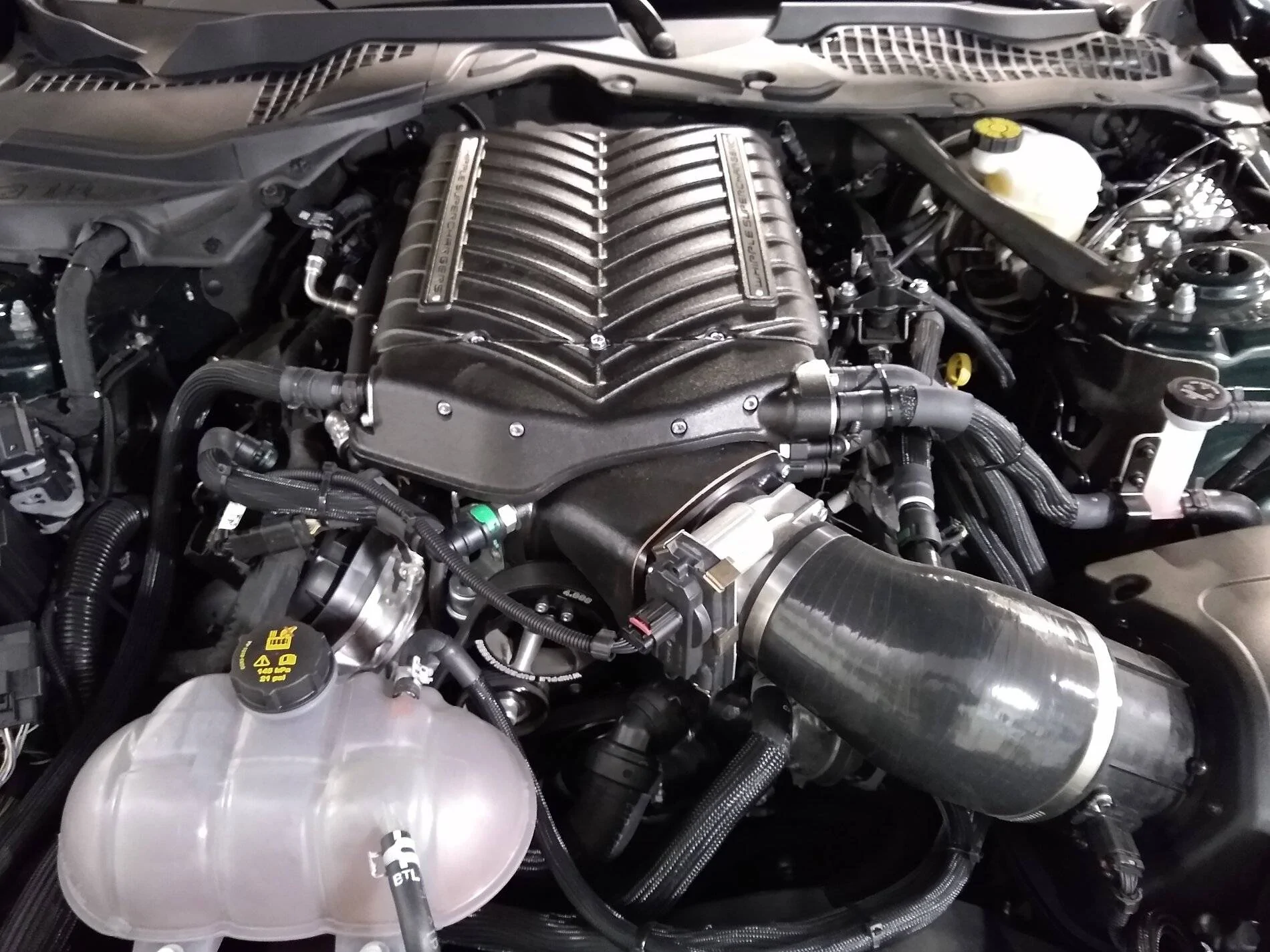

I installed the Whipple stage 1 kit on my 2019 Bullitt. It came with Whipple's 91 octane tune which was supposed to be 50 state legal. It made 675 RWHP SAE at 7,800 RPM and actually ran smoother than the Bullitt did stock. Since the M1 is basically the same engine I would assume similar results.
An even better kit than Roush's. I strongly encourage you to go for it!!!

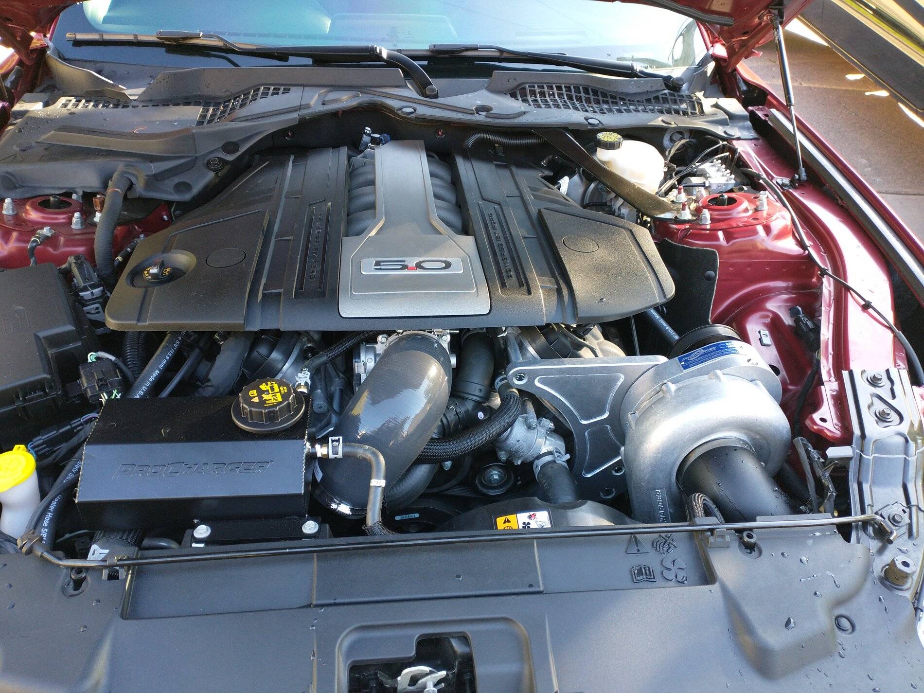

To complicate things, there is the Procharger. If you look at the procharger HO kit with Procharger's tune on 6 PSI boost my 10R80 made 525 RWHP at 7K RPM. This was the super safe 91 octane tune.
I took the car to my local shop, the same one which dyno'd the Bullitt 2 years ago and the owner said he quit selling centi blowers because they has issues in tuning. He was truly amazed in the tune and we drove the car for about 6 miles. His comment, and he owns a Hellcat and GT500 was, that the car ran great and would likely do very low 11s or possibly high 10s. And he is at the dragstrip almost every weekend. An older guy with real car knowledge.
I since then did injectors, pulley, PBD tune, etc. and the car still runs excellent. The best part is that you don't give up the strut tower brace, but you do give up the stiffeners in the grille. Plus the install takes literally 1/3 the time of the Whipple.
Just food for thought. A couple of photos:

Also quite a bit lighter right?
But very different characteristics

There are definitely benefits to either route. You have to wind out the procharger, but with traction being limitation regardless, it can be a positive.
I've done turbo, twin screw, and centrifugal and all have their benefits. Centrifugal has the most predictable and easy to control power band.

Whipple is not as bad as some think on weight. Net weight change, and I weighted my car right before and right after on the same scale came in at +92 pounds. I honestly couldn't feel it but the added torque accelerating out of the corners trumped that, I believe. The newer Mustangs have a stiffener near the firewall which I believe is good enough without the strut brace, so I don't think it hurts handling much.
