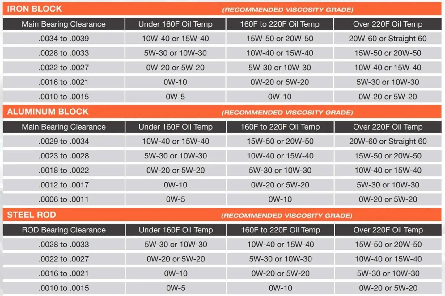

what happens is when over reving the coyote you suck the oil pan dry. if you check the clearance on the bearings the coyote normally should use a 40 weight so 0w40 or 5w40. there's always exceptions
Show me where a 40WT is recommended by any engine machinist for a main bearing clearance of .0009-.0016"
