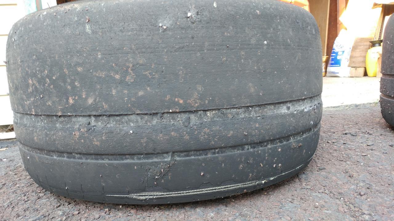

7K?! Those are rookie numbers in the bracket! :lol:
On a serious note, you had inner tire wear on 7k miles with the MPSS? That's interesting...would expect that on 20K+
I know. :D But no Uneven wear though so that was good anyway I guess.

Krman68
Mar 4, 2015
96
31
Doylestown, Pa
18 GT350, 68 GT500KR
I had a ā€˜13 GT500 that did the same with stock alignment of -1.0 The camber couldn’t be adjusted w/o plates. I suspect the 350 is the same so on the street it will wear the inner tire
MrCincinnati
Jun 20, 2017
895
474
Cincinnati
2017 GT350R
4 hours of track time and ~1500 street miles
I'm not all that impressed that the inner edge corded. My alignment isn't at all aggressive. Oh well.
My PSS are showing the same inner edge wear, but they have ~10k miles.
And here I was hoping I’d get 4-5k street plus 8 20min track sessions out of a set. :doh:
DocWalt
Jun 20, 2017
447
191
SE PA
GT350
Depends on the track. I was on pace for that after my outing at VIR. I went to NYST and shredded them in 6 20 minute sessions :( Outside shoulder has some life left which is why I'm surprised the insides died. Odd that the grooves on the inner shoulder are at cord height.
I'm not easy on equipment. If you're not pushing the car 10/10ths you won't have to worry about it.
MrCincinnati
Jun 20, 2017
895
474
Cincinnati
2017 GT350R
Good to know. I won’t be 10/10ths, yet. First track weekend ever so, despite my ego, I’ll be happy if by Sunday I’m running just a bit harder than this guy:
honeybadger
Just don't care
Apr 20, 2016
63
4,098
7,446
COTA
Kevin
'17 GT350
I ran 5k street miles and 10 track days on my OEM MPSS. If you’re running -1.7 front camber, 33 PSI hot, and focus on being smoother vs. aggressive, you’ll get plenty of life out them. Just don’t overdrive the car and watch your tire pressures.
Tomster
Beware of idiots
Feb 20, 2016
288
16,073
17,110
Tom
Each type of track has own alignment settings that work. I monitor and maintain my tire pressures and also monitor tire temps. Adjust toe and camber as needed. There is no magic setting for all tracks that works 100% of the time. A lot of folks go bonkers on negative camber, but more maneuvering traction equates to less tire life. I don't believe seeing cords in a tire is normal or ok especially at the level of driving and skills us commoners possess. Get a proper alignment snd save your tires for another track day.

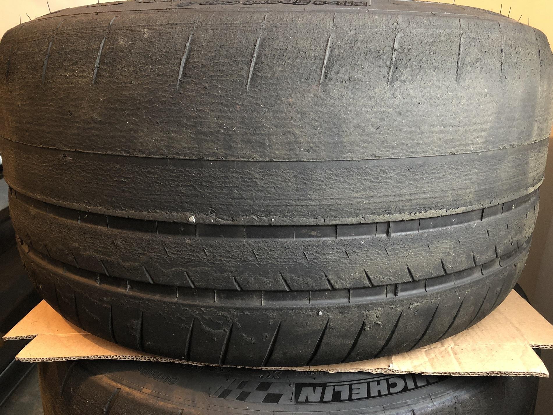

petstang
Sep 29, 2015
230
100
Central NJ
Peter
Ford Mustang GT350 TP Magnetic w OTT Black Stripes
Need some advise please...did 4 sessions of 30 mins with -2.5 camber with these SC2's.
Would you think I can do another track day with them ? This is the left front tire and by far the worst. Thanks for the advise.

nastang87xx
Jun 5, 2015
94
6,550
4,170
San Diego, CA
2016 GT350 Track Pack
I wouldn't. But hey you're using them for they're there for! :thumbsup:

DocWalt
Jun 20, 2017
447
191
SE PA
GT350
Send it. :headbang:
If the next track is predominantly right hand corners run that on the right front.
