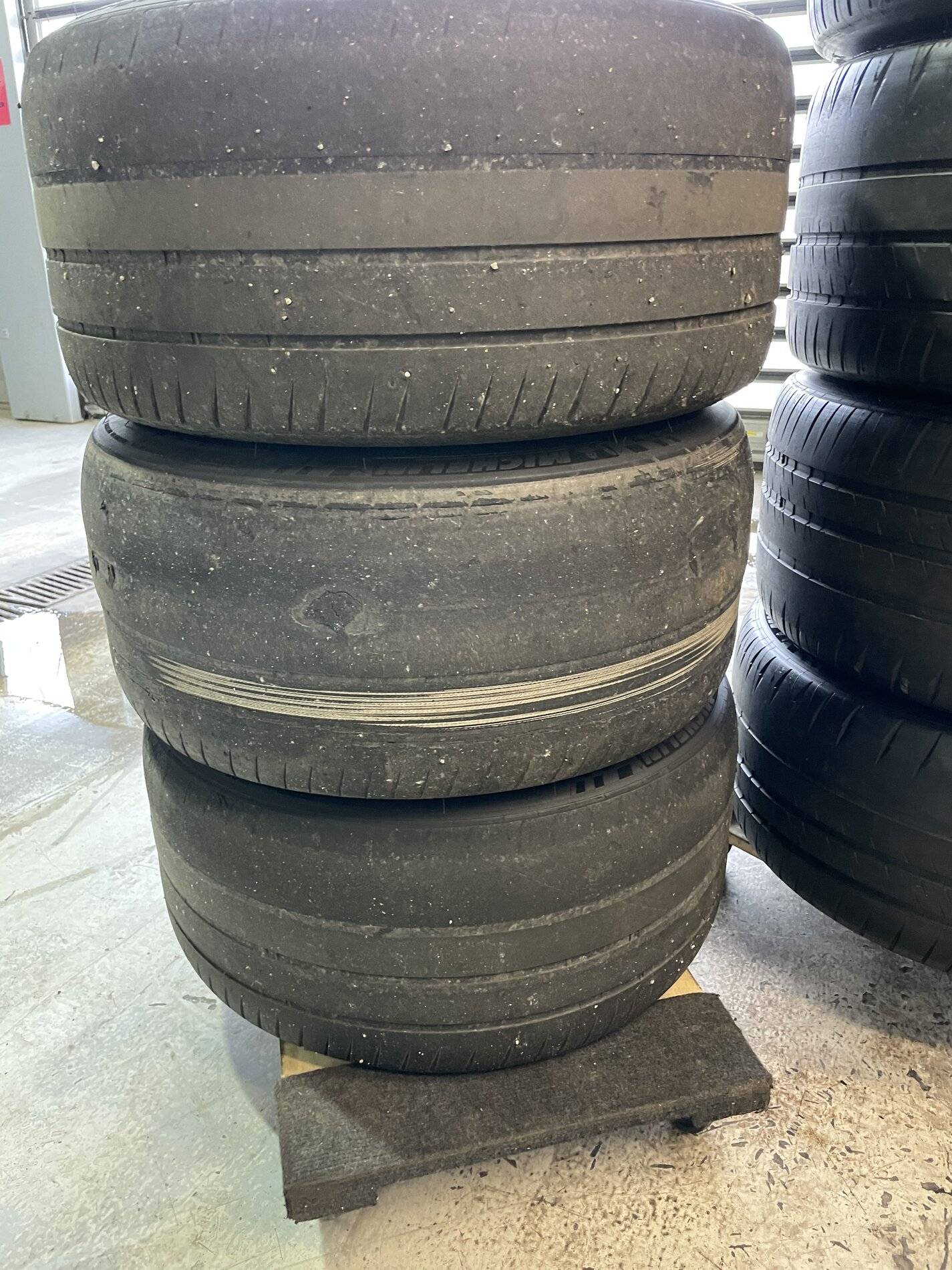

I just swapped tires and got realigned a few hours ago. The tire in the middle is one of my fronts, the other two are rears. I’ll admit... the fronts were looking pretty rough. Those tires represent about 300 street miles, and 10 hours on track with a healthy amount of negative camber.

Getting an alignment would certainly be helpful, and no you don’t need camber plates to make the adjustments. Until you get an alignment, it’s just a guess what setting, if any, is off.
Since you have a ‘19 I'm assuming you have cup 2’s, which have a super low mileage rating as it is. My tires have never lasted more than 1,000 miles so I can’t speak from experience, but I seemed to remember reading that street driving guys saying to expect 6,000-8,000 miles out of cup 2’s. Also, if I remember correctly, the outer 1/3 of the cup 2 is a softer compound than the inner and middle 1/3, meaning it’ll wear faster than the rest of the tire.
That top tire looks very familiar!
Ha!
To be honest, without seeing your tires, your likely experiencing normal wear. Post a pic maybe?
The top and bottom tire in that picture had heat cycled out, or I would have run them another day. Decent amount of meat left.
