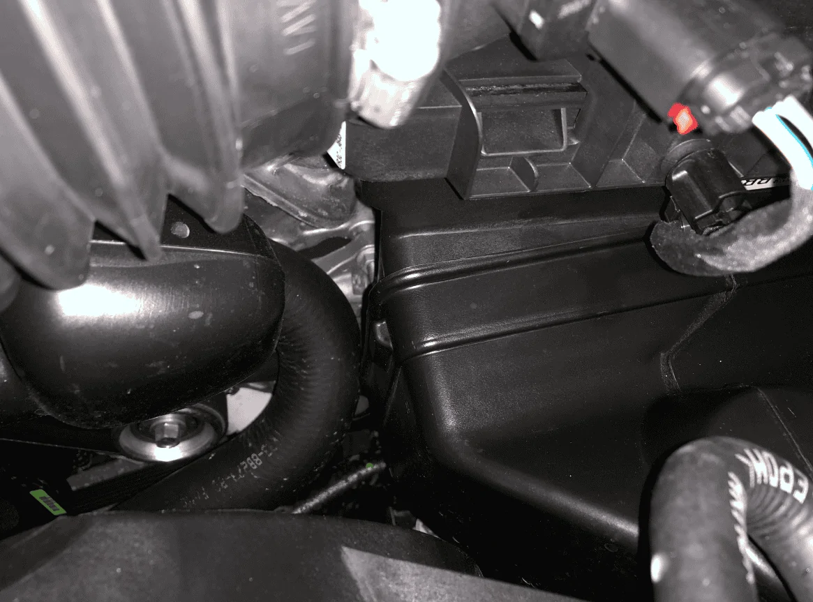

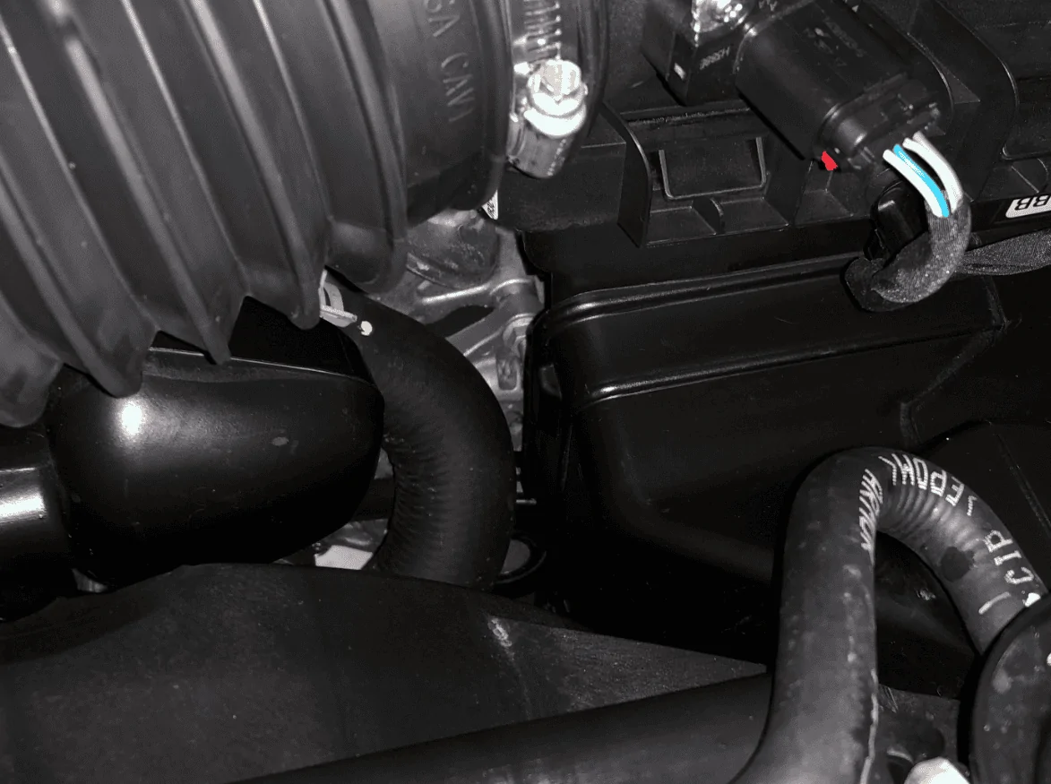

The only thing I can offer is that something got moved / dislodged.
Here is how my intake came from the factory :
i.e. dislodged on the upper left side. Although the photo doesn't show it well due to the angle, it allows hot engine bay air to enter all around that top left hand corner.
Heres how it looks now :
There are barbs on the intake and filter box that should snap together to hold the two items snuggly in place.
Hope you get it sorted :like:

I mean it's not my imagination since the numbers are actually different. I didn't think it was something serious, it was just something I noticed and wanted to ask about.
WD :like:
The 3 barbs that face the front are in place and the 2 clips went on.
