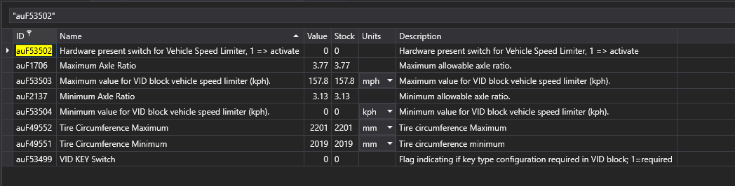

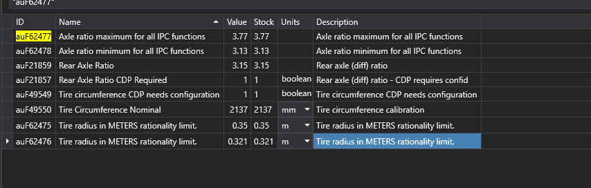

I had the same gear ratio so I didnt have to change anything. There is a special function for speedometer calibration that hptuners has, same type of function like crank relearn. PCM tec doesn’t have functions like that as far as I know but you can change speedometer settings in the tune file.
Ive tried playing with the speedometer calibration but I would need to watch the digital readout on a logger in real time to tell if it’s accurate or not.
The car has some learning features for the speedometer and tire sizes. I’m not sure how it identifies that it needs to make a change and how it determines what the correct values should be.
Later tonight I can pull up the options you would have with pcm tec. You could probably disable the learning but I don’t know if this is the technically correct route or if there may be another value you have to change.
