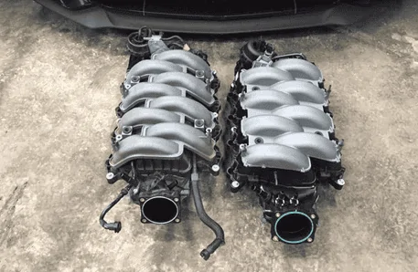

how would i know if ive got a gen 3 intake manifold?? in my 2016
WildHorse
N/A or GO HOME
Jun 28, 2017
270
10,297
8,350
Home World: CLASSIFIED
Puddintane
'17 S550
IMRC is different. Vacuum line routing is different. And the 15-17 engine cover won't work.

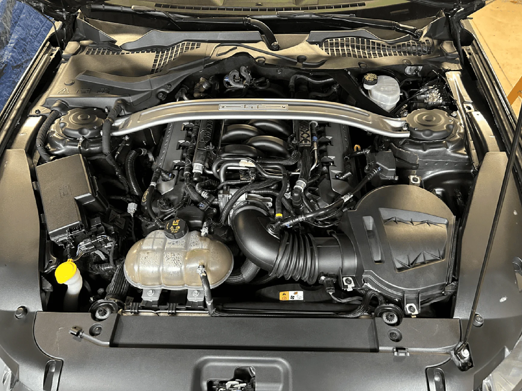

This is a GT350 intake manifold with a GT350 intake tube and a GT500 air box. This is on my 2016 GT.

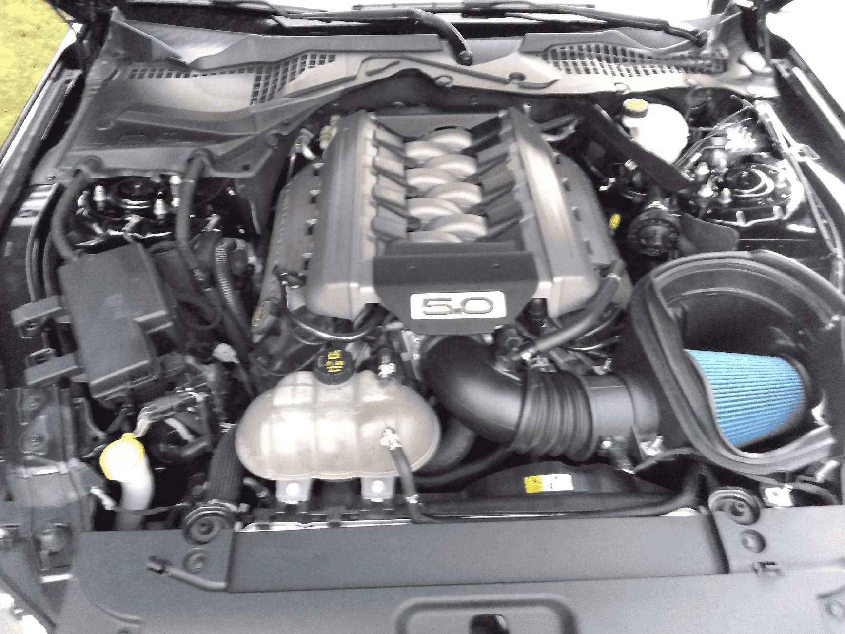

Looks stock, can't really tell with the cover in place.
However, the stock '16 cover won't fit the '18+ intake without some modifications. Click "mods" in my sig for more details...
I'd wager it's stock.

The intake manifold looks stock but that looks like a GT350 "hot" air intake tube and filter housing. You may have a GT350 throttle body and the PP2 programming. Can you post a closer pic of the throttle body?
