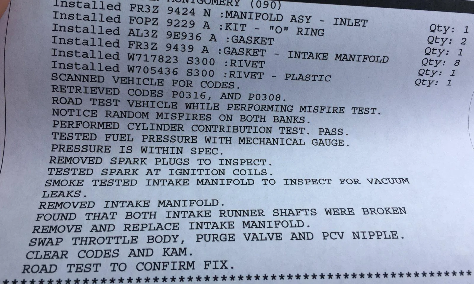

They fixed it. It turned out that both charge motion control valve shafts were broken as was the intake. It’s crazy that it resulted only in a little stumble. It’s interesting now that I lost quite a bit of snap crackle and popping in my exhaust after the fix. I kind of miss it lol.
Will post the new part numbers later.

Here is the work done on the intake. New part number is fr3z-9424-n

fr3z-9424-n is what they installed for me...and what they said was the latest revision.
Thanks millhouse! That’s the number I was seeing online, but wanted to confirm there wasn’t something newer.
