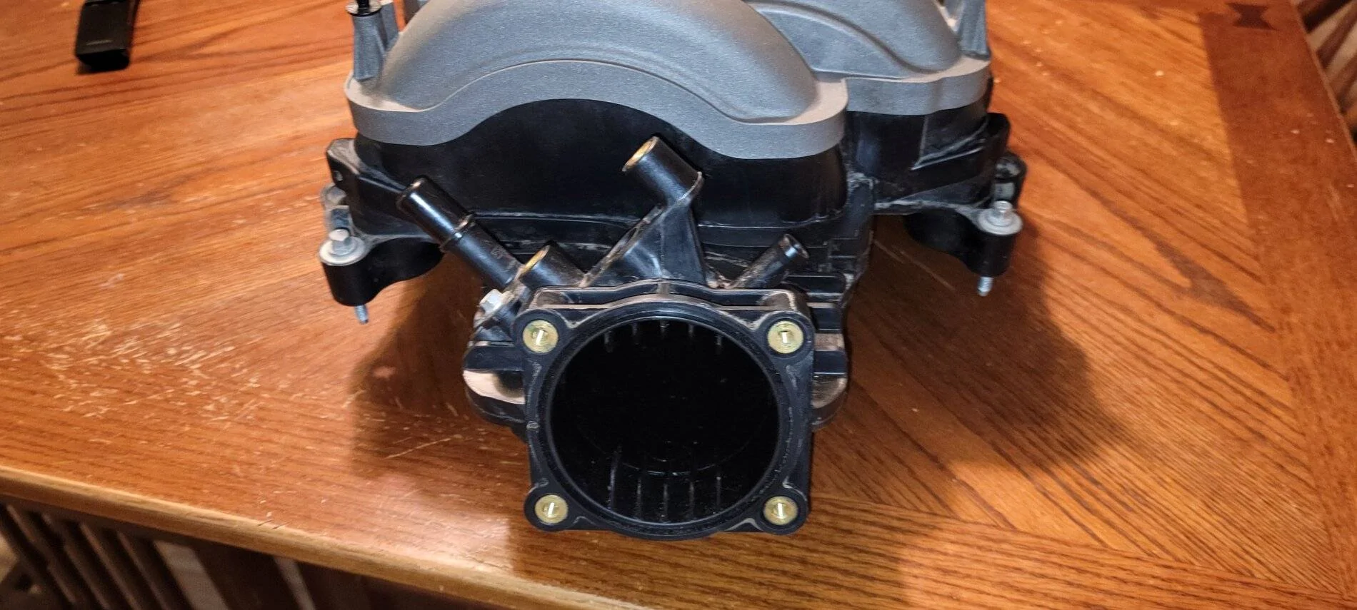

I think i got scammed.

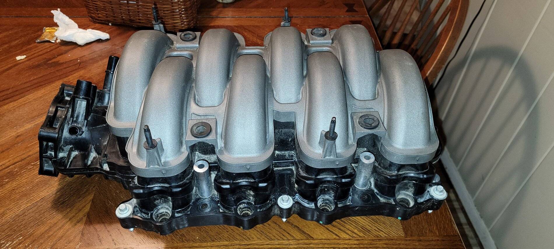

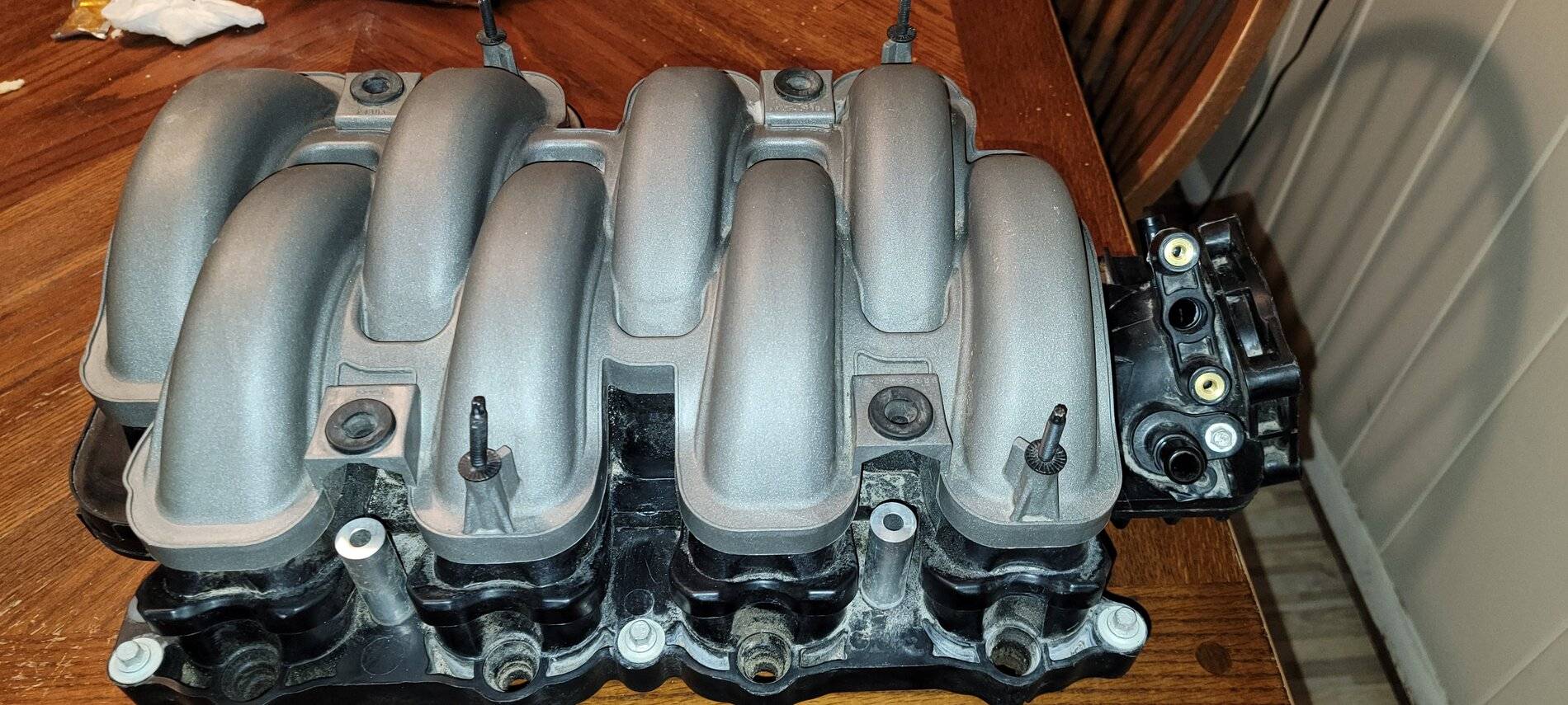

I bought a intake from a guy that tells me it was off a 2018 Gt could someone please tell me what I am dealing with it's most identical to my 2015 to after doing some research it seems like its off a 2011 not the 2018. The one still on the engine is the original and the one on the table is the so called 2018

Can already tell where the evap is that this is not a 2018 intake. Also missing the stuff in the back for the IMRC runners.

Is there a way to tell what year it's from ?

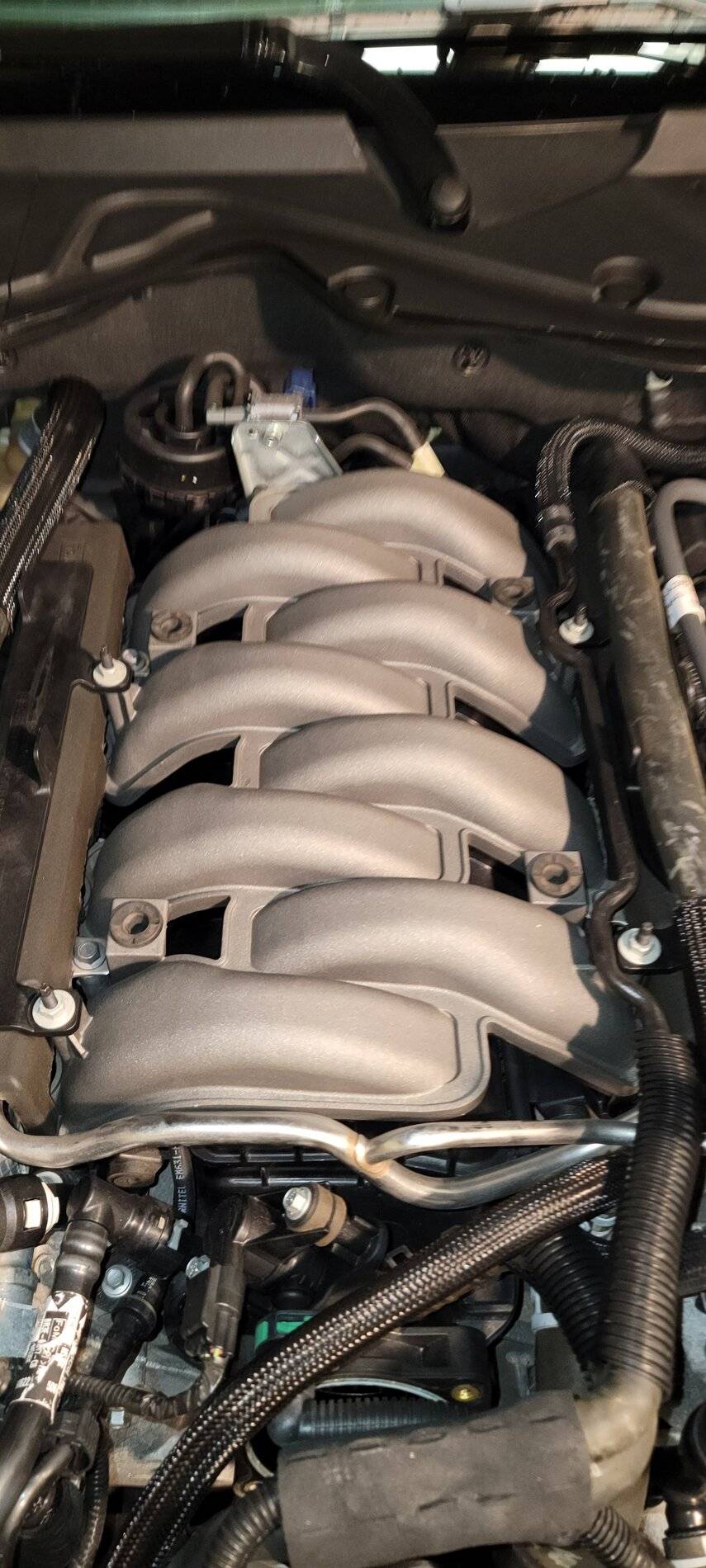

Fist picture with the EGR is my original and still on the car ..the one on the table is the one i think is wrong
Definitely based off the throttle body socket, its from a Gen 1 coyote. Sorry man you Definitely did get the wrong one, its either that or he legit accidentally gave you the wrong one since they look identical 🤷‍♂️🤷‍♂️ im sure if you go back you'll get your money 💰
