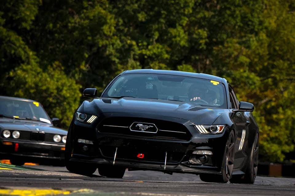

You need something just in case or you will get an A piller wrap. If you don't track often but need something just in case I did this for a single trackday before I converted to racecar. Use cable lock wraped at passenger front.
Wow, that is actually really cool, nice job!

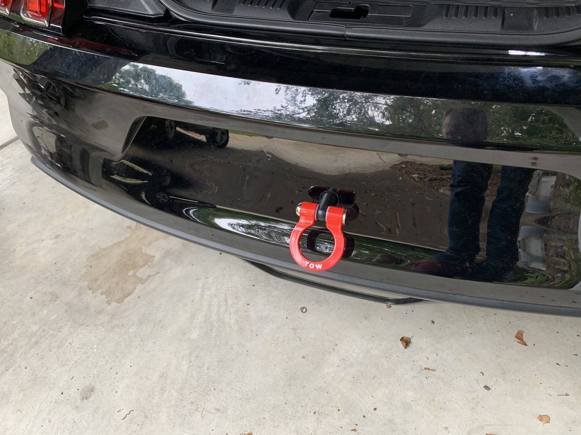

I chose the ZL1 addons tow hook for my S550 because it fits nicely and doesn't stick straight out like a tongue. It is also designed well and even has a little pad on the bottom of the hook so it doesn't ding up your bumper. Luckily I have not had to use it. <knock on wood!>
Update: I added a photo of my S550 so you can see how the tow hook looks on the front.

Looks like you have stolen my car..!!
ZL1 Add-ons front and rear for me..
Simply remove the plate and screw in the hook, hole through the bumper.
