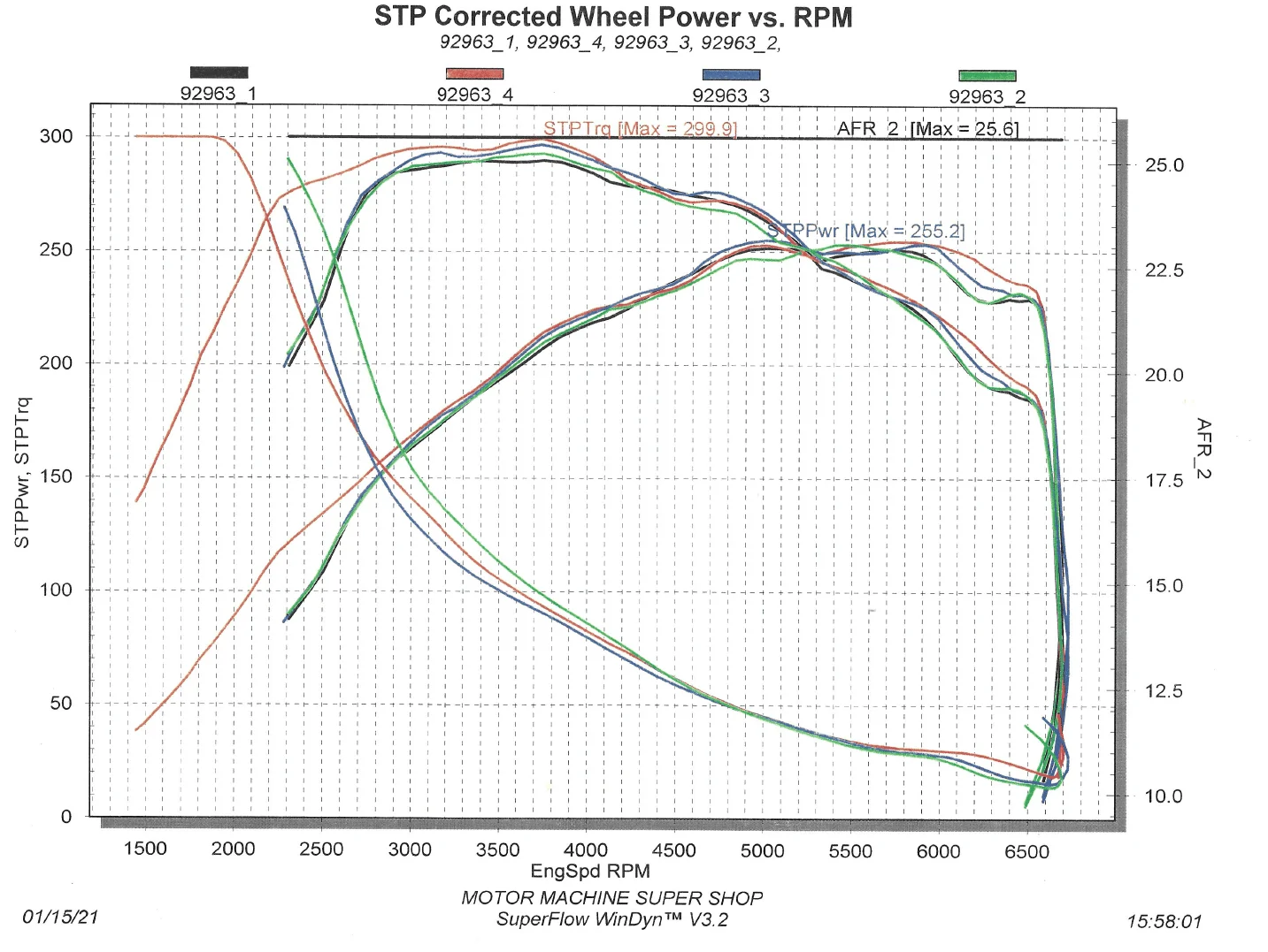

Finally got to have my HPP tested on a Super Flow eddy current dynamometer. It was about 65 F and I had 93 octane blend in the tank for about 150 miles. Usually I have 91 in the tank. Best torque pull was the 4th which started at 1.5K instead of 2.5K rpms and max'd at 299.9. Best HP was 255.2 at 4900 rpm on the third pull but the fourth pull had 254.9 at 5890 rpm. So it appears the tuning will give us more power if the intercooler was better.
A/R ratio looks incorrect but shows the addition of fuel to richen up the mixture as the incoming air gets hotter. Only mod is a Borla cat back with adjustable exhaust.
I think your numbers are pretty accurate as they're the same as I saw (within measurement error).
As far as the mapping goes, this is something I find quite negligent by Ford. With all the tools available it's unacceptable to produce a fuel curve that's this shit. I was able to do a better job with a salvage Holley double pump when I was 20 years old.
I will agree an intercooler & Ryan's base map really helps the higher revs, even on stock boost. Just keeping the mixture reasonable makes a big difference.

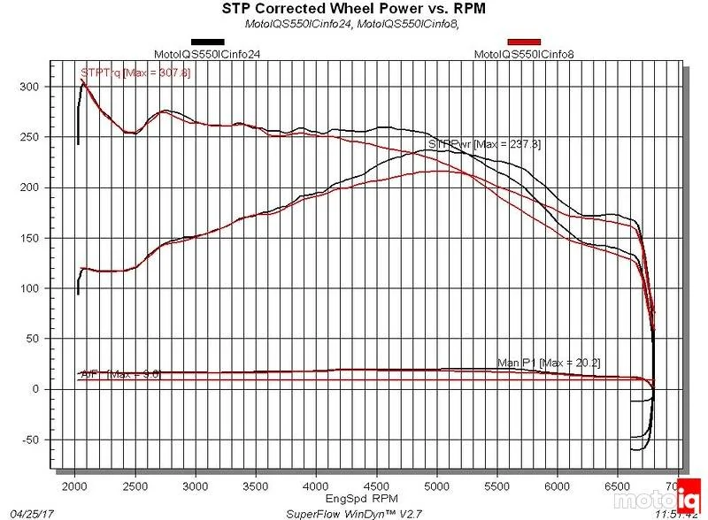

I wouldn’t pay attention to the numbers look at how much nicer the curve is after 4500rpm. This is also why even with mods a base Ecoboost isn’t very fast in the grand scheme of things. Reminds of the old 302s, where they would nose dive after 5000rpm

I have heard that Ford adds fuel to cool the exhaust temperature to keep the catalytic converter alive. Does anybody know if this is the reason why they way over rich the mixture later in the pull as the intake temp rise with the stock IC?
I am thinking of a turbo blanket to keep under hood temps lower but that will send more heat to the cat.
