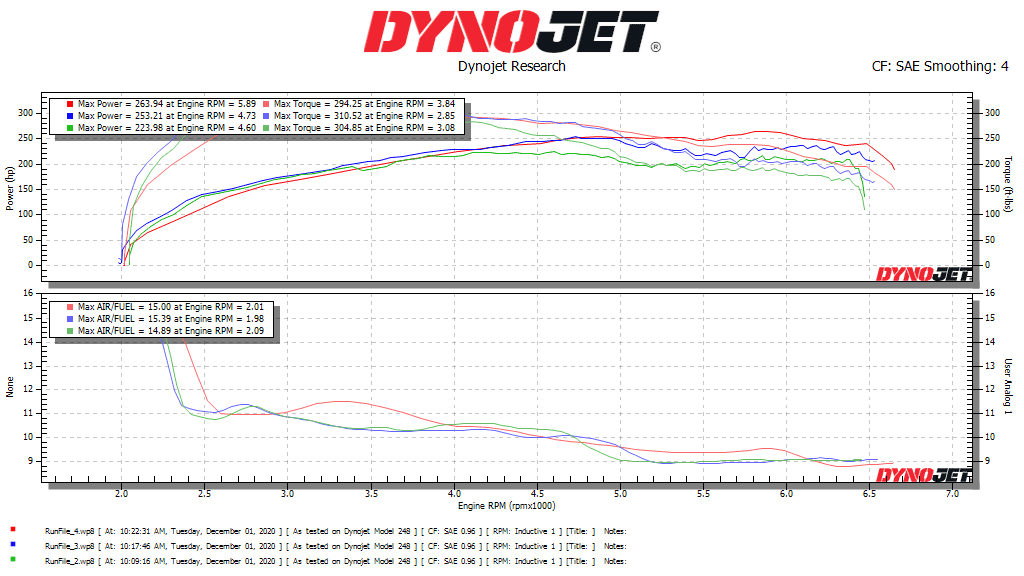

OK, folks, here's the real poop. This is my bone stock manual HPP with 3800 miles on the clock.
The blue and green runs are both in 4th gear. The blue was with the engine relatively cool and the green was shortly after (w/ a higher CHT at start). The red curve was cooled and run in 3rd gear.
The red shows 263 HP and 294 lbft. The torque comes in so early that in 3rd gear, there wasn't enough time to build more boost. It showed better torque in 4th at 310 lbft. The problem with the higher gear, after a few seconds WOT it would pull power and the run would go to junk. It happens at 5000 rpm on the blue curve and 3400 on the green one. The red curve is pretty much intact, but it seems like the torque curve could use some smoothing on the top. The time for the red pull was about 1/2 of the blue and green.
