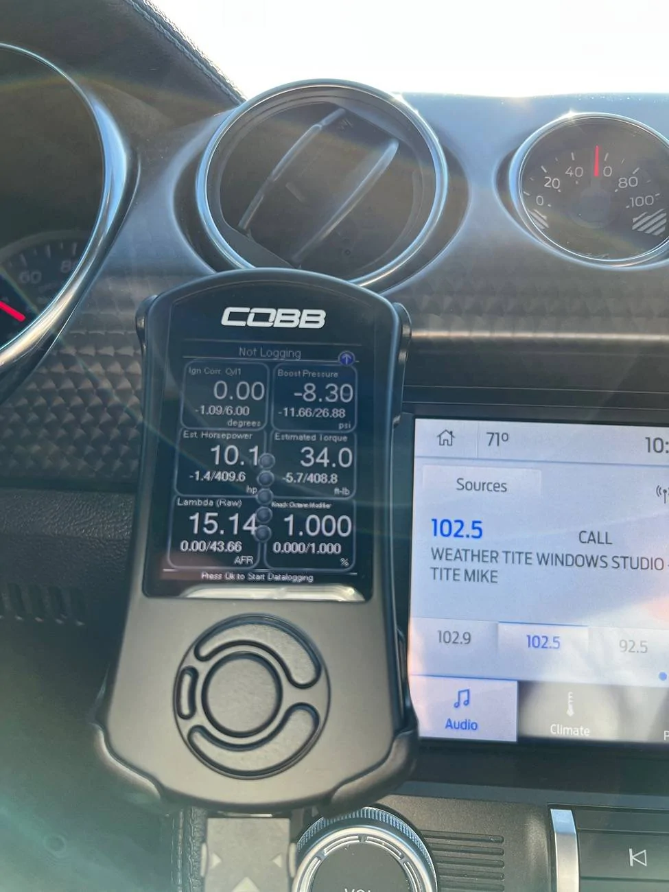

I have a 2021 HPP with a MAP Billet end tank intercooler, Roush closed lid cold air intake, Turbosmart blow off valve, running a COBB Access Port with the Stage 2 tune, the car runs fine and is wicked fast.
Here is a photo of the COBB read out after a full throttle run.
Not bad for a Focus RS derived 4 cylinder.
So i have the exact same set up as you. But I’m running the stage 1 tune. Was a little gun shy of running stage 2. Form some of the reviews. Could u tell a big difference between stage 1 and 2.
I tried the Stage 1 tune once over 2 1/2 years ago, I liked the stage 2 93 octane tune better and that is what I have been running since with no problems. From what I remember the stage 2 93 octane tune just felt better on my High Performance Package Mustang.
