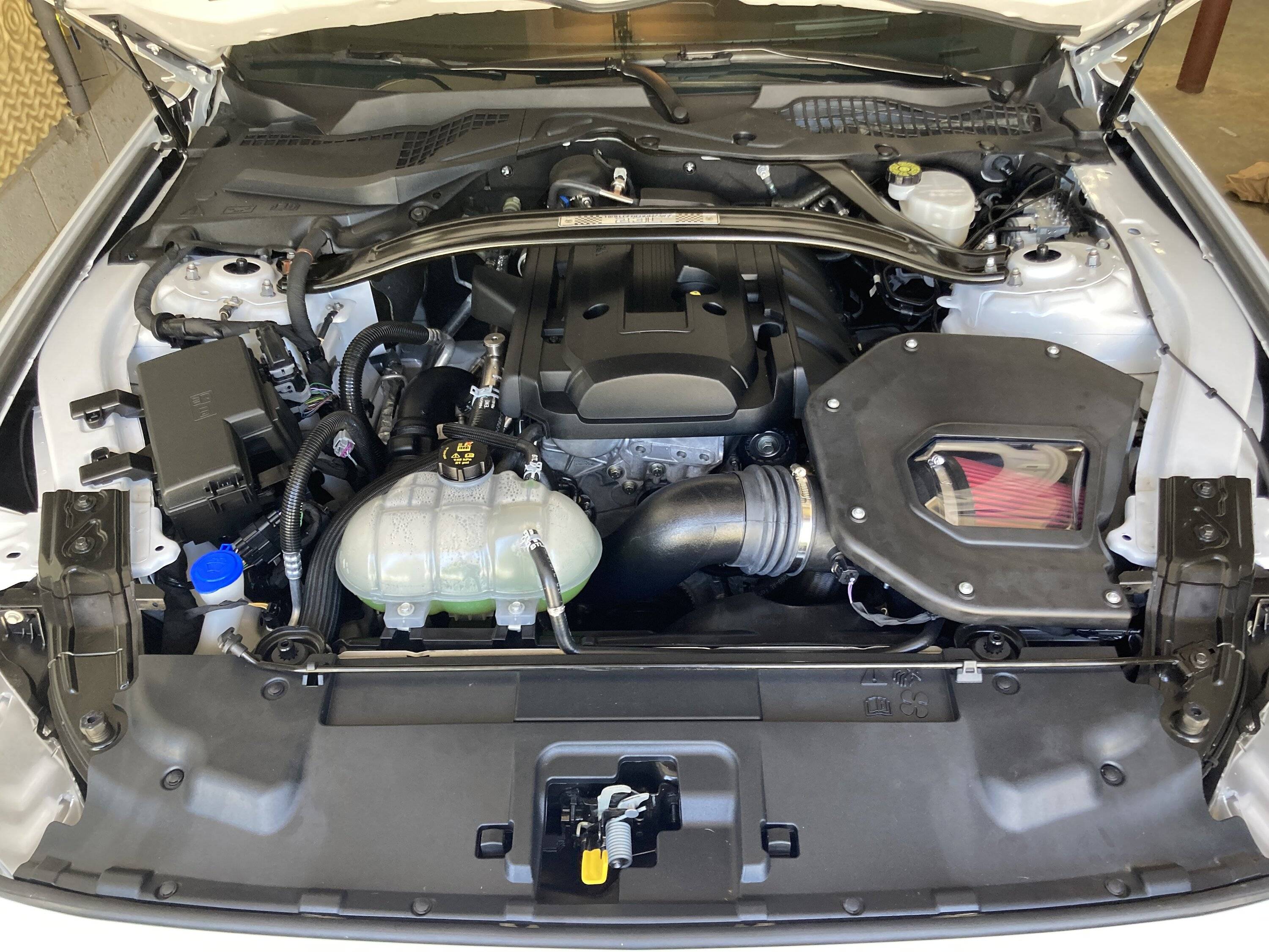

im working on a 2020 hpp, mod list Roush intake, steeda clutch spring , turbosmart bov (crazy loud).

Most guys will agree to skip the intake, and just install a high flow performance air filter. And before you consider any other modes, replace the OEM Intercooler with an aftermarket performance Intercooler.

I agree but this is my wife’s car. She picks parts I install em. I’m planing on doing a cvf street intercooler. And I’m working with steeda to get the correct Suspension. I’m not just gonna slap some springs on and call it a day. This car handles very well in curves to be stock. Put my gt to shame lol. The intake was mostly for looks and it was a very cheap market place find.
Don’t look bad for 80$
