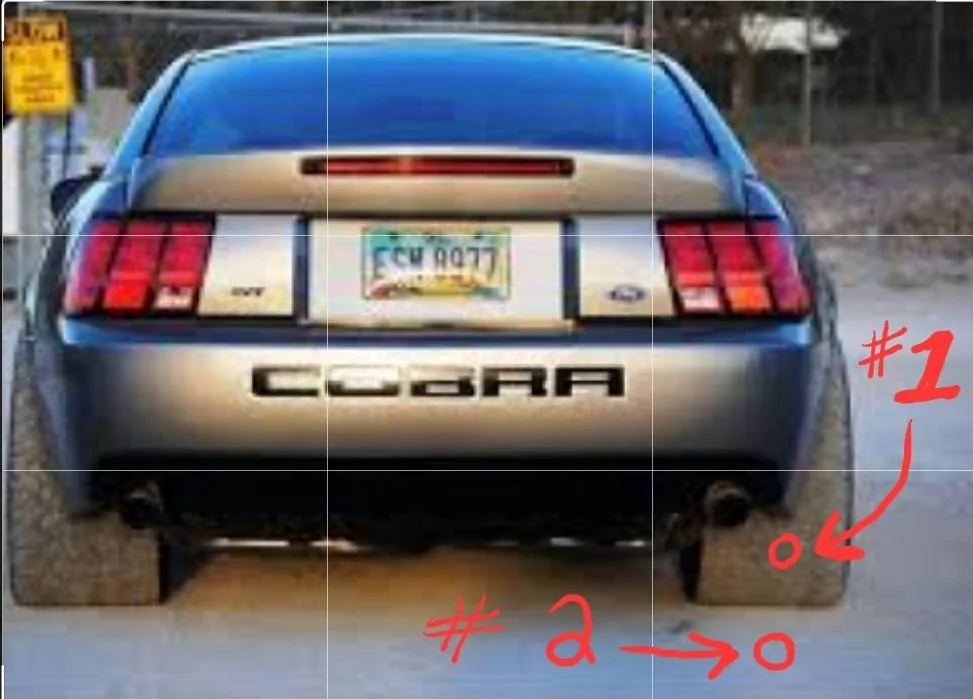

Your crew chief is going to measure both the tire surface & the track surface just behind it, (labeled #1 & #2 locations in pic)
after you have done the tire warming procedure (aka-burnout).
After you have stopped & are located in the spot your preparing to launch from, measure Temps. This can be in the area you did the burn out in, if you choose to bk up into your own tire tracks. You can use temp gun to see if your tires (on burnout) are actually changing the track surface in a measurable way, & for a measurable distance of surface, if your curious.
2 locations are marked below, & the crew chief will shoot the 2 spots very shortly before you launch the car. They are marked as 'o'

He points the laser guide & shoots temps, & remembers ea till he can record. (American drag racers work in F° Fahrenheit #'s, so any examples below, may require you to convert.
We are always being mindful of different tire brands/compounds, to develop the best range of temp disparity (Delta) between tire
(#1) &
track surface (#2).
This disparity in temps between #1 & #2,
are what's most often the "magic number" for a tire. Could be +5°, +10°, +20°, or more.
I don't recall a tire wanting to being colder than the track surface in racing, unless its a unique, & very hot day - situation. Usually the tire likes to be at least equal to the track temp, but often higher.
You will likely never develop an exact temp difference in a window of under 3°/°5 degrees F, between tire/track for most occasions. More like a range withina few degrees.
Start at getting your Tire surface at a difference (of both measured surfaces) between +05°F & +10°F hotter than the track surface.
Unless the track surface is a frying pan, due to extreme heat, like from Noon to 4pm, on hot sunny days in the USA. Should start at equal °F temps, & work upward.

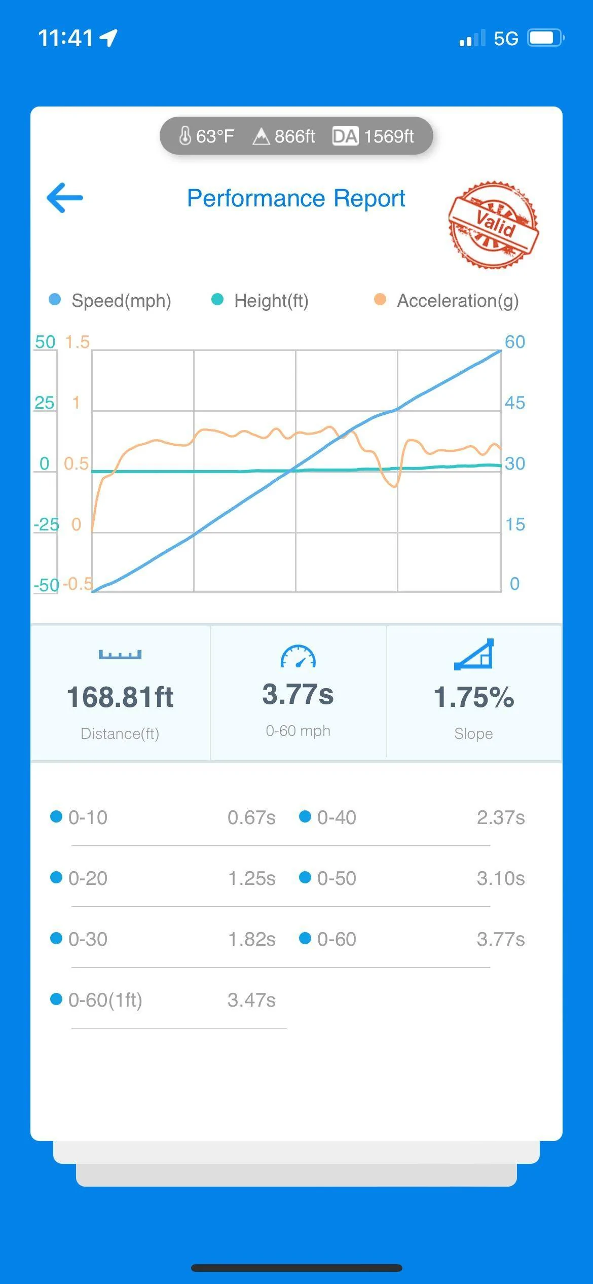

I live in upstate NY last summer i managed to get a 3.77 (3.47) with the rollout on a pretty shitty backroad. It takes some practice to get used to but is definately doable. I consistently get sub 4s easy now. I do have Mickey Thompson Street S/S on the rear though 305/35/19.
