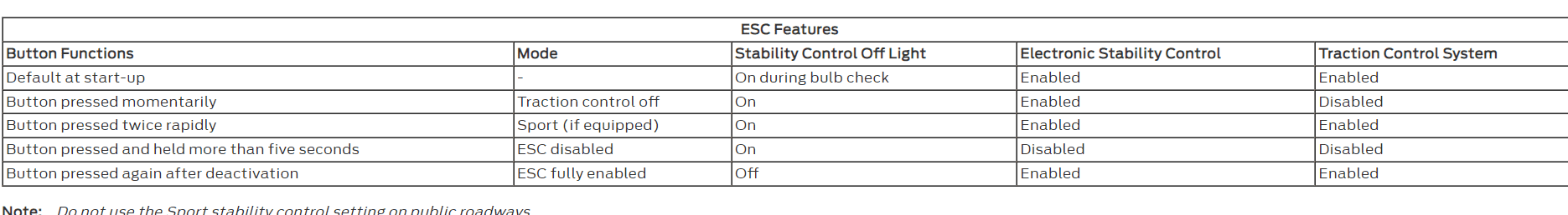

So then what "drag" and track modes are doing? I mean in those modes there is indicator on instrument panel showing that it is OFF...

It's not fully off, it's just desensitized to allow a bit more spinning before interfering. Drag mode is meant to achieve the best launch, and spinning your wheels is counterintuitive to that.

To turn off advanced trac, hold the traction control button up for 8 seconds until you see the adv trac off popup. Even with track mode, adv trac will still prevent things such as burnouts. Doing a burnout doesn't guaranty you won't still get left at the line.

So tested different modes of ESC-off, confirmed you need to disable it in order to burn the tires and driving mode seems to be not affecting it at all (not by the factor where you feel difference in how wheels are controlled on startup). Now usage of launch control started to make sense.
So for anyone struggling to start from stand still - you need to turn off ESC by holding corresponding button for 5+s, then the control of start is done by your foot.
