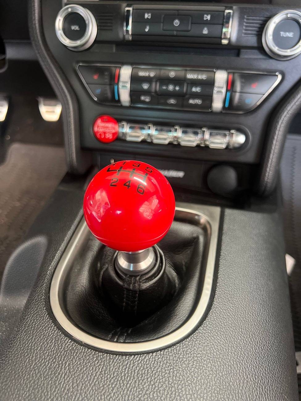

First thing I did was to swap out that crappy stock shifter. There was so much play in that thing that it starts wobbling from just looking at it. Went with the Steeda short throw and shifter base bushing bracket and there is no play in it at all. Installed the Steeda clutch spring back in December and wish I had done it sooner. Even with the new spring its not that bad to drive in heavy traffic.
The only noticeable NVH I have had was from the Steeda shift knob. I used a jam nut when I put it on and I think that was what was causing it. I ended up putting the factory one back on and that solved the issue. I may reinstall the Steeda one and just use loctite this time without the jam nut.

Did you use the OEM reverse lock-out collar? I did when I installed their race shifter, and that's what buzzes on mine. I did use loctite on the Steeda knob. I have the Steeda collar now for whenever I feel like taking it apart again.

I still have the factory one. I have a Steeda collar, just never installed it. If I still get some rattling after I install it without the nut I may do the collar then.
