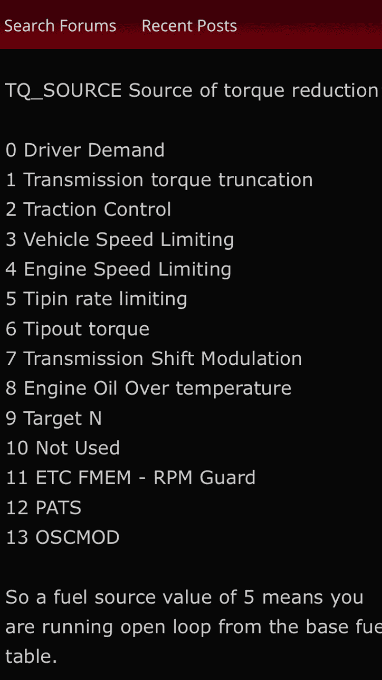

View TQ Source in your log.
Thanks for responding Cory.
I've had a look but I really don't understand what TQ Source means or pattern I'm looking for.
Over the whole datalog my max tq source is 22, min is 0 and average of 3.29.

Look for a single number anywhere in the RPM range. Not min/max. These are possible torque limiting notifications/actions.
So I've had a look. Over the area where i was able to log the issue i have tq source numbers of 9, 5, 6, 16.
No idea what that means.

This is a WAG, but you are getting tip in and tip out torque reduction. Probably too much spark advance.
