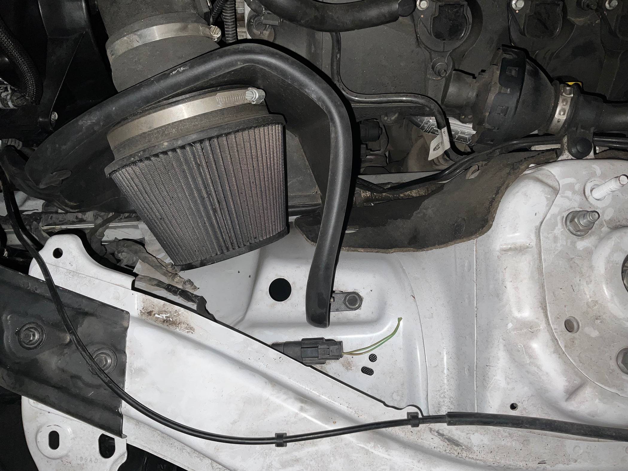

Car kinda feels like it’s in limp mode. It’s Holding first and second for a long time and acceleration is slow and not smooth. no engine codes. just changed the trans fluid and filter still no change. noticed this wire on the driver side is cut not sure what it is tho.

The connector pictured lets you fully disable traction control and abs. Useful for when you are racing or want to dyno the car. People often call it the "dyno plug"
I think its just a connector that doesn't go anywhere and just passes voltage back down the wire so if you unplug it then it is disconnected. I don't think the other end goes anywhere. Do you have a bunch of traction control and abs lights? If not then don't worry about it.

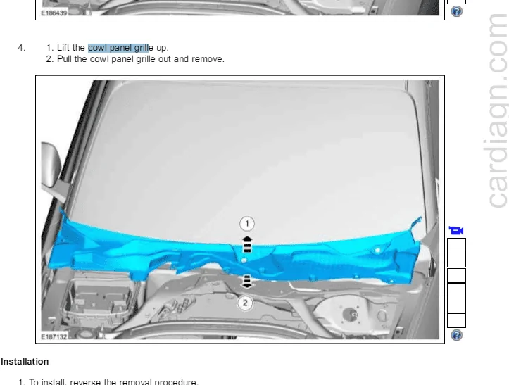

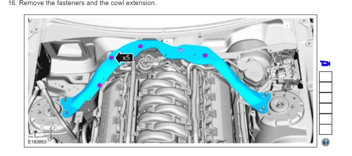

As far as the transmission can you give us some more info. How many miles? What mods done to the car? Tuned? Also did you buy the car in its current state or have you done modifications to it yourself? Looks like you are missing the engine cross support / cowl extension (see photo below).

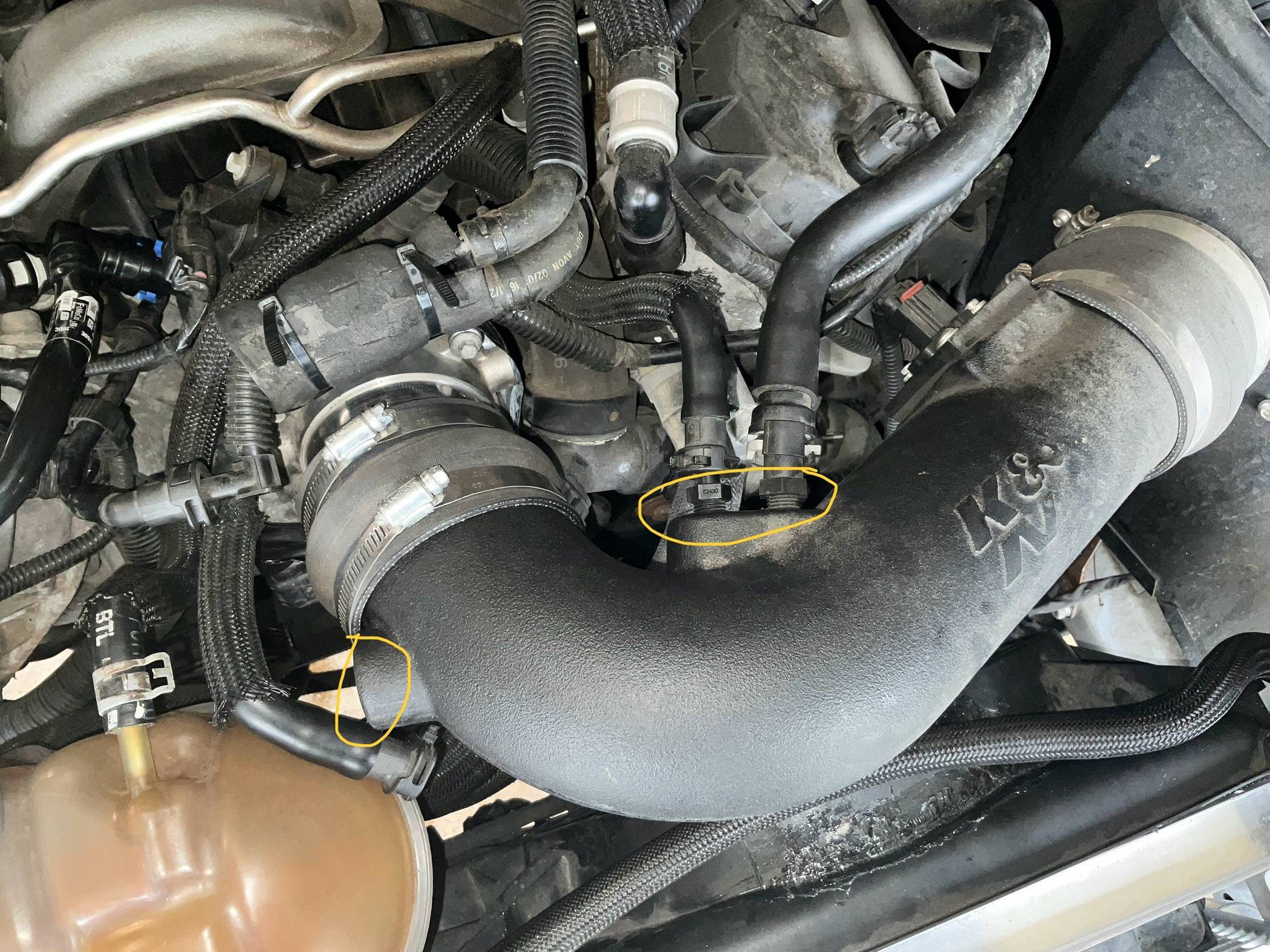

Did you fix your intake fittings and are sure there are no leaks?

The photo I attached is of a stock bar that every mustang should have (at least as far as I know). Check to see if you have it. I think it provides some chassis rigidity. It goes under the cowl panel grill (see cowl panel photo below).

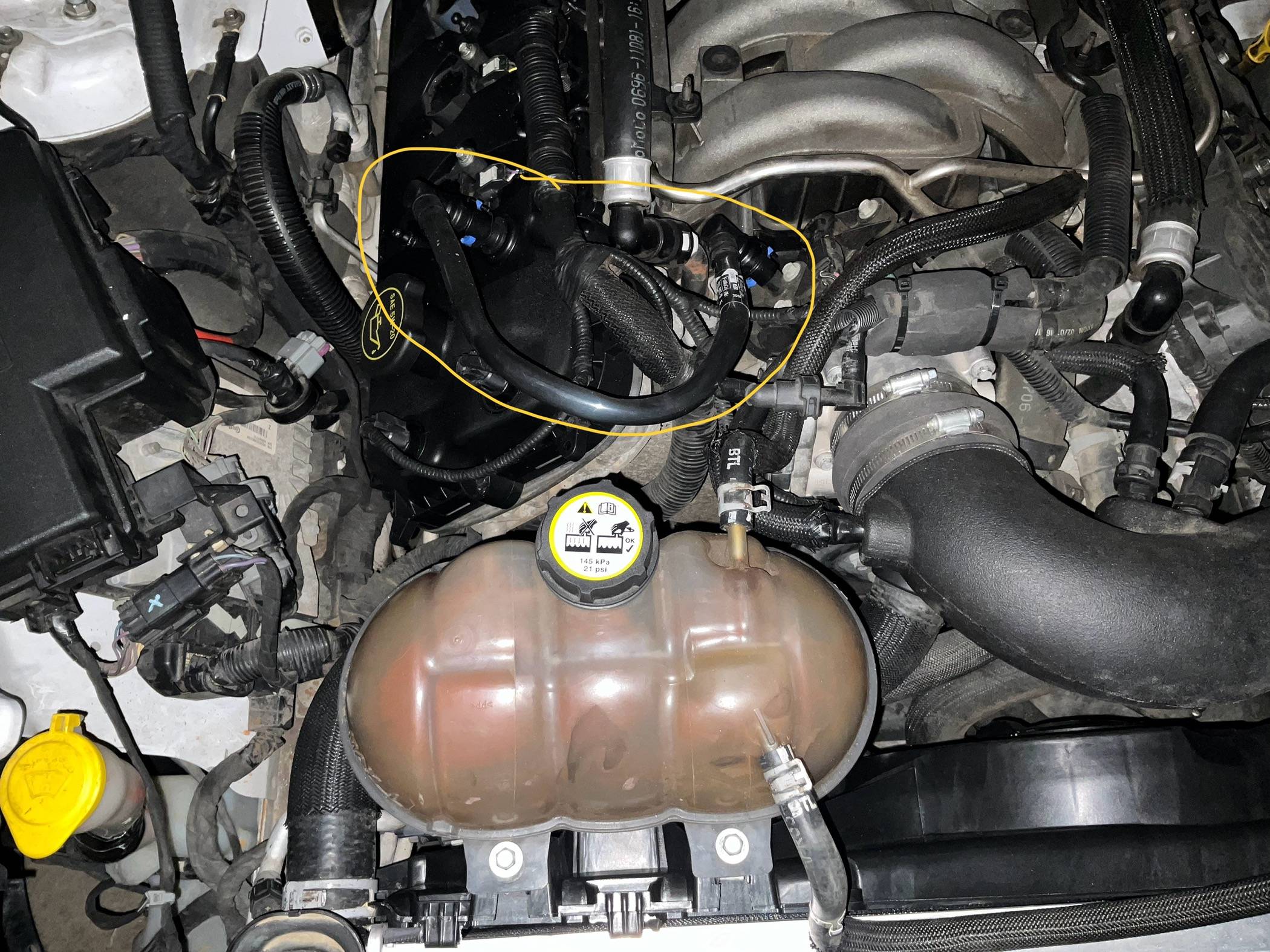

Yes i replaced the one on the left. The other two were fine. I also don’t feel any air coming from any of them. The Pcv valve hose was missing when I got the car. I’m guessing it had a catch can and the repair shop took it.
Yes I have that part I thought you were talking about the strut tower brace. do you know if the eco boost air intake is the same as the 5.0

I am talking about the big metal piece I sent in the first photo that goes under that plastic piece. Every mustang has it.

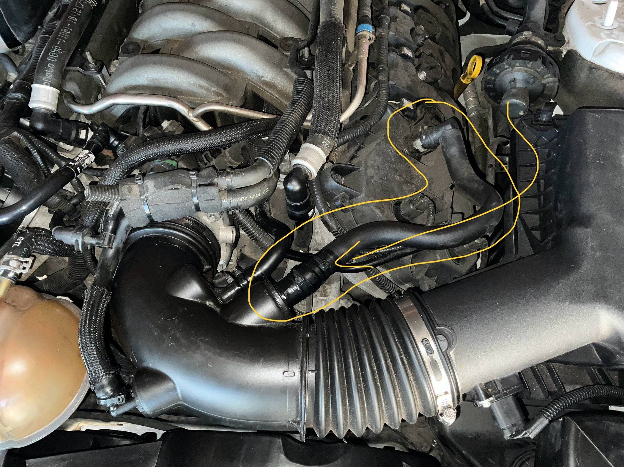

bought a oem airbox. is this Pcv hose suppose to go here? previous owner capped off sound tube which I think goes there but they had this hose going to the airbox and I don’t see anywhere else the Pcv hose can go.
