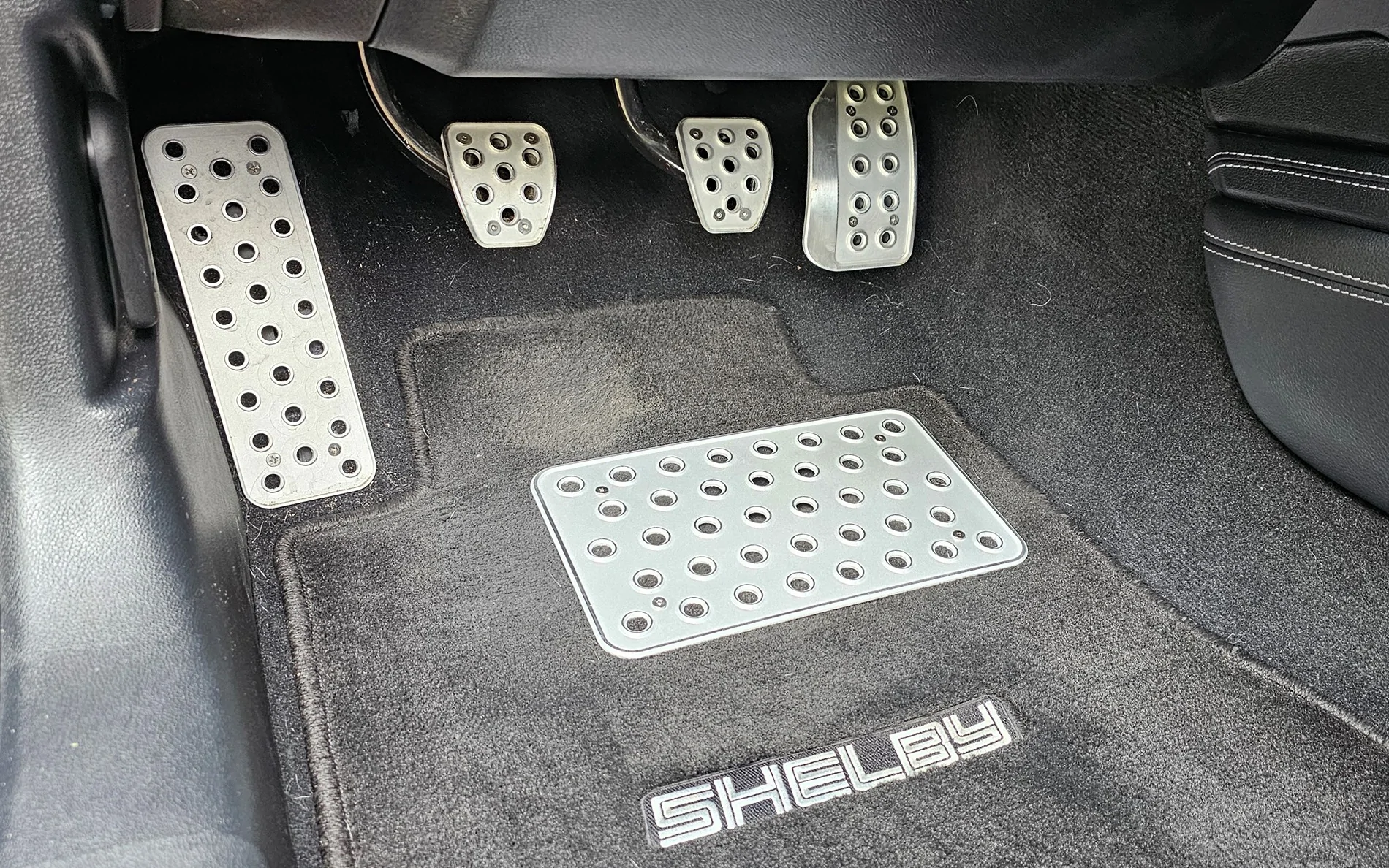

Ok let's make something very clear. I'm not a track guru or race car driver. When I've been on the track I'm in the slowest group, just not the slowest one.
If you really want to learn l suggest you spend some time at the track with a good instructor.
In my GT350 the pedals are a pain. I really have to turn my leg to be able to heel-toe. The brake pedal seem really high up to the gas pedal. In my BMW my pedals are right next to each other and it easy.
Remember the main point of heel-toe is to BRAKE and make the corner. When I was taught and practicing heel-toe I was told to get the car up to 80 mph then brake heel-toe. On the race track I found it easy to do. When in the triple digits speed I found I am pressing the pedal down hard and the gas pedal is right there. On the track heel-toe seems more like muscle memory to me. I am thinking more about where to brake and finding my marks.
I live in a rural area and there are back roads with little traffic and some fun corners to play on. I found my self struggling sometime when practicing heel-toe. What I observed was I wasn't going fast enough to push the brake pedal down far enough and really had to reach for the gas pedal.
Anyways take this with a grain of salt. Just my observation and what works for me. Find a real expert to help you.
