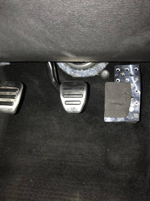

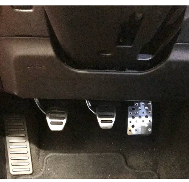

Yeah, 'heel-and-toe' is supposed to be a track 'tool', where you have the brake pedal close to the accelerator. If you raise any of the pedals, you'd completely alter how to drive the car; no way I'd even consider that. And when at the track, you wouldn't be able to do it where it matters the most. If you want to do it with light braking, just buy aluminum pedals with a heel-toe extension on the gas pedal (somebody else mentioned that already); it's much easier that way. Finally, in order to get the hang of it, stick to one drive mode, since each one (annoyingly) has a different throttle map. The more aggressive the map, the less you have to depress the gas pedal for the same blip, so it helps to get the most aggressive mapping you feel comfortable with. And as you said, keep practicing when no braking is needed, to get them just right. Then you can start with the brakes. Finally, you can always turn on rev-matching, and just do it a hair earlier than the computer. And if you can't, for some reason, then the 'nanny' would do it for you. Ha ha.
I looked into that, but they all seem to require drilling into the factory pedals which I don't want to do. Since I don't (and won't) be tracking my car, the spacer option seems to be the way to go for the street. Everyone who has done it has raved over it for street / canyon usage.

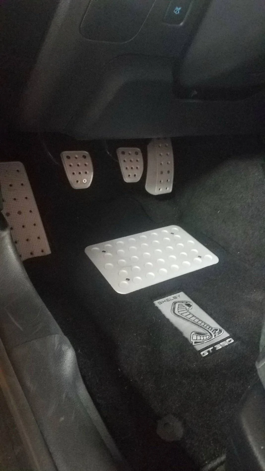

I have the solution on my GT350R; When you are at the track pedal your brake pedal will naturally go lower with heated breaks and the height of the pedals Will be close enough for heel and toe, but the gas pedal is sooo far to the right ; Steeda has a drill on wide pedal for 33$; but on the street with cooler brakes, the brake pedal is too high for the gas pedal so I add a hard foam rubber pad put on with the right stuff and it is removable when you go to the track by pulling it off.

With a 10mm socket you can adjust the height with some cheap plastic spacers from Home Depot. I've also paired that with a set of SRP racing pedals and their heel plate. Works great in my car.
