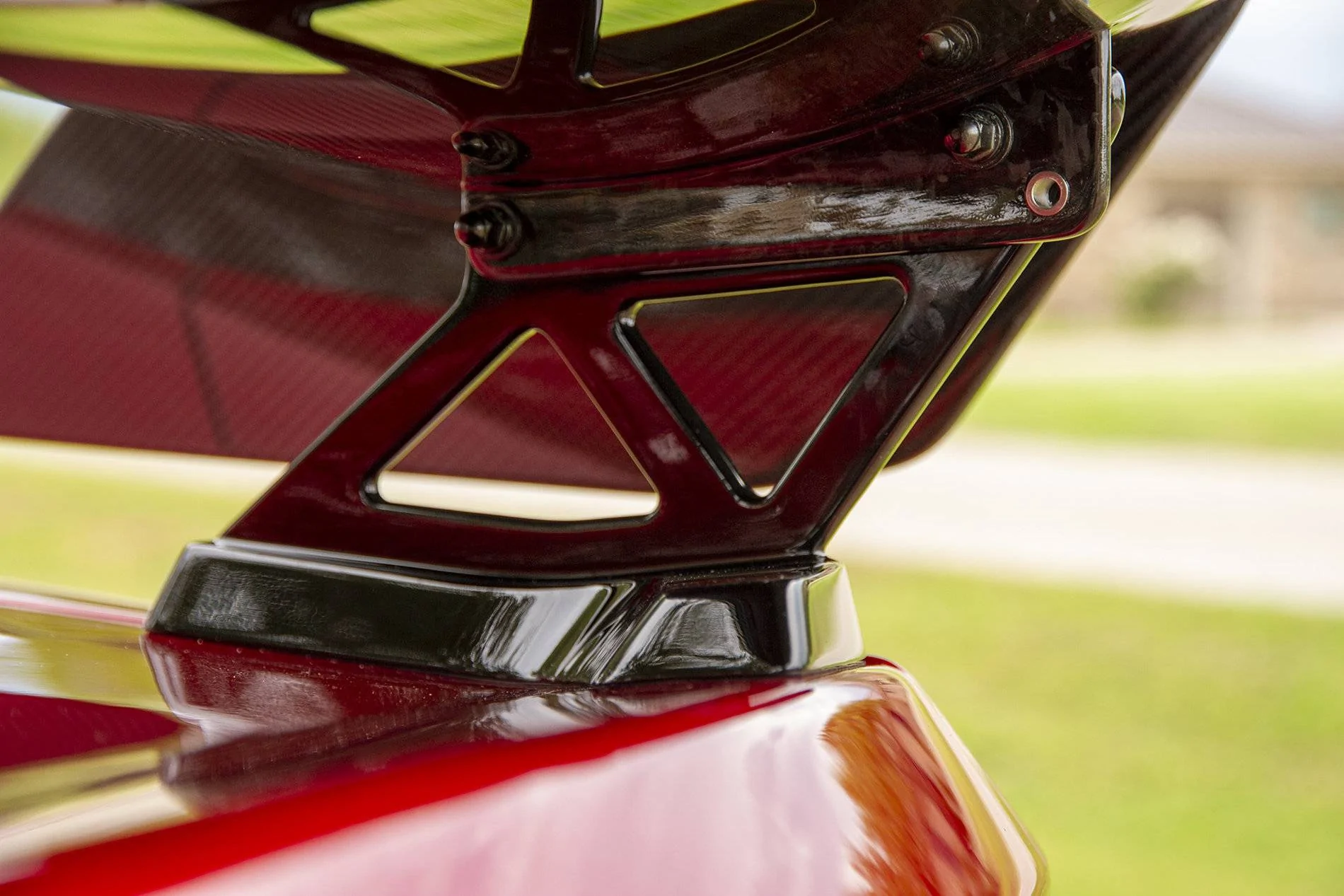

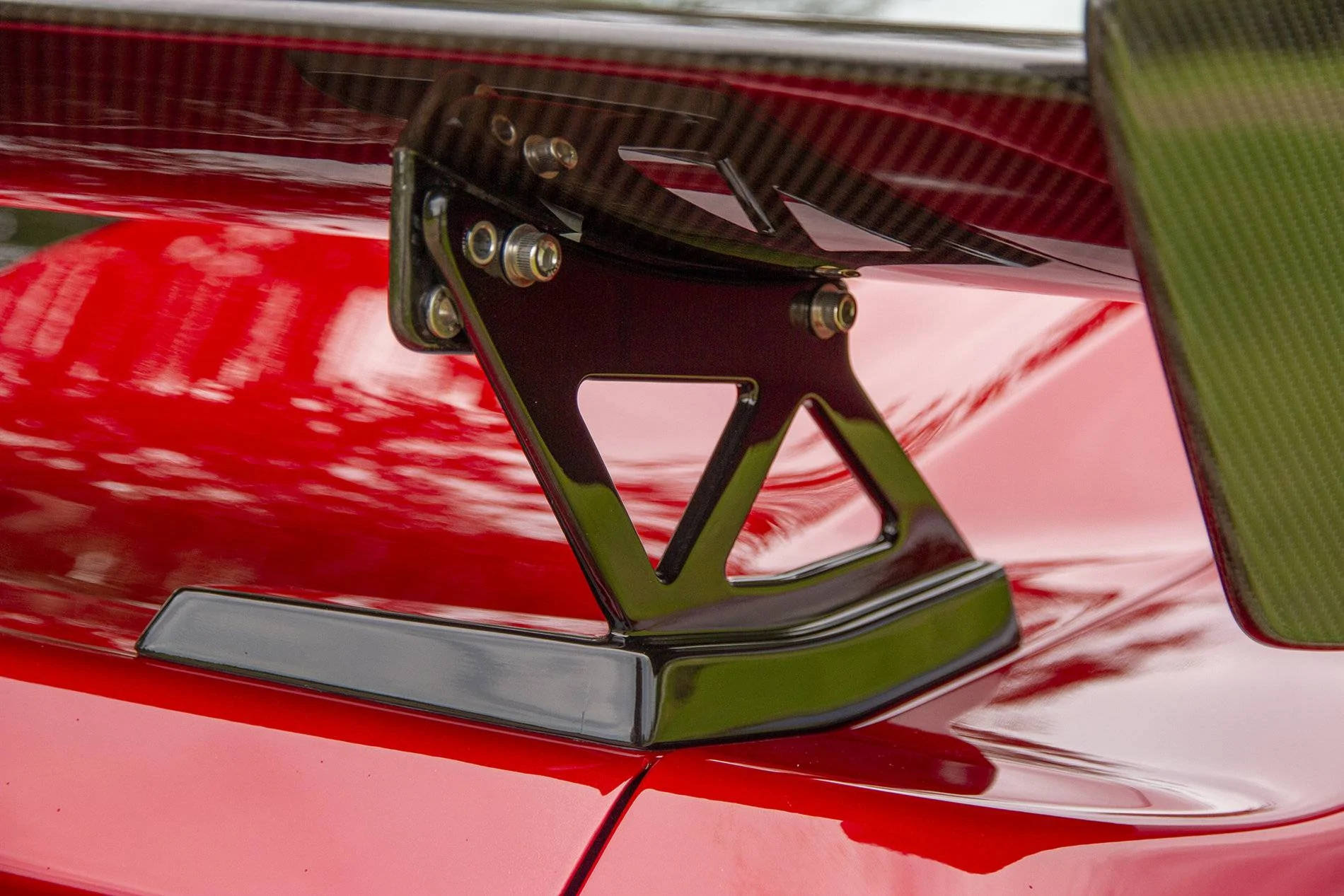

Wow. I am the latest victim of the crap deck lid work. My (dealership) body shop removed the wing and holy crap.....
They are finding all kinds of problems with the paint/body. Panel misalignments, paint chips associated with assembly, clear coat defects.
If you have a CFTP, you might want to have a look.
I mean WTF Ford....... You all should be ashamed of yourselves.

GattmanLa & Tomster,
Just looking for confirmation on the wing for another thread (CFTP MPR) the bracket is made out of carbon fiber and painted black? Or is it metal? Looking at GattmanLa's picture this looks like carbon fiber if its off a 2020 GT500. I was under the impression it was metal brackets. can either of you confirm for sure?
And can either of you take full pics of one of the brackets, I see the underside but I want to see it upright if at all possible, most videos fly by too quick to pause and tou guys have it apart already :)

AoD: I don't know if these will help, but here are a couple shots of the bracket.
Thanks KB, actually it does help, the shots you took does look like they are painted CF brackets and not metal as suspected.

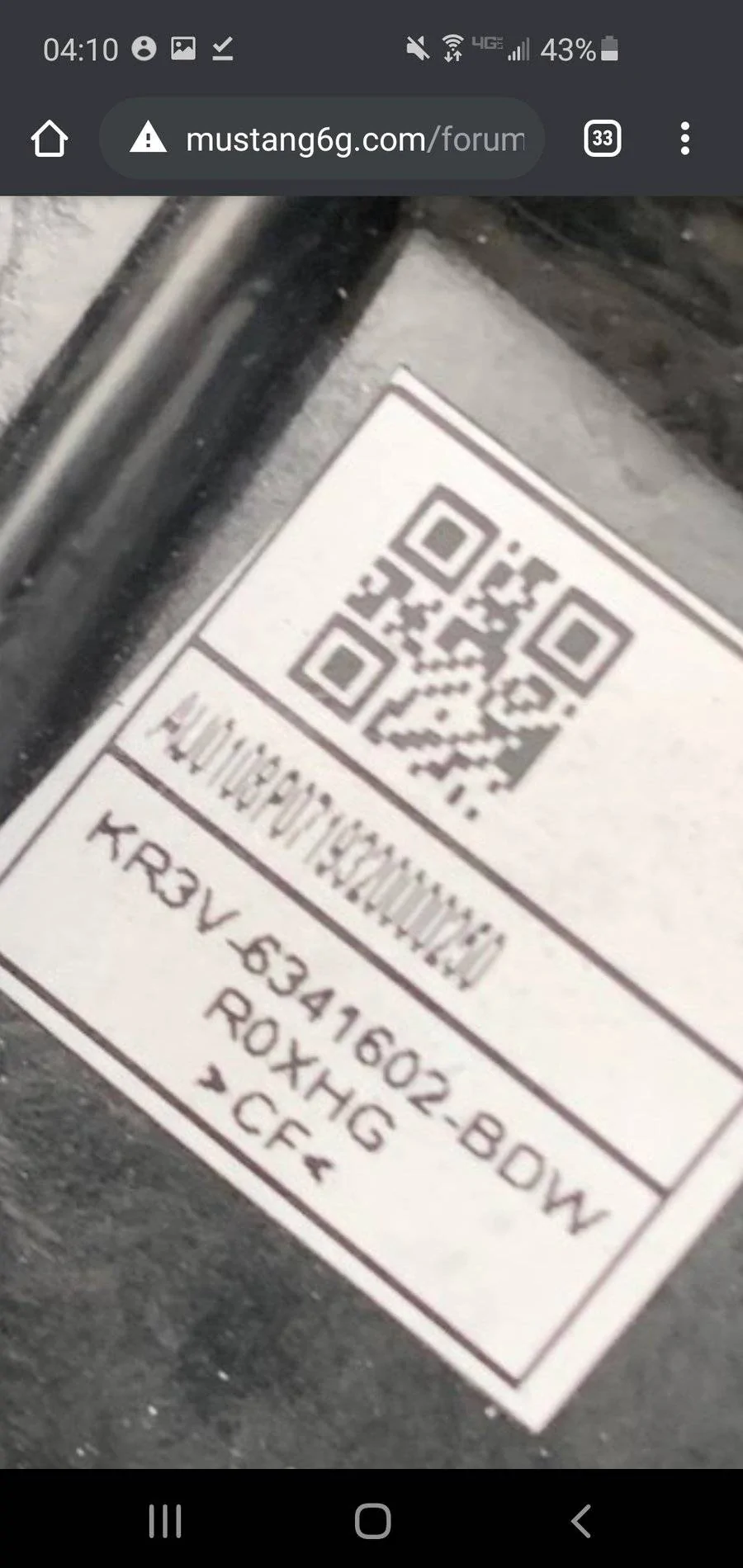

AoD: A magnet won't stick and tapping the bracket sure SOUNDS like it's CF. Glad the photos helped.
Somebody is up early again.......
Cast aluminum maybe? I'm not saying with any certainty, because i haven't laid my hands on them.

Good eye, Tom and I'd bet on it.
