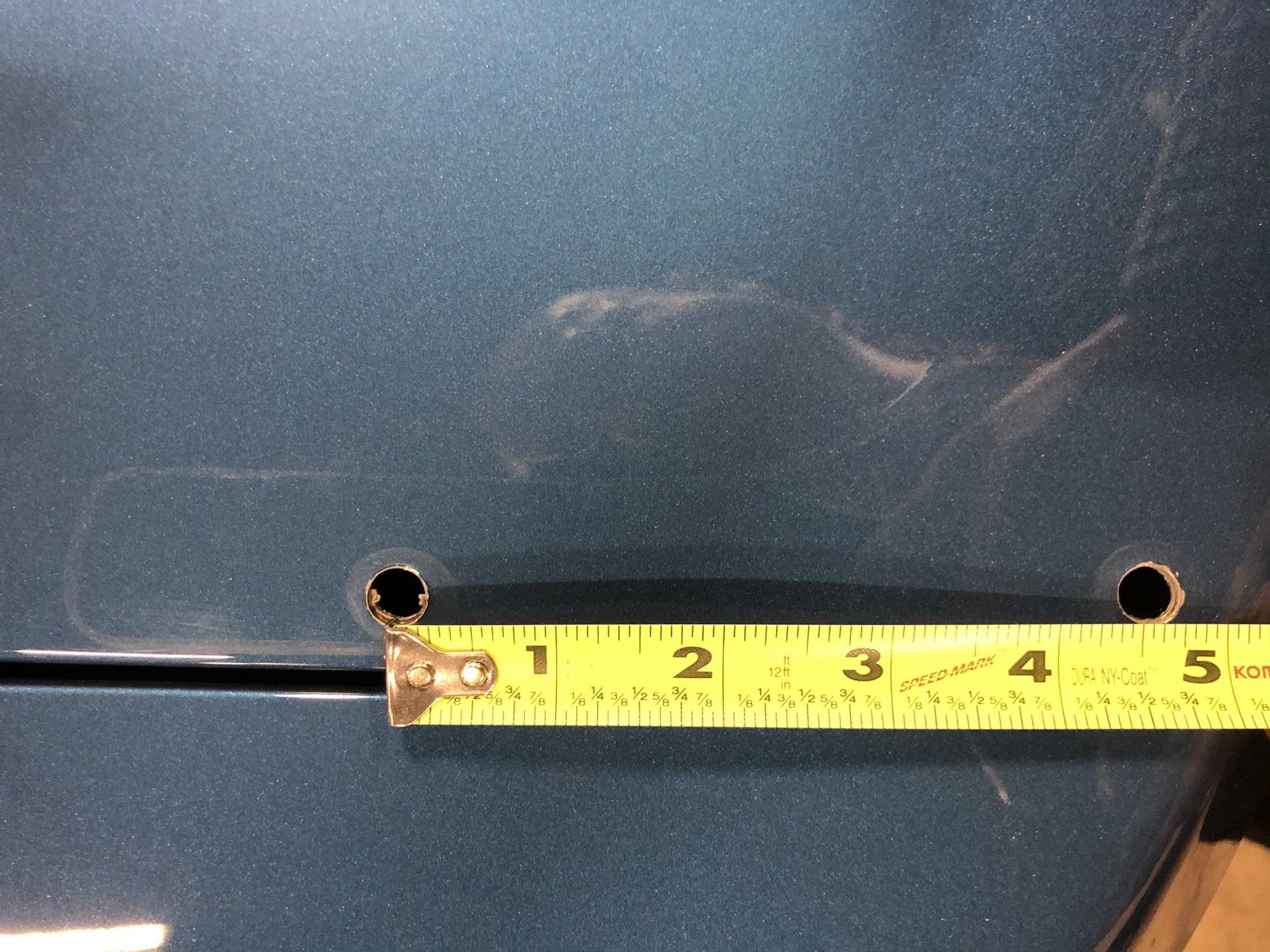

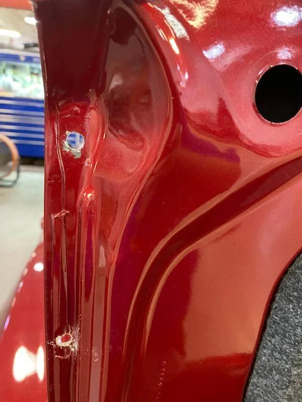

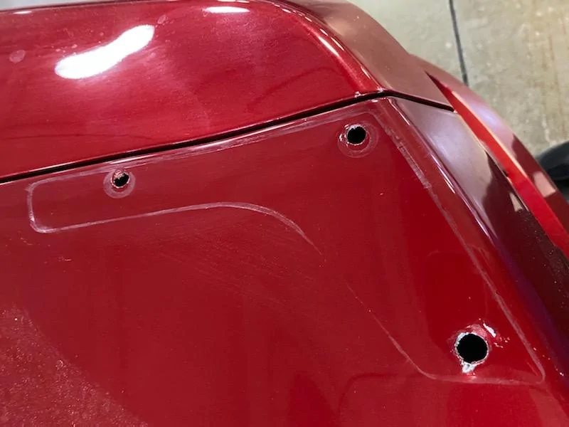

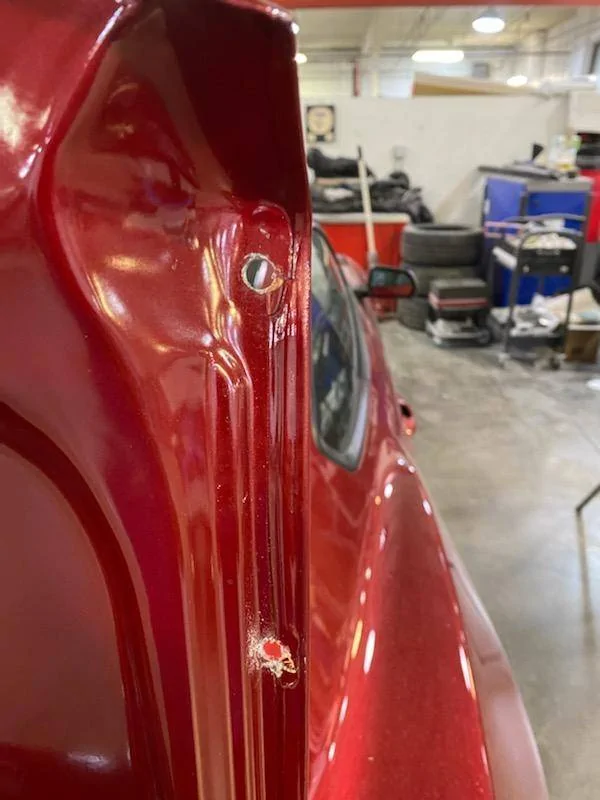

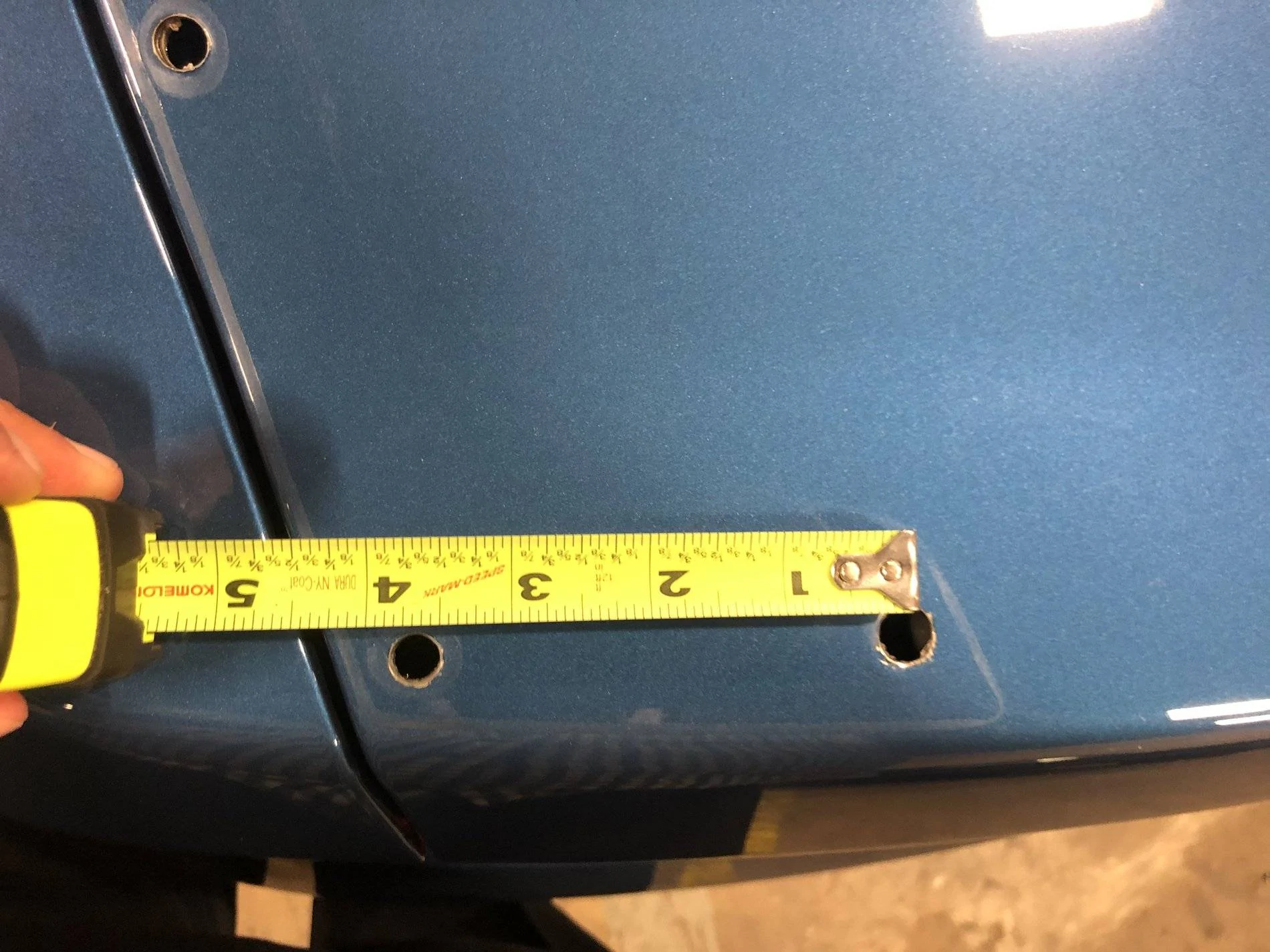

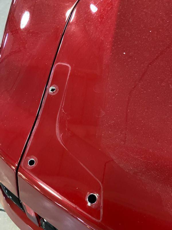

Wow. I am the latest victim of the crap deck lid work. My (dealership) body shop removed the wing and holy crap.....
They are finding all kinds of problems with the paint/body. Panel misalignments, paint chips associated with assembly, clear coat defects.
If you have a CFTP, you might want to have a look.
I mean WTF Ford....... You all should be ashamed of yourselves.

That is absolutely atrocious "workmanship".

I would not use a full body gasket and would stick with the o-ring design. That said, Ford's methodology in drilling the decklid post-paint is a failure. The execution is shoddy at best. CFTP/R models should have their own decklid with holes drilled prior to paint.
Ford, get your shit together.

I couldn't imagine painting it and then drilling it and laid out how I did it a couple times now. The fact that Ford does it this way is unacceptable and am happy to see this be exposed. Jim Owens, if you actually ever see any of this, it is time to pick up the phone and do the right thing. Dip into that margin and start doing this the proper way.

Wow, i mean even done post paint, It could have been done to a much higher standard. I mean drilling or stamping before paint is the correct way but still you can do this after the paint and make it look 100x better. Template the holes, fresh clean bit and hole, deburr/chamfer, paint or rust proof, maybe even a rubber grommet in the hole, plus a pad base under the wing mounts.....
