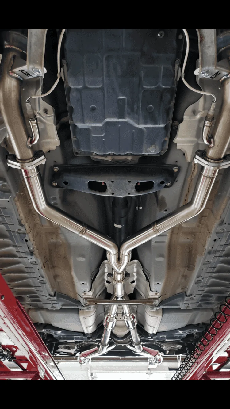

Y-Pipe done up proper with merger collectors in and out.
I don’t make this stuff up.
Looks a bit like the Magnaflow Y-Pipe muffler that yielded a faster 1/4 mile.

That is pathetic, the perfect example of the good deal.
A reason I look at a supplier like Roush for these kind of parts. One has a much better chance of getting what they pay for.
