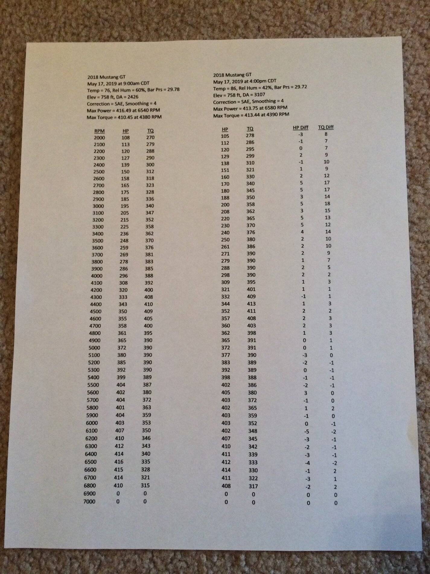

This was a stock ‘18 M6 pull before and after Steeda H-pipe install. You can definitely see the torque increases down low. I do believe the after install pulls were also down a little due to the higher DA and the fact that the car was more heat soaked than It was for the morning pulls.
And this is right where a Coyote needs the extra torque.
