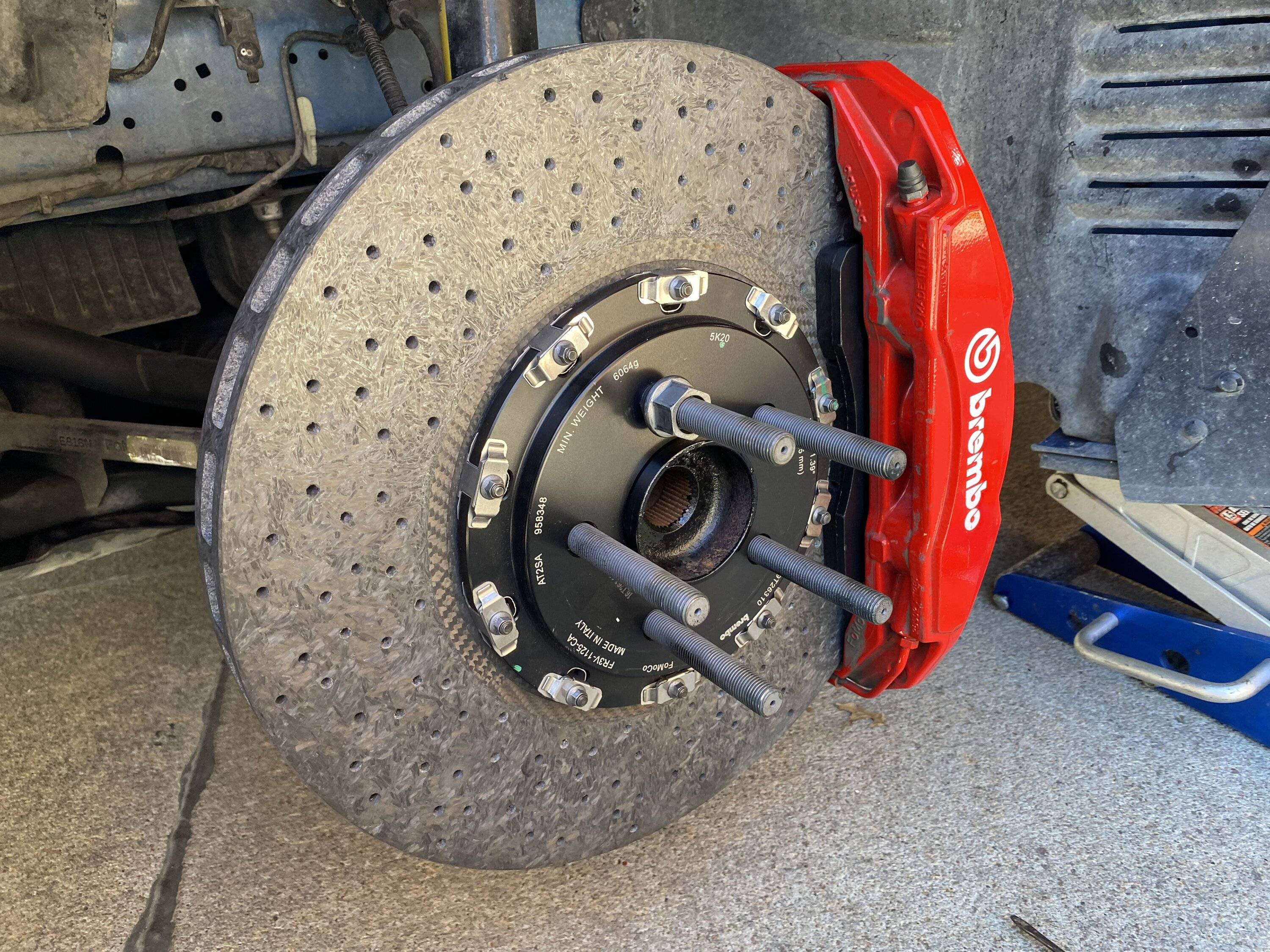

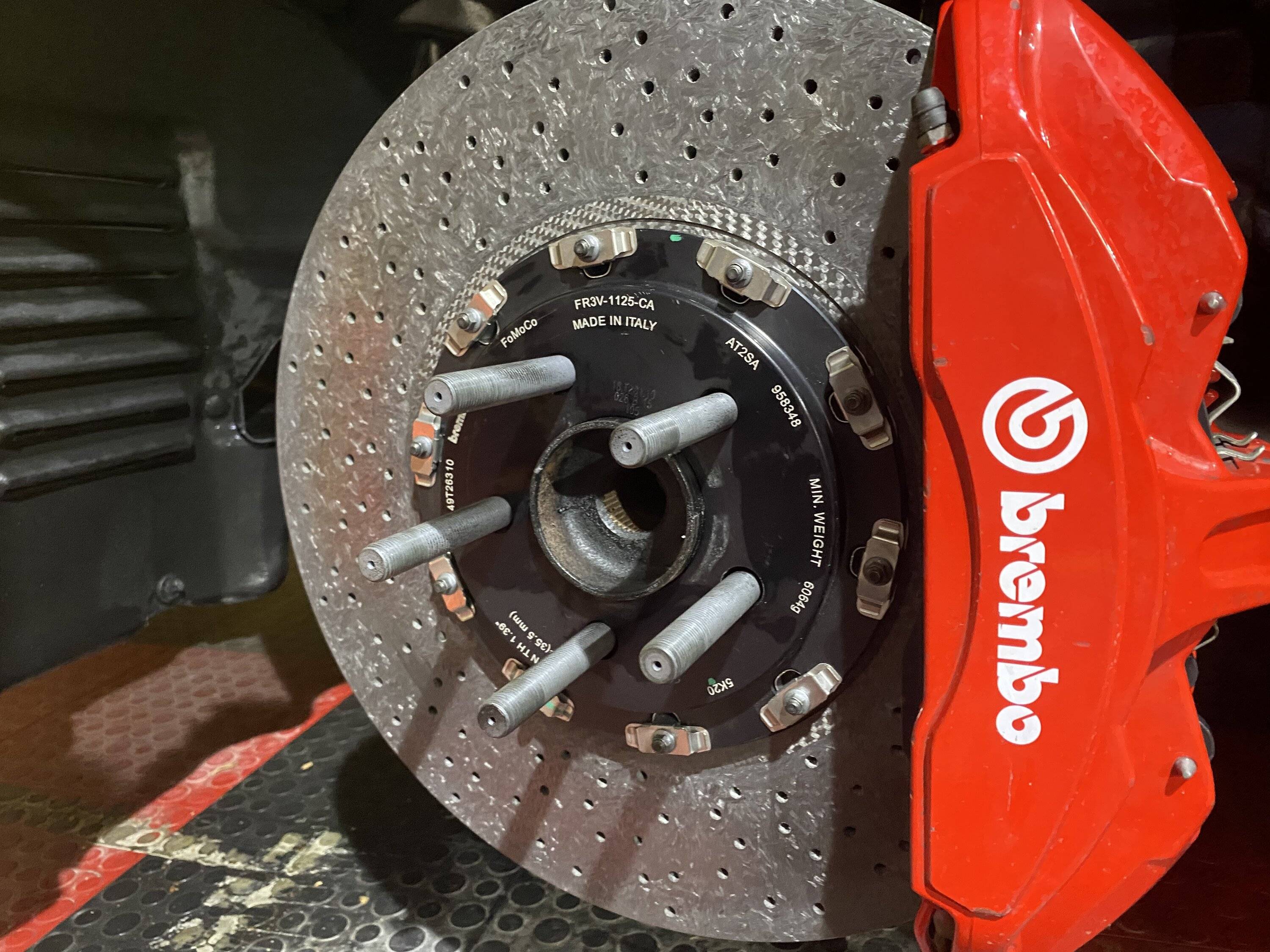

2020 GT500 & 2017 GT350R brakes and pads side by side.
29lb rotor vs a 42lb rotor.

I just assembled these front rotors with my son this afternoon, will be on the car with the signature SV502 wheels this spring. 50 pounds off the front rotating mass, 20 off the rear. Adding lightness. (a grand less than the racing brake version.)

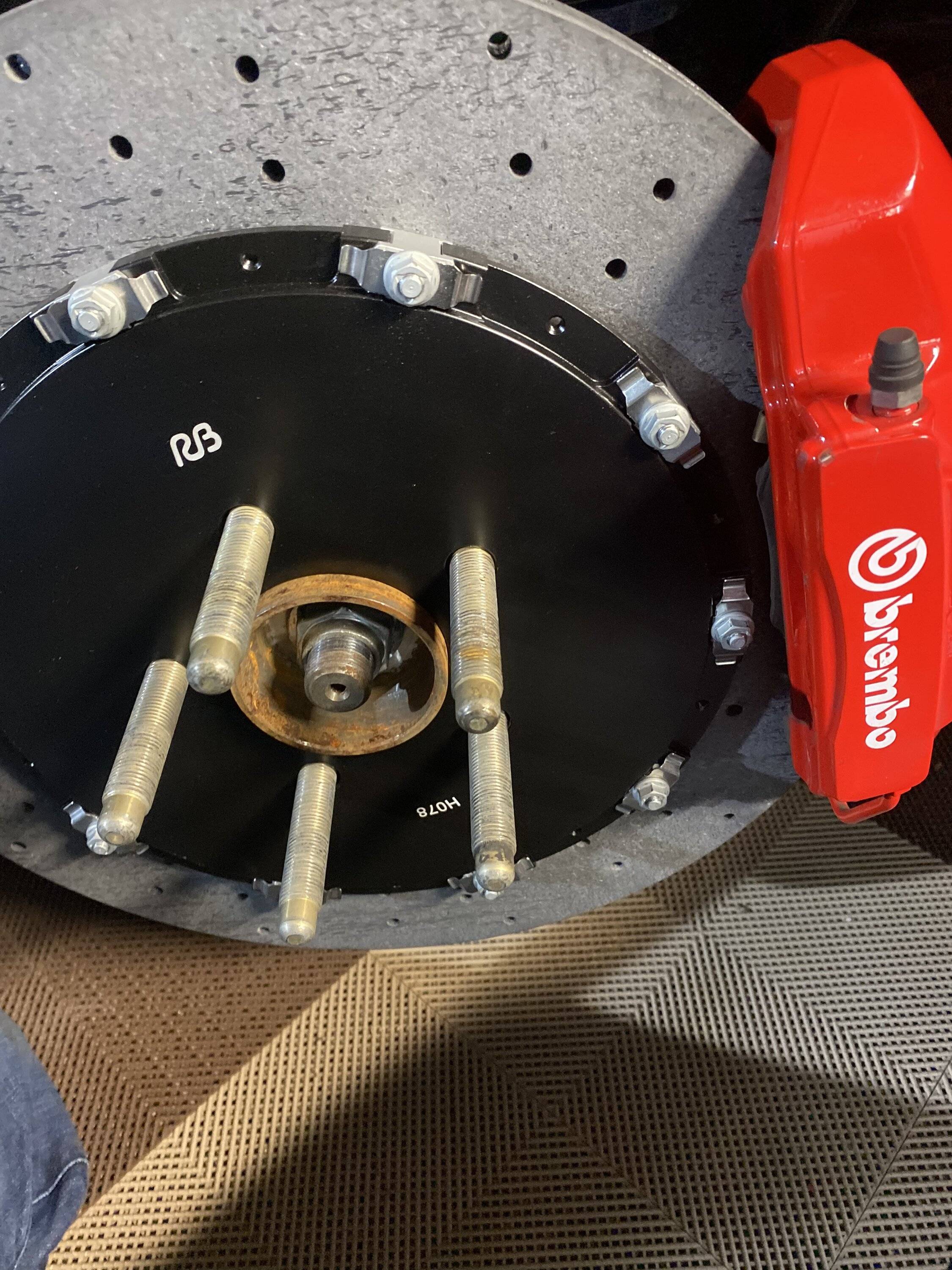

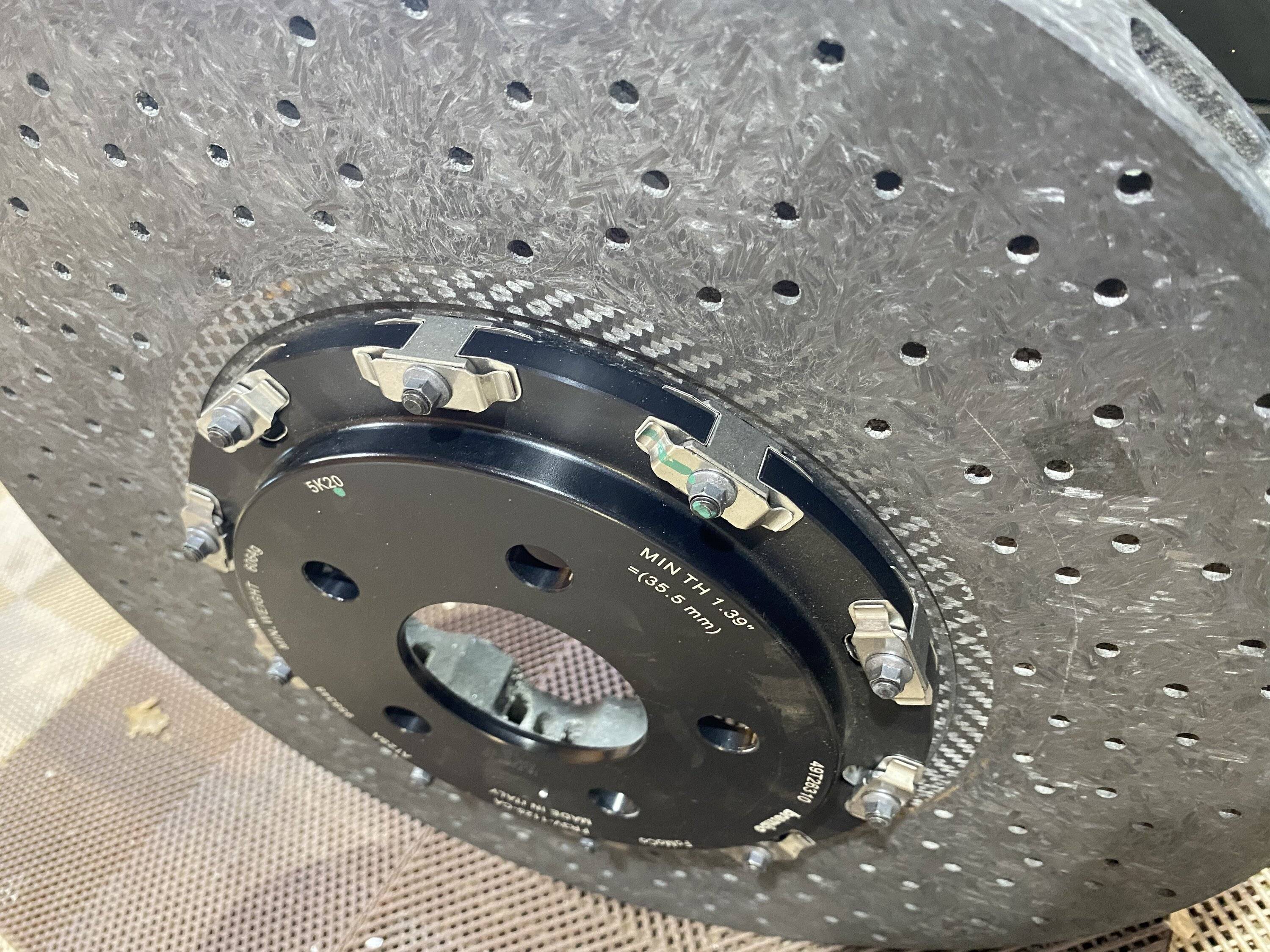

Funny you should mention that. I contacted RB (who made my GT350 kit) and checked to see what they have. Turns out they have 420x40 front and 370x30 rear rotor kits for the Audi RS7.
Front assembled rotors weigh 19 pounds, rear are 11.2 pounds. All four rotors come in just over 60 pounds, compared to the GT500 set somewhere around 110 to 120 pounds (fronts are 42# each and I'm guessing the rear rotors are 15 to 20 pounds each).
So, if anyone is waiting on a GT500 (@Tomster?) and wants to lighten up the unsprung mass, a call to RB might prompt them to make GT500 hats for the rotors they already have. 60 pounds off should make some kind of a difference...

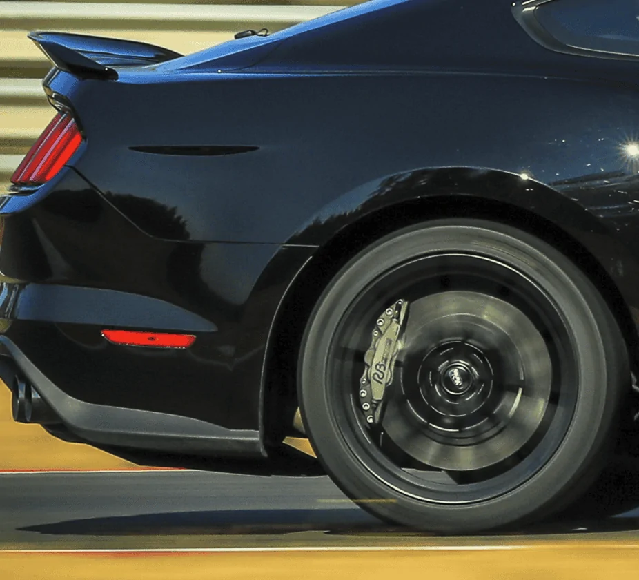

I might have missed it but will the GT500 rear calipers fit on GT350R - I have carbon ceramics on 4 corners and feel I need a little more rear clamping pressure on 1/2 mile shootouts
JAJ
Apr 9, 2016
2,233
1,988
Vancouver BC
2016 GT350 Track Pack

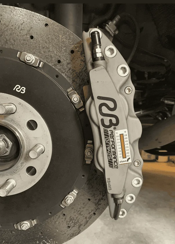

I have the CCM's on my GT350 as well, and I went a track season with the factory rear calipers and concluded that I wanted more thermal capacity at the rear, so I installed these:
The RB4M3 takes an "F40" pad shape, which is much bigger in every dimension than the OEM Brembo pads.
Here's the in-service picture from a track day in August this year:
